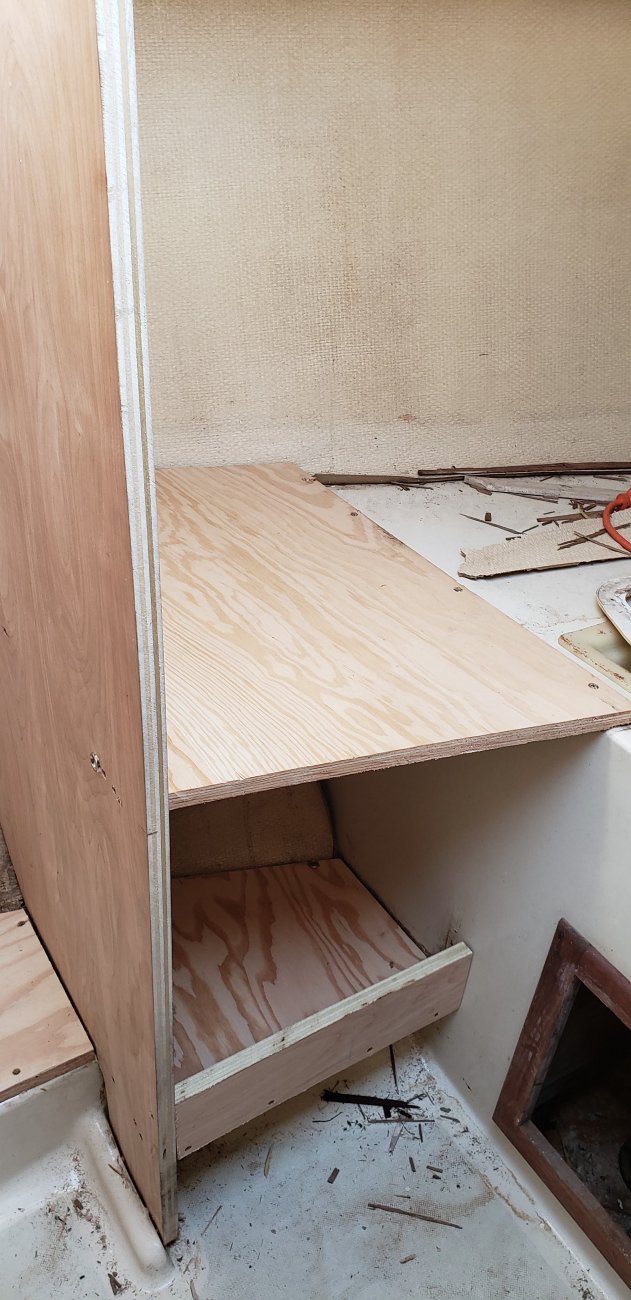

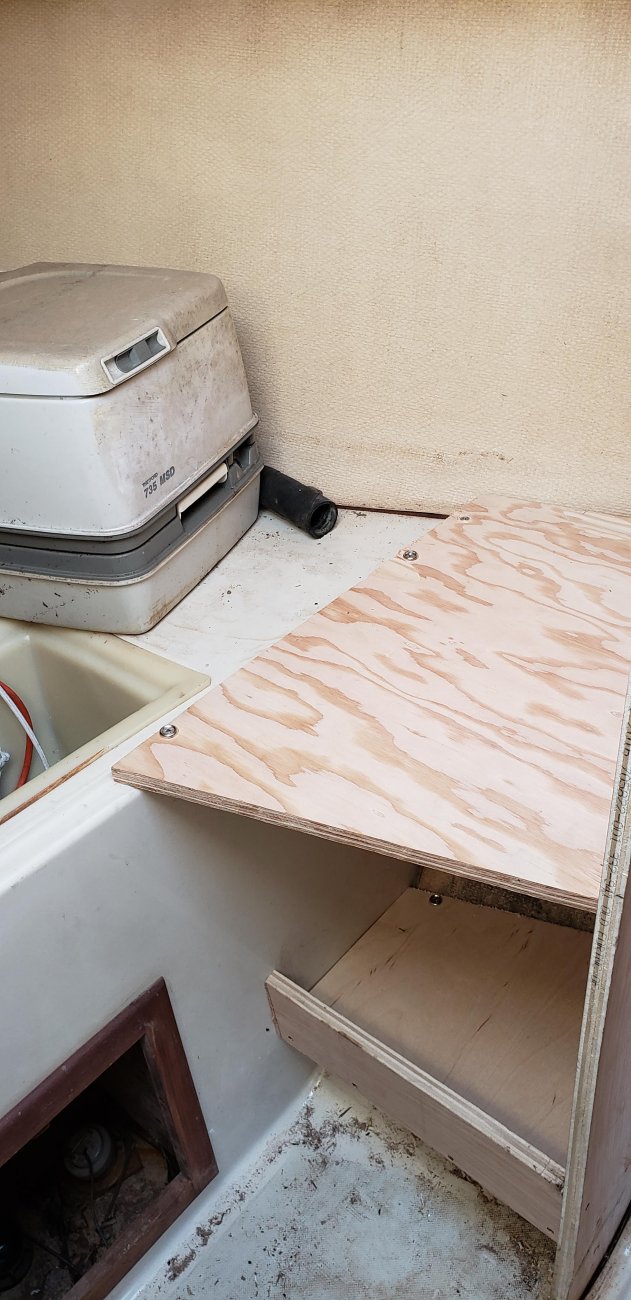

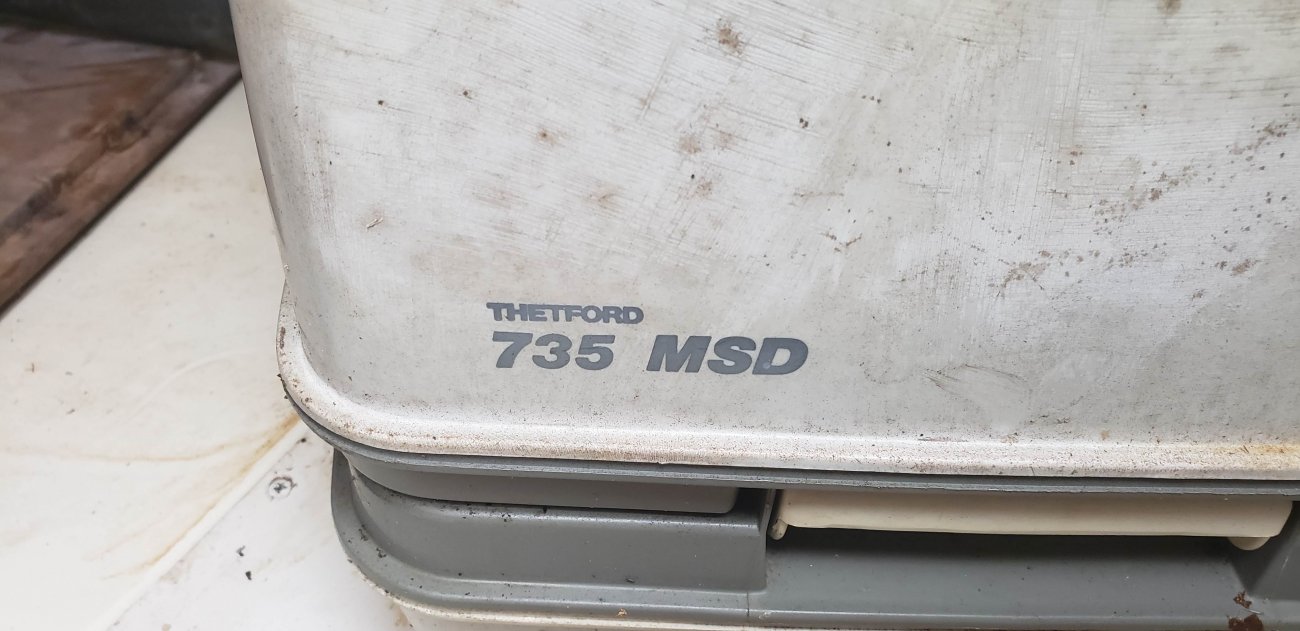

After some cleaning she is coming along nicely. Tomorrow is de-stepping and bulkhead day. Found a lumber yard in Richmond va that had everything I needed for the repair. got all the epoxy I need at least for now, went with the west system product. Found a beautiful piece of white oak for the compression post. Pics and video of tomorrow to follow. This is the head that is in the boat it seems to be in good working order. Any thoughts on this model.

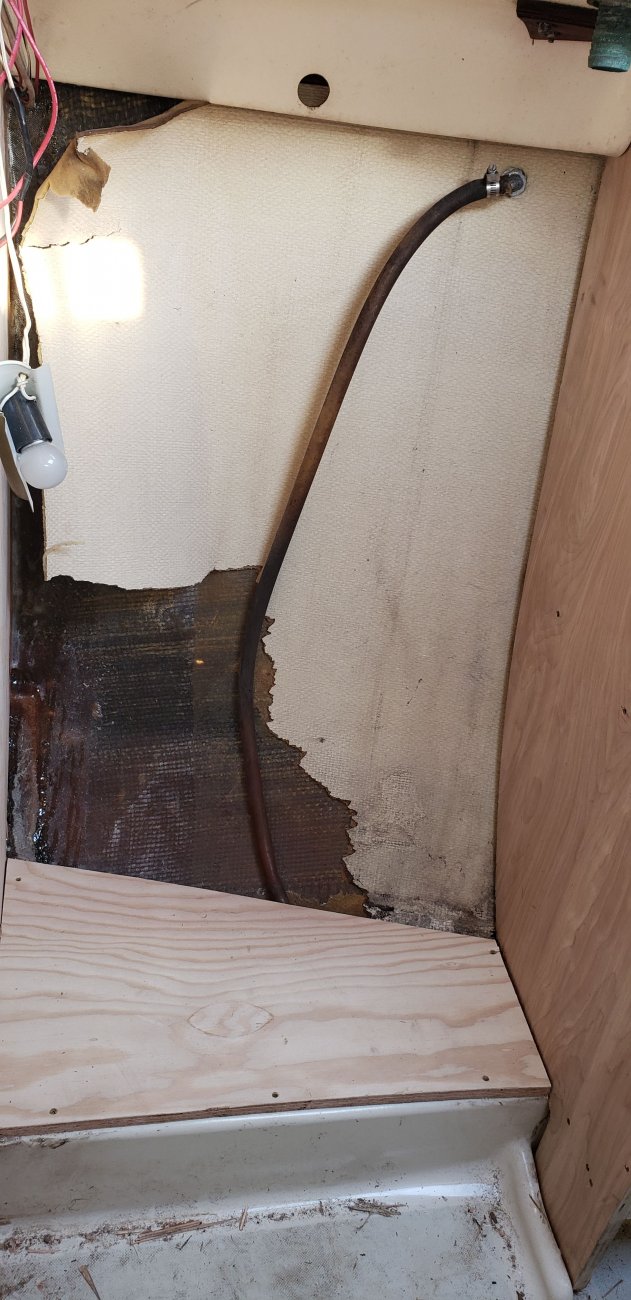

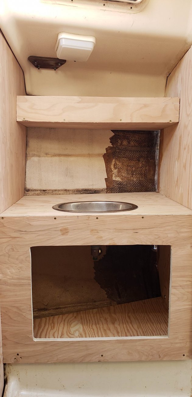

Couple more picture of the progress. Head mostly done still need to redo the hanging locker .

Are you sure you have a dry boat? I'd seal all that wood and edges real good.
