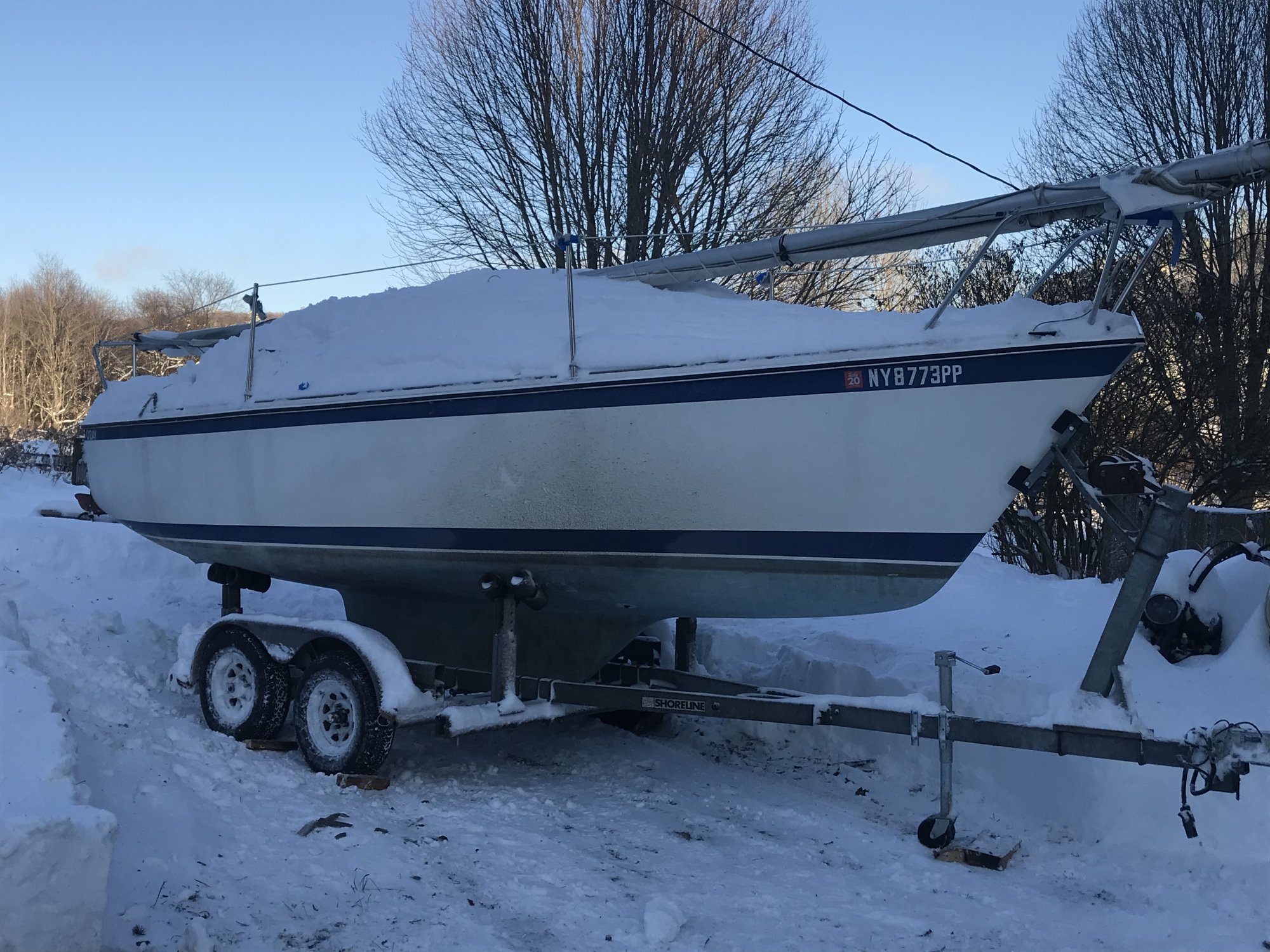

Thank you Mayhem, I crawled in the boat after the snow melt and did find some leaks. I should probably figure a way to seal everything topside...

Read this article Rebedding Deck Hardware With Bed-It Butyl Tape - Marine How To and then buy his product, https://shop.marinehowto.com/products/bed-it-tape. Nothing, I mean nothing will work better. Don't think about 4200 or the like. Never use 5200 as it will never come off again. Use Main Sail's Butyl Tape, accept no substitute as you will then be redoing everything a second or third time if you do.

Depending on where you are rebedding, check for wood core. O'Day usually has a balsa cored deck. You might have to over drill, fill with thickened epoxy, re-drill, and mount. I did that for the toe rails on my old 25, yes, it took a while. Had to replace core under the mast step. It may be a bit of work but, if you do it right, it will last dang near forever. Good luck most here have had to do similar work at some point.

Rebedding all of the deck hardware after epoxy isolating the holes is important for virtually every old boat. In my experience, O’Days are no more prone to leaking than any other older boat. I have rebedded almost everything on my 23 and will do the same with the next boat I buy. If you do a thorough rebedding (with epoxy isolation) then your deck core may stay dry for decades. The same process would be needed for a Pearson, Tartan, etc.
The challenge is that the epoxy work needs to be done in warmish weather. See West Systems website for specifics. And I agree with cb that MaineSail’s methods are the way to go: epoxy isolate, countersink, use good backing plates and seal with butyl tape. I use a routing bit on a dremel to remove wood between the FG skins rather than overdrilling.

It does take a long time. A helper is invaluable so that one person can turn the nuts below while the person above holds the bolts. Crowfoot sockets can be very helpful for reaching nuts that are in tricky locations. I can't imagine trying to do this outside in upstate NY right now. Is that where you are? If you're able to work from Florida maybe you want to tow the boat down to a marina workyard there and do the work in a warm place before you start sailing. I strongly recommend taking the time to do this thoroughly with epoxy isolation, countersinking, backing plates and butyl tape. That way you'll do it once and should not have to deal with leaks from deck fittings for a long time.

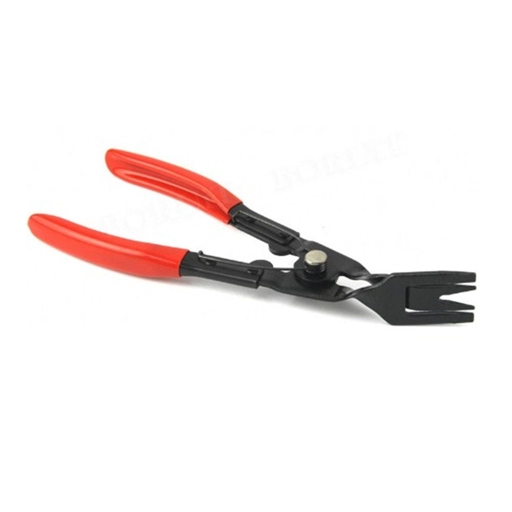

I'm in Chicago. We got an amazing deal on heated storage this year. My most useful tools at the moment are an impact drill/driver, wobble extensions, a flat piece of metal and a panel removal tool. The latter are useful for getting fasteners off when you only have access to one side at a time
