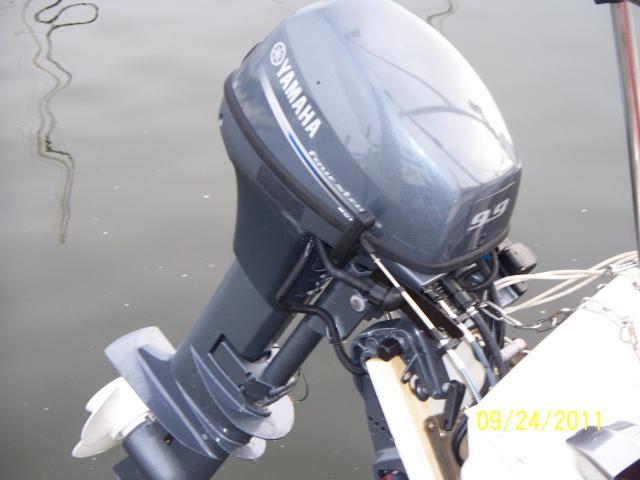

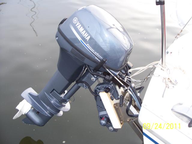

So I Bought a Yamaha 4stroke T9.9 XPA High Thrust 25inch with Remote control and Tilt and Trim 5year warranty. $3200.00 it will be here in two weeks...

Just put it on yesterday! Went out for test run all I can say is WOW it really is nice. So quiet and brought us up to 5kts with no problem. I didn't push it at all. Install went very smooth. No problems with tilt range either. We are so happy to have it before the end of season.
