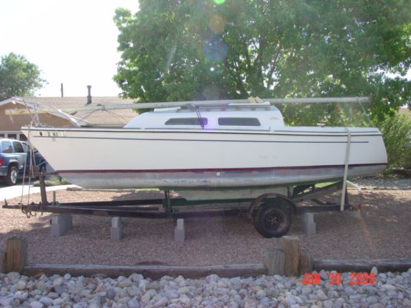

I am looking at an old Oday22 to purchase. It has been dry-docked on it's trailer for over 10 year, and is not in the best of conditions. The part that has me worried the most is that the hull shows some distortion at the front of the bunk. It appears that this was not the original trailer and the bunks did not conform to the shape of the hull. I have two questions:
1. Is this a deal-breaker? The boat itself is not expensive ($1500) but I am concerned that repairs, if necessary will be higher than a new boat... somewhat.
2. What is the hull construction of a late 70s oday 22... Is it a solid hull below the water line or is it a cored hull below the water line?

All O'DAYs except maybe the 39/40 had solid hulls, no core. The Decks did have balsa cores on most models and they were prone to some core rot and delamination if fittings were not well-bedded. A "bed" deck will sound "dull" if knocked on, may make "crackle and crunch" sound when walked on. The keel on all of the 22s was molded as part of the hull, the 1972-78 models had a 1'11" draft and 600# of lead ballast inside the keel. 1979 models had a keel/CB that draws 1'3" bd up and 4'3" bd dn, ballast was 700# of lead inside keel with only enough ballast in the Cb make it sink (about 15#). 1980-83 models had the K/CB but due to the taller rig, the ballast was increased to 800# of lead inside the keel, again only about 15" inside CB.
Those dents in the hull from the trailer should "pop" back out after the boat is launched, as long as there are no cracks... they should be OK, but worth checking on. The bunks may be able to be adjusted to better support the hull (also the keel should be sitting on a support on the trailer with weight distributed between hull supports and under keel). The O'DAYs were wel lbuilt, but I would not be overly surprised to find the hull had "settled" over the 10 years of sitting on that trailer (My DS II will settle slightly over each Winter).
When in doubt, have a Marine Surveyor check the boat, he/she might be able to offer better advice on-site than I can without seeing the boat. Otherwise, if you are not real sure of condition of boat, keep looking..... $1500.00 might buy another boat that might be in better condition. Still, if $1500 includes a trailer (in good shape??) and such, it isn't a bad price! (I paid $1400 in 1996 for my DS II and trailer!) You could always sell the included trailer and buy a different one (but "new" will be close to that $1500.00 figure just for the trailer, probably more! Stuart Marine gets over $2,500 for the optional trailer for a new MARINER!)

If it was a later model O'Day 22 with a keel/centerboard, it may be worth fixing up. I would pass it up and keep looking.

I paid 1200 for mine with trailer. The hull on an early model 22 should not distort, in my view, its pretty solid. My vote is to pass, there are too many good boats out there waiting to be found.

Looks like there is no keel support. My boat sat that way every year in the off season until I bought it and remedied the problem. Had similar indentations where the bunks flexed the hull and it bounced right back when I put the boat in the water or raised it off the bunks, so I think it is probably fine. But it's not a good idea to leave the boat hanging on the bunks.
For $750, you'd be getting what looks to be a decent trailer (minus the lack of keel support). Provided it's not rotten on the inside - check those bulk heads- it may not be a bad deal. And for a thousand dollars you are not likely to find a pocket cruiser that doesn't require a bunch of work.

Not a 1977!

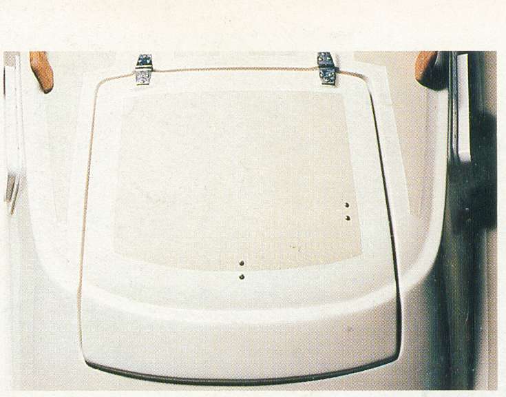

The 1977 was the first year that the forward hatch was flush with the cabin top (see pic below), this one has the earlier hatch that fit over a raised coaming. The hull color scheme does not match the distinctive 1977 wide stripe located about 6" below gunwale, so unless repainted, not a 1977.
1977 was first year that a molded-in gas tank locker was featured in the cockpit. located near the aft end of the port-side cockpit seat.
I'd guess that this is a 1975 or 76, but since this boat appears newer than 1972, check for a 12-digit Hull ID Number molded into the outside of the transom, it will start with "XDY" and the last 2 numerical digits will be the last 2 digits of the model year.
If you want a project, this might be a good boat, especially if you can get her for the lower offer...... but as I alluded to earlier (and others have also said) there are other boats out there "Ready to Sail" or at least "ALMOST Ready to Sail" for the same or less $$.
Joe, this is the shoal keel version, K/CB was 1979-83.

As far as the model I have to take exception with the later model and 222 crowd :D, my '73 is one of the first Oday 22's manufactured and it is a fine sailing boat. It will not outpoint or outrun most things on the water, but for simple pleasure of sailing its perfect, and it can hold it's own in poor conditions.
That raised forward hatch is a problem (mine does not have forward hatch, hence no problem) as it can interfere with tacking the jib.

I didn't think of it before, but you're right about that raised foward hatch. I think the sheets can get caught on it when you tack and that can be a real pain.
