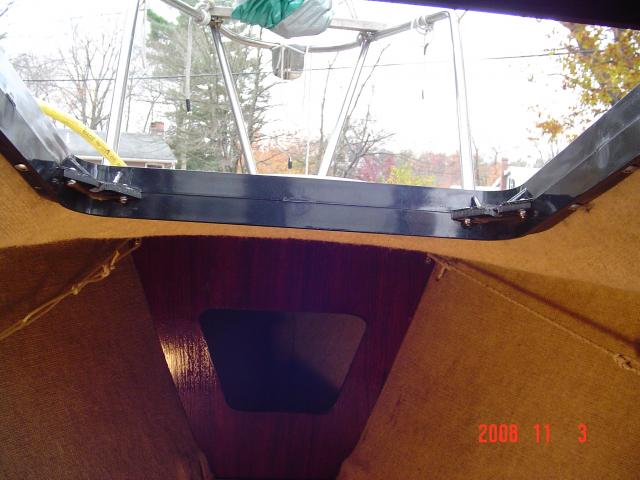

Jan 24, 2005
4,881
Oday 222 Dighton, Ma.
Hi All,
Greetings from the Connecticut shoreline. My wife and I just bought our first cabin boat, a 1978 O'Day 25. It's been kept in very good condition, but the previous owner had taken quite a few things apart to clean/replace, so I am now in the process of putting everything back together. Unfortunately, there are no O'Days nearby to use as a reference. I apologize for what's going to sound like really dumb questions, so please excuse my igorance. Right now I have two issues:
1. I am putting the deck handrails back, and I notice the machine bolts stick into the cabin about 1 inch. Is this normal? Should there just be enough thread to fit a washer and nut, and cover with the plastic caps?
2. The arm that holds the forward hatch open is not attached to the hatch underside. Does anyone know what fasteners are used here, and in what order? I assume bolt+washer on the topside, and a nut on the underside?
Thanks for your patience with my questions. I suspect I'll have a few more as we piece this baby back together!

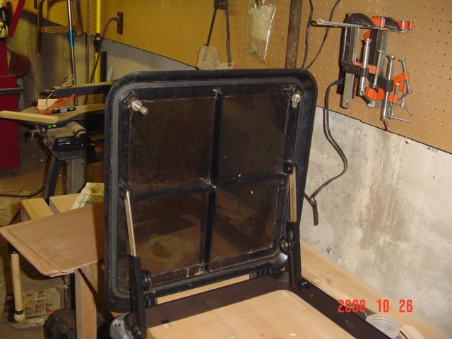

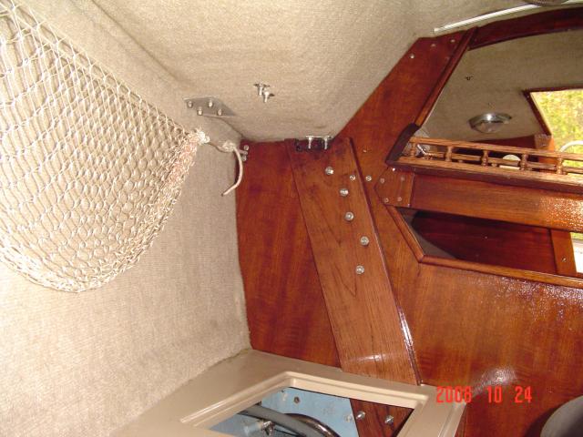

They're not dumb questions. I don't have a 25 but I do have lifelines and stanchions on my 222. It's possible that the PO may have broken some of those bolts when he removed them and he replaced them with longer bolts. I'm not sure if my bolts protrude like that in my cabin, but it stands to reason that you don't want that can cause harm to anyone. I would cut them and cap them, myself.
I have a Grey Marine hatch on my boat that I rebuilt last year. I bought a used hatch just like it and made a good hatch out of the two. The arm, or adjuster on mine is held to the hatch flange with a Allen fitting type bolt. Yours may be different, I don't know. Here's some pics of mine. The first two pics show the back up plates and lock nuts for two of my stanchions. The bolts look to be even with the surface of the nuts. On my adjusters; the a pin is connected to the hatch cover at the top end of the adjuster, and an Allen bolt is used to connect the bottom part of the adjuster to the flange. I hope that I was able to be of some help to you. We have three O'Day 25's and one O'Day 26 in our club, but I rarely ever get to look inside them. I only sail on week days and when I happen to go to the club on weekends, I never see these people at the dock with their boats. Good Luck!

1) Yes, the bolts should not protrude thru the inner liner and the openings should have plastic caps to cover them.
2) Bolt on the outside with a washer/acorn nut on the inside.

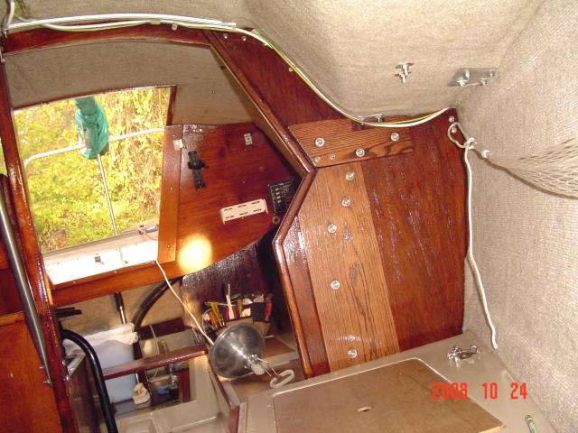

Hi mad dog,
congrats on the boat. I am in the process of rebuilding my 1984 oday 26, which is alot like your 25. You can see some of the pictures by going to my profile page and looking at my photo album.
I was curious as to your experience level with repairing sailboats. I was just wondering if you were checking the core around the items you were reattaching. Mine was rotted out and had to be repaired. I was also wondering what type of sealent are you planning to use?
The bolts on my oday that attach the handrails are flat head machine screws size #10 24 X 3"

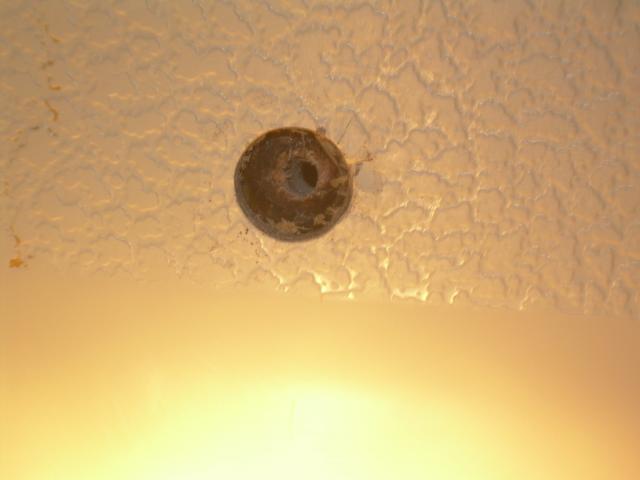

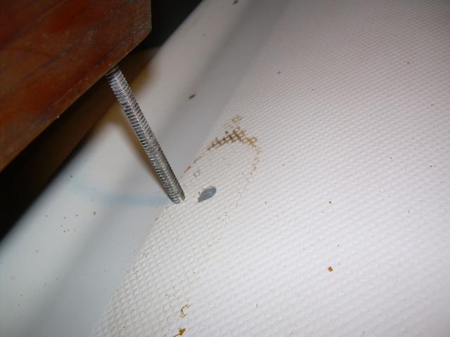

Epoxy of edges - pics attached
Here's a couple of pictures. The first view is from the deck looking down. Second is the same penetration, looking up from the cabin. With the bigger cutout below, I think I could tool the epoxy around the raw wood edges to seal it. Thoughts?

slight change
matt, i think what i would do(this ended up working best for me) is plug the bottom of the hole with a small piece of terry clotth soaked in unthinkened epoxy. let that dry overnight, then use a syringe to instill un-thickend epoxy into the hole.keep some acetone and a few rags handy to quiclky wipe up the drops you will spill and smear. and watch out, it wil get on your gloves and soles, and you will get it everywhere...so check areound your deck and wipe up the spots! also quicly run inside to be sure youre plug is not leaking allowing epoxy to get everywhere in your cabin. come back in a few houres, and fill the hole up again. be sure it is not leaking out, and that it is the wood (balsa core) that is soaking it up. do this two or three time. let dry 24 hours then drill out the hole.
the biggest problem i had with coring everythng out and redrilling, which i did, is that the new holes jsut will not line up with the old holes on the inside. you cant drill at the exact angle you need, to find the interior holes, which opens up a hole new set of problems if you are bolting through to the interior.. but if you get into that problem let me know.
you have to make the plug pretty small. i tried severl things before finding that just a tiney bit ofd cloth works best.
