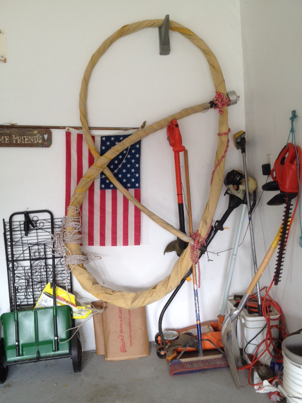

On a different tack - has anyone seen this done to a furling jib?
It was a pain to pull that out of the cabin.

That is a nice pretzel! You will need to lay that out in a warm place, maybe weighted, for a few days. You might even need to turn it a few times to get it straight again. The luff extrusion will hold its curved shape and be unusable til you straighten it.

Concerning the pretzel, I had the CDI FF2 on the 222 and would make a horseshoe out of it in the winter for storage. I used the entire width of the garage and hung it from the rafters, so it was not nearly so tight. It's pretty pliable but I would definitely take Andrew's advice and lay it out in the sun. Those things are rugged so the chances of damage are pretty remote but just to be sure, I would take the sail off and check the foil to make sure it isn't compromised in some way. I would be very surprised if there was any problem.

As an update - the rolling furler is still curved quite a bit - hopefully it will straighten out soon. Need to get the sail off of it - might speed up the process.

I put mine in the yard with 3 cinder blocks to use as a bending jig. I brought it toward straight over several days. Then I took it past straight for several days. One cinder block at each end and one in the middle. Don't put the cinder blocks ON the luff, just bend the luff between the blocks.
