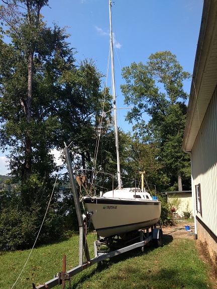

Hey, I'm Stuart. I just picked up a '83 22 foot o'day from a good family friend. It was her late husbands boat and had been sitting in storage without the mast for a few years and in need of some TLC.
I've got the mast up but how do I know when the stays are tight enough? Should it just be a few turns past finger tight? I tried to just wing it after reading the original owners manual but when I started to tighten the backstay I noticed the top of the mast starting to bend much more than I expected.
I'm also having an issue with the cockpit drain backing up. Is there some sort of a scupper or check valve or should I be able to run a snake all the way through it to clean it out?
Thanks in advance for the help!

Welcome! For the stay tension, if you can see the mast bending that’s probably too loose. There are gauges to tell the tension, or methods to do it with yard sticks instead of gauges. As a rule of thumb you should be able to sail close hauled in 10-12 knot winds with minimal or no slack in the leeward shrouds. Before you tighten them down though you might want to check the deck and bulkhead area where the shrouds attach to make sure there’s no water damage. Tightening the shrouds if there is any rot or delamination could make things worse.

Thank you! I worked on the boat a little more last night and I believe my forestay was too tight which caused the upper section of my mast to bend when I tightened the backstay because the only bending was above the point where the forestay attaches to the mast.
I will try to find out if my cockpit drain hose is just kinked, that would be nice though replacing it does not sound like much fun.

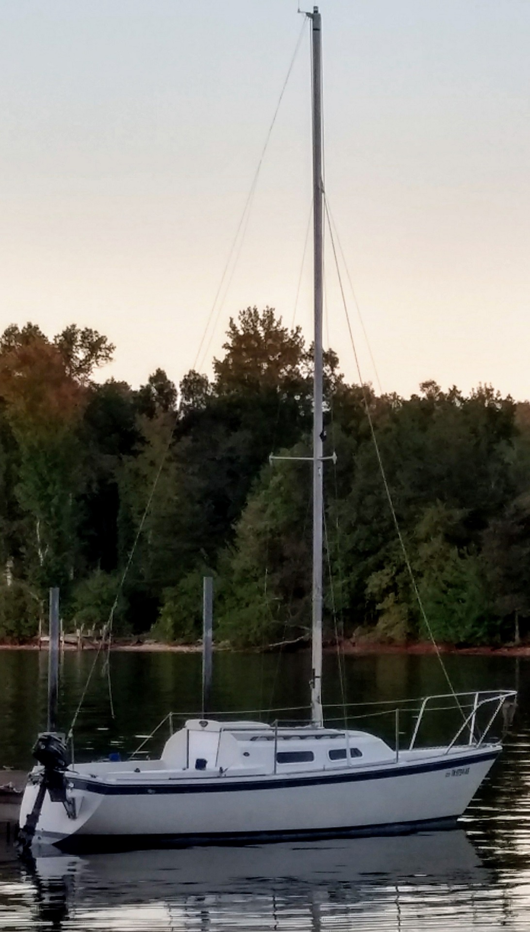

Thanks again everyone! It is indeed a fractional rig and I believe that is why the mast started bending so much.
I now have the boat floating and back together for the first time in years. We got the motor running, new plastic companion way boards made, new tiller, and the boat lights on the boat (not the mast) are now working. I still haven't had her under sail as the wind (and now mainsail) haven't been cooperating.
The mainsail needs work but I'm not sure how much work I should put into it as it appears to be original. If I decide to replace the main is it worth looking at used sales (I don't plan to race) or is that too much of a gamble?
It doesn't look like I'll be sailing this weekend after all but I have been able to take it out and putt around which was nice after all the work we have put into it.

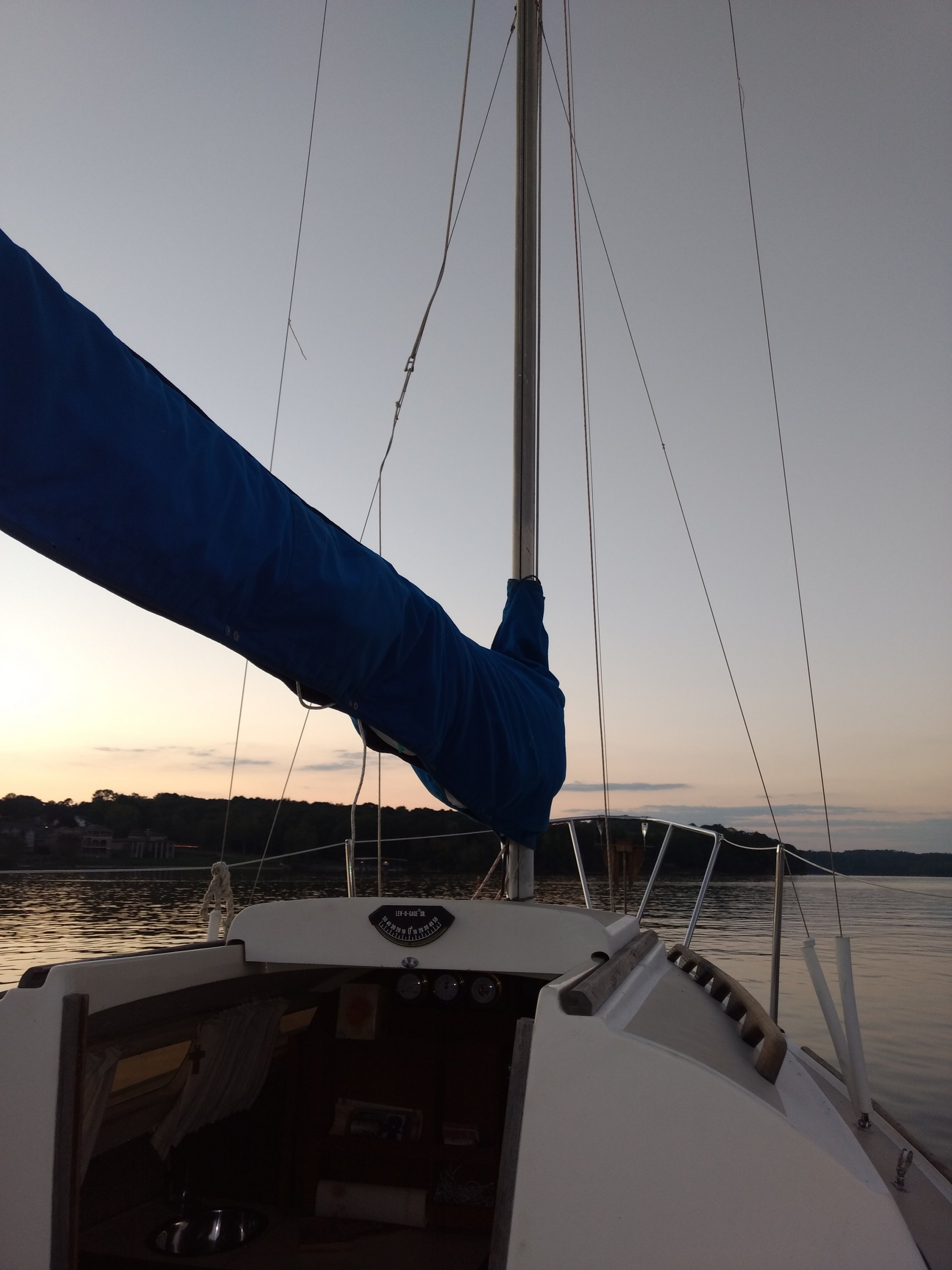

Got her out under sail power alone for the first time, it was nice so nice to be sailing again! Last Saturday was a perfect day for sailing but I had a wedding to go to so Sunday was the first sail... and of course we had less than ideal wind. I still need to do some small projects and tune the rigging (and learn to how to haha) but the boat moved under sail power for the first time in years which was very exciting.
I had rather light wind but I did notice that the boat didn't want to point very well at all even with the center board down. I'm sure a new main would help with that but I'm hoping that I'm just a bit rusty trimming the sails.

Yes I did, thank you again Roger! I was finally able to take the boat out in some real wind without fear of shredding my mainsail thanks to very night package from rojack2.
This boat is so much fun! My girlfriend and I had a wonderful day sailing; both the boat and my girlfriend did great. She had never been sailing before so it was a lot of fun showing her how everything worked and by the end of the day she was doing a great job with the lines.
Thank you again for all of the help, especially to Roger for the sail and main sail cover!
