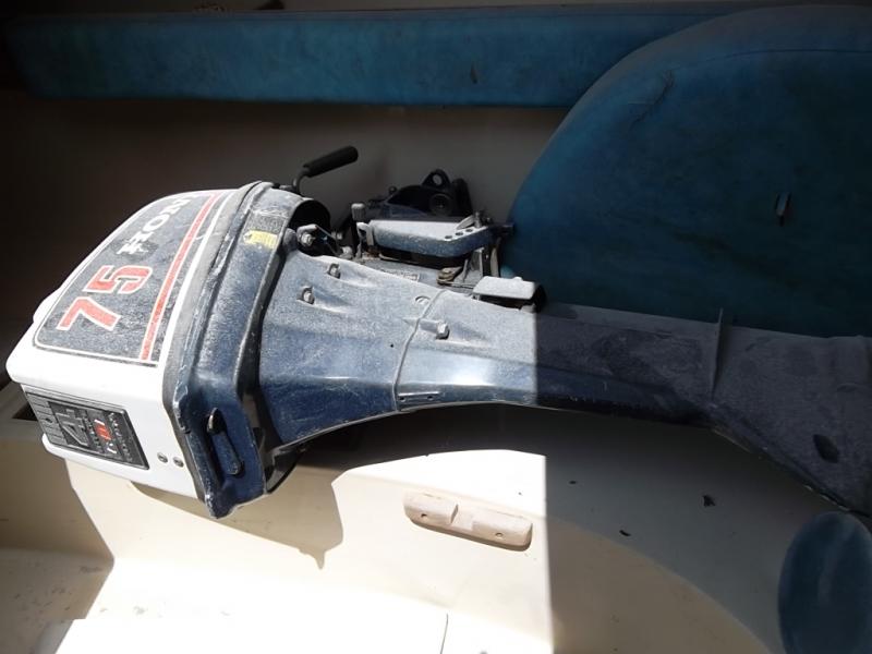

Craigslist searching pays off
I gave choosing a motor much thought and then this jewel popped up on Craigslist locally. Honda 7.5 4stroke (some lakes only allow 4strokes) he was asking $800.00. It was pouring rain I shot 5 $100 bills at him and he even threw in a complete fuel tank w/gauge bulb and full of gas.
It is a little dusty from all the glass work. It is like brand new on the inside and does not have much time in the water.
I the man told me that just swapping the jet in the carb makes this the Honda 9.9.
I plan on dropping mine in the water and motoring around until I find a set of sails. I think the extra HP will come in handy if a storm starts rolling in.

I do not have an issue picking the Honda 7.5 up. I put it into the boat while it is on the trailer. Then loaded it into the cabin by myself.
