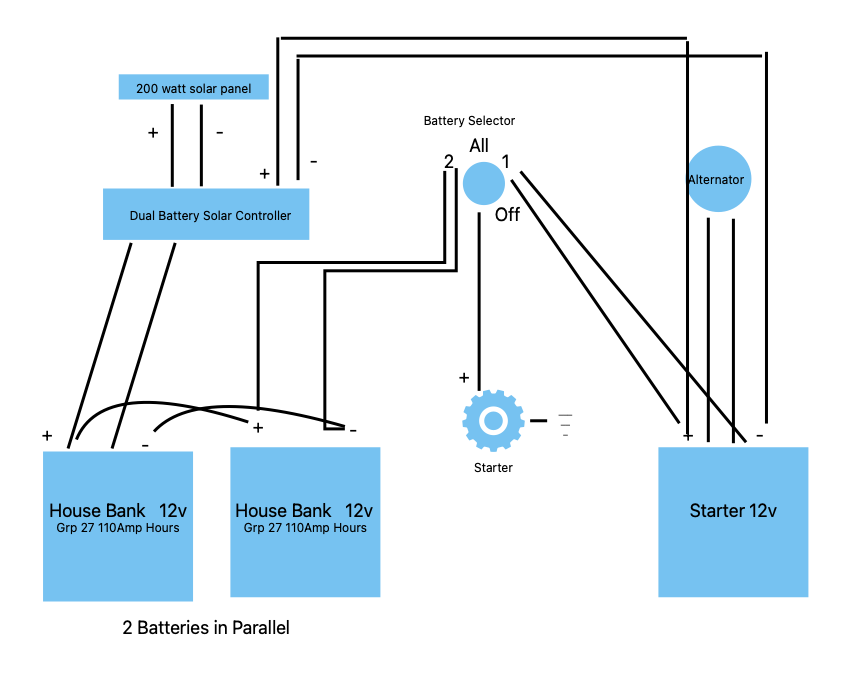

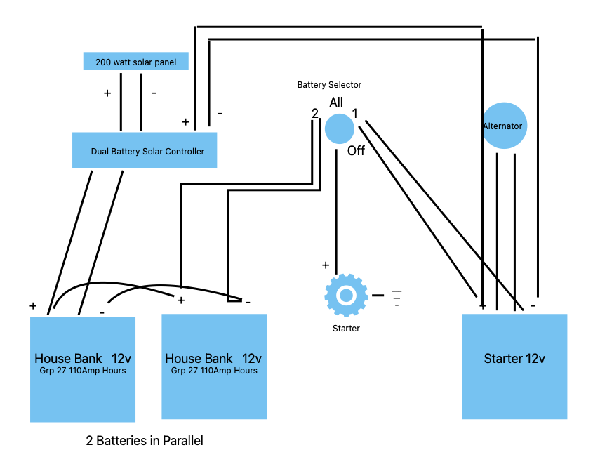

There’s nothing terribly wrong with that setup, but it might not be optimal depending on what you want. The alternator will only charge the house bank when the 1-2-B switch is set to Both. Also you don’t need a specifically dual battery solar controller to charge the two house batteries. You can just charge them as one bank of parallel batteries.

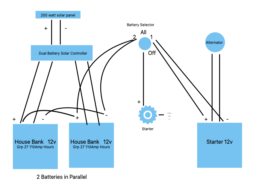

Would this set up, without a AC charger, be correct?
If you put the alternator in parallel with the starter you can charge either/both batteries. Also, this would be a good time to consider an ACR as mentioned above. I'm happy to contribute the second marinehowto.com suggestion in this thread, which covers this arrangement as well as several others: 1/2/BOTH Switch Considerations

I would explore this before I began...
Why did the Xantrex BURN UP?
My New Xantrex is wired like your diagram and is fantastic.

That’s not what I had in mind. It would let the start battery get charged by the MPPT, but that wouldn’t be a priority for me, especially if you have a dual bank shore charger anyway. I’d probably run the alternator to the house bank so it’s always getting charged, and replace the 1-2-B switch with an ACR.
Also I hope it’s just left off the diagram for simplicity, but you’ll need fuses on all the positive battery cables within 7” of the terminals.

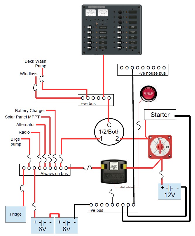

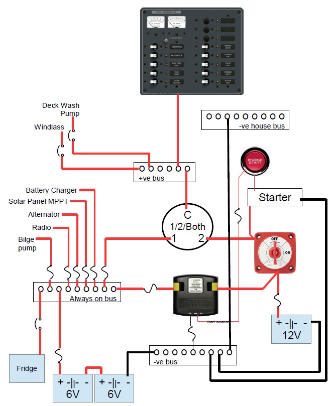

Here is the DC distribution wiring diagram I drew up for my boat. I kept the 1/2/Both switch to allow starting from the House bank and running house loads from the Starter bank if necessary. For normal operation the switch is in the 1 position and there is a separate switch for the starter. The Starter bank is automatically charged when the ACR detects a charge voltage on the House bank from any of the sources.
I made a separate Always On bus for the charge sources and the fridge. I think it would be a good idea to add a switch between the house bank and the Always On bus but I haven't done this yet. If there was a problem with the house bank this would allow normal operation, with limited capacity, by switching the 1/2/B switch to 2 and disconnecting the House bank. I have good access to the House bank so removing a cable is fairly easy, but not ideal.

Do you have a switch on the house battery output? As it is drawn it is not possible to isolate the house bank yet allow the essential devices to run off the start/reserve battery.
No I don't have a switch on the House bank. That's what I was saying here:
I would have to disconnect the cable from the battery to isolate it.
