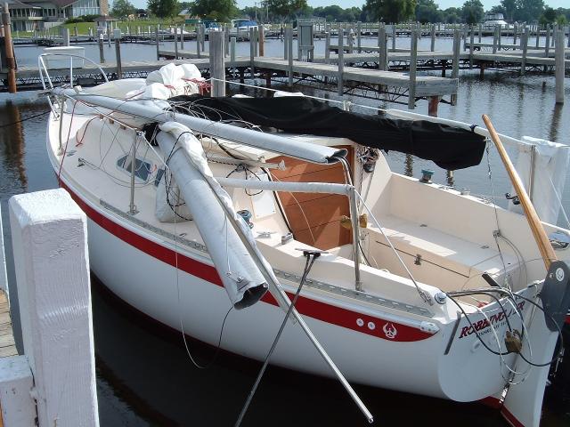

One of the sidestay turnbuckles connecction broke during a tack in medium winds. I inspect these types of connections every few months and had no indication it was suspect. However, the fact that all of the parts of this boat are 24 years old tells me that one should replace any integral part to the mast system before they they fail. When is that? If we knew we would not need insurance.

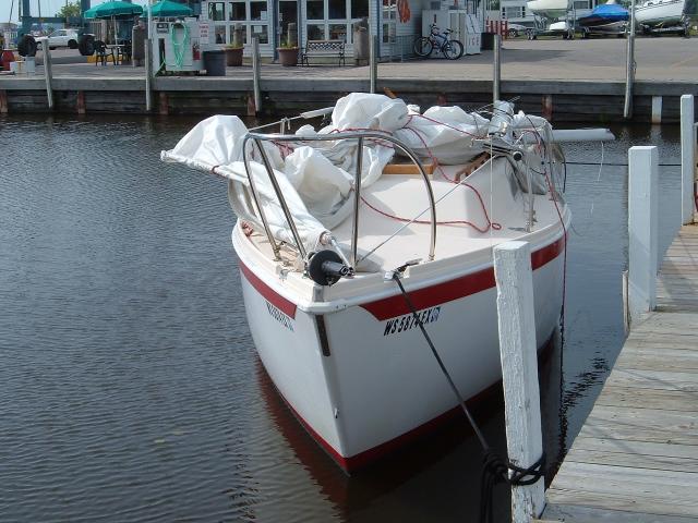

Rob, the photos look like the ones my sister took of our incident. It was her first sail with me I hope she will consider it again. We were just starting to have fun too as the wind was picking up nicely. Fortunately, no injuries accept my mast envy of course, it was still daylight and I did not have to get into the water to salvage the sails and hoist the sad mast aboard. Help from the marina came on a pontoon and assisted in that part. I am still aching from the physical work of pulling in wet sails, etc. Thanks for all. Tom
