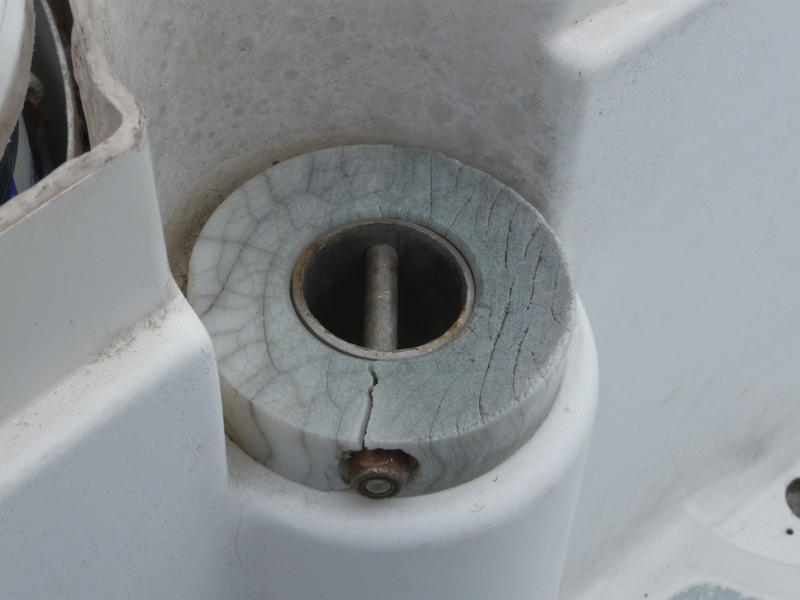

Try a PVC end cap fitting see if that helps.... You may also want to add some sort of rubber seal around the lip of the cap. It also looks like you could us a new plastic spacer bearing while your at it.

Collar-?
Yes; your photo your collar looks like it has a crack in it. This could be failing to provide a seal around the outside of the shaft and allowing water under it to slither down the outside of the shaft into the lazzarette.
dakno
Jun 22, 2009
209
Hunter 41DS new orleans
I had the same cracked Teflon collar retainer on my h27 that crumbled and had a aluminum replacement made with teflon washer between it and hull
128
Hunter 27_75-84 Wilmington, NC
Sorry for the confusion, the picture I posted was an old photo - I replaced the delrin bushing last year, so not related to the leak. I have found a plastic cover, but still wonder how water is getting from inside the rudder shaft and end up drippin from under the cockpit floor. Thanks.
