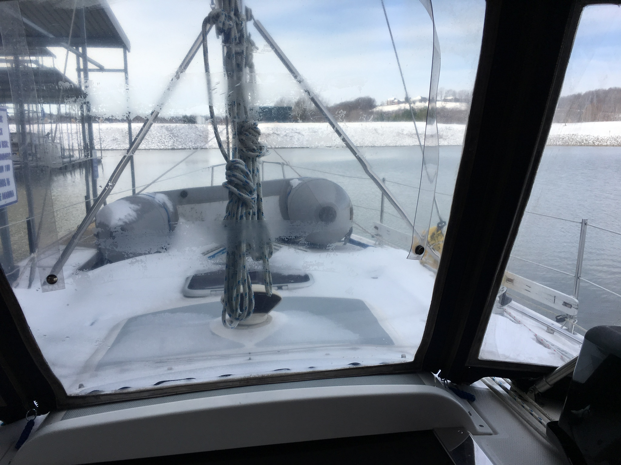

Nick: Do you have stratiglass or something else. I’ve got some water stains on my center panel where I left it rolled up last summer and water collected and has clouded where it collected. Before I replace it, I think iI’m going to try some polish. Anybody tried aggressive polish on stratiglass? You can see the horizontal areas if you zoom into this photo. It looks like clouded plastic almost all the way across in three areas with clear glass between. Look just below the center of the dinghy tubes and about halfway up between hat line and the top. It’s just where you want to look while cruising with the window zipped closed.

Jerry,
If the cloudiness is a calcification, you may find that white vinegar MIGHT dissolve the salts (or minerals). I would not rub it first. I would try to dissolve the coating.
If it is scratched, but clean, then you might try polishing. If you try to polish a frites surface that isn’t clean, I think you’d do more damage.

Thanks. I’ll try white vinegar. It is from rain water, but it is like a white cloudy film, but could be a change in the plastic. I have not tried anything other than alcohol to get it off. Not sure which.

Don’t use alcohol. Don’t use Windex with any ammonia (there is a ammonia free Windex which is all you should use on a boat or windshield wipers/gaskets, etc ).
White vinegar might not work—but let it do it’s thing without abrasion.
The polishing agents intended for vinyl would be next.

DOn't use vinegar. I friend just ruined his isinglass with vinegar and is now looking for a solution to his self-imposed problem.
