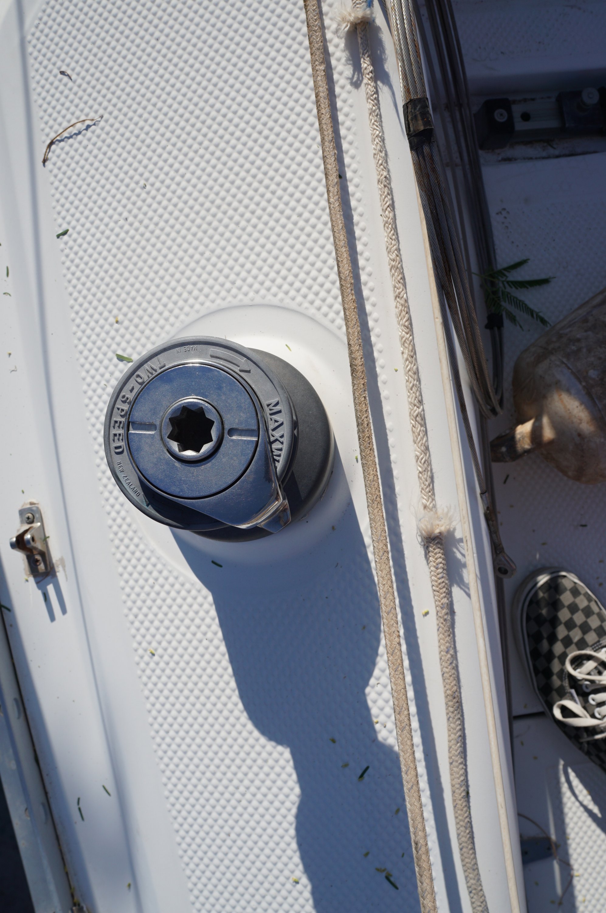

Also, there are two winches in the cockpit but only one Maxwell 14 mounted on the starboard side of the pop-top. Any idea why?

The third winch is probably for raising the main sail or reefing the mainsail from the cockpit. If I am correct, you will need to ensure the halyards are long enough to reach the cockpit and that there is at least one fairlead to handle the line from the mast base. If it's for reefing, you should see some kind of pulley arrangement on the boom used to direct a line that leads to the cockpit that pulls down the main to it's reef point on the main sail. You may have more than just a main and jib halyard in that pile of rope!

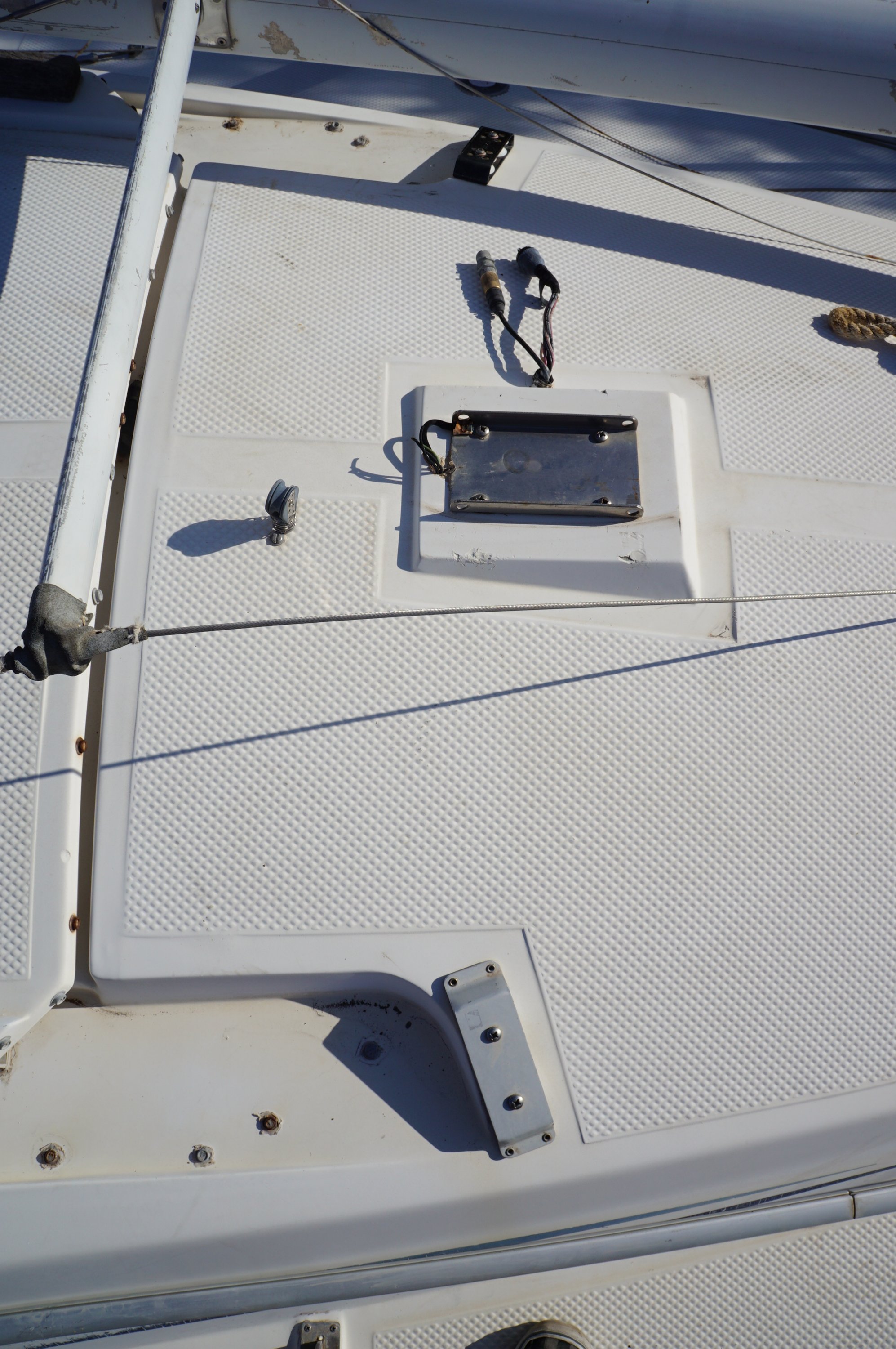

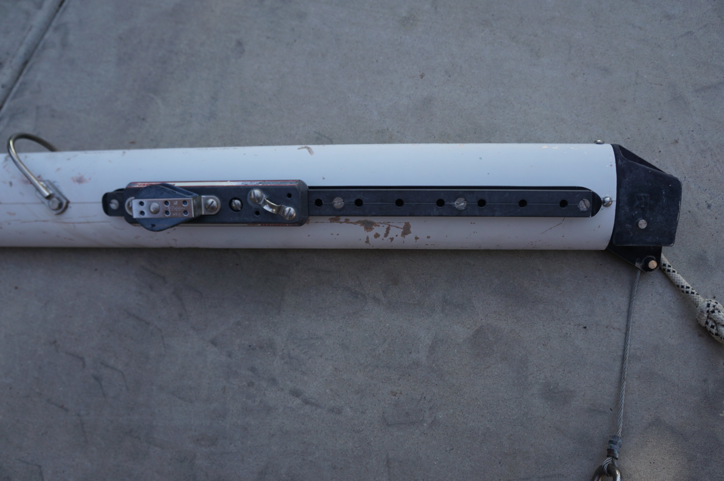

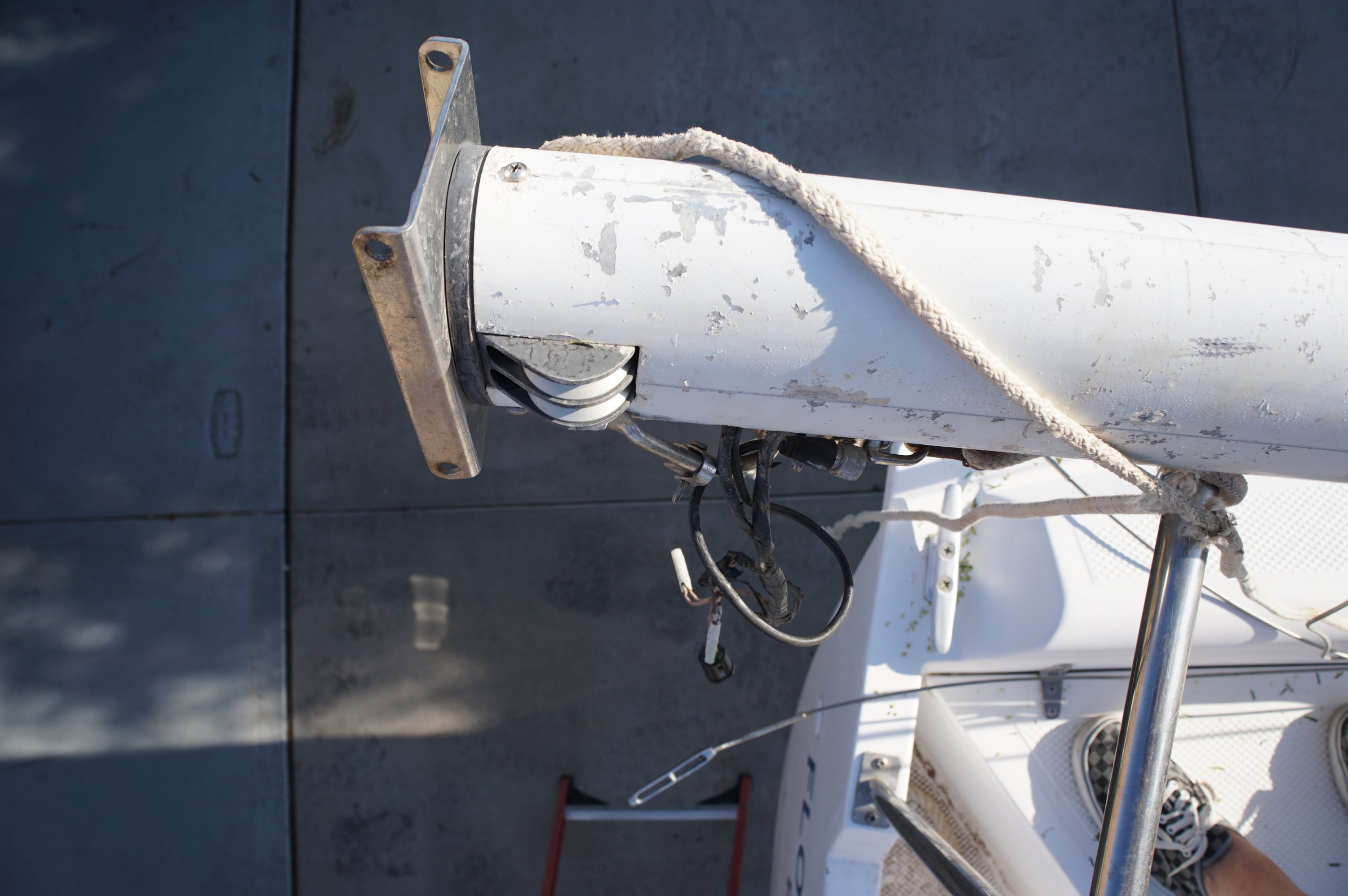

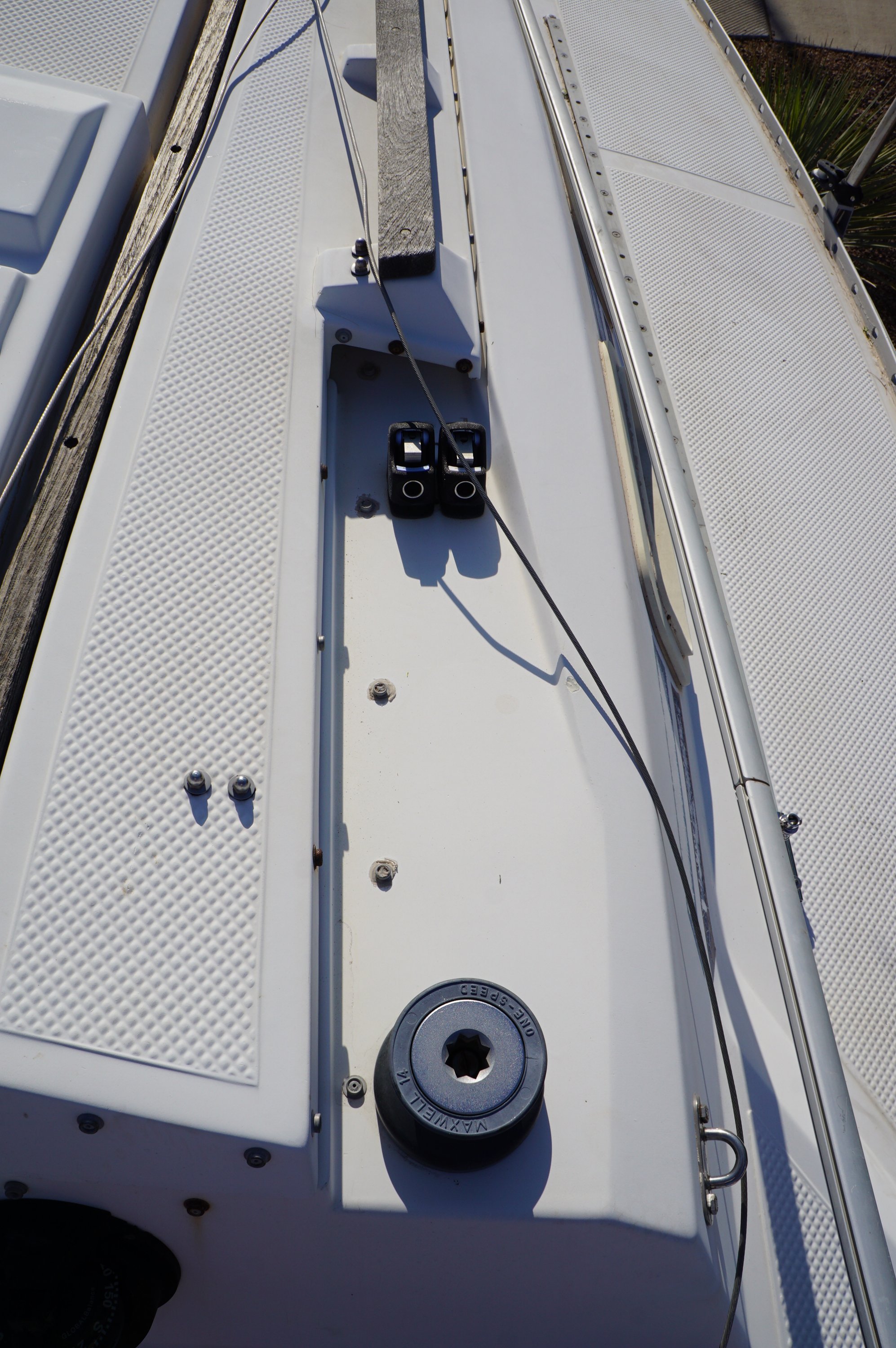

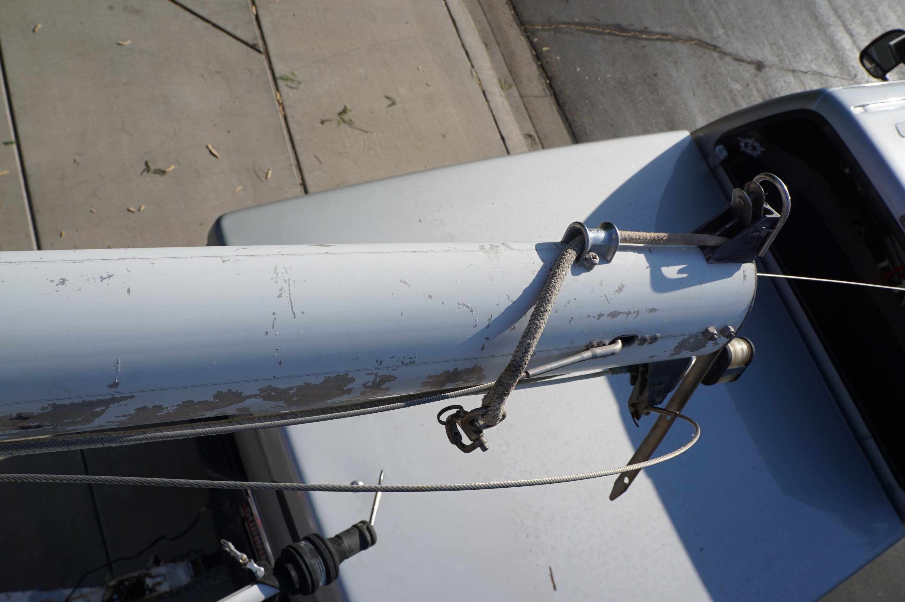

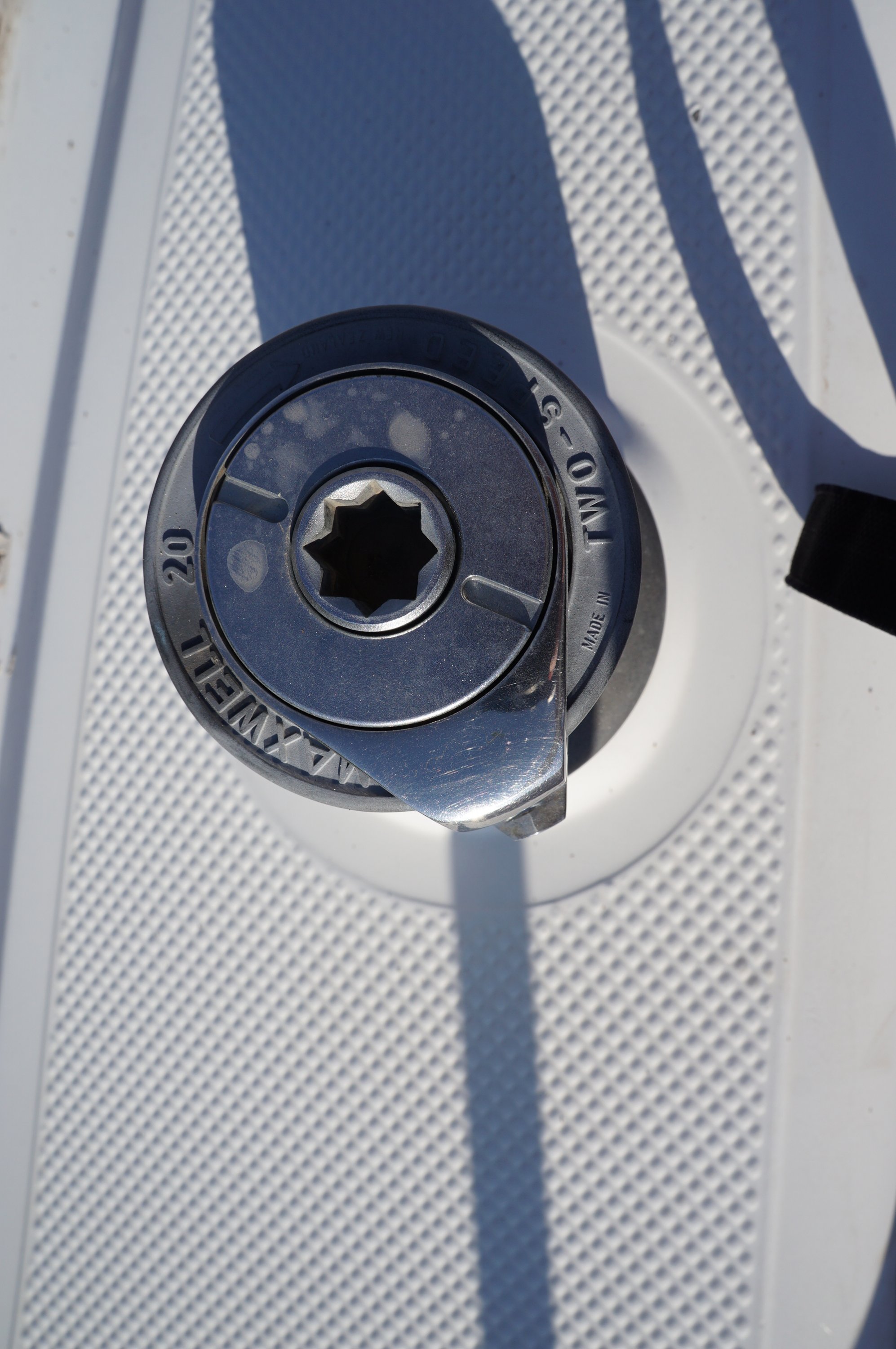

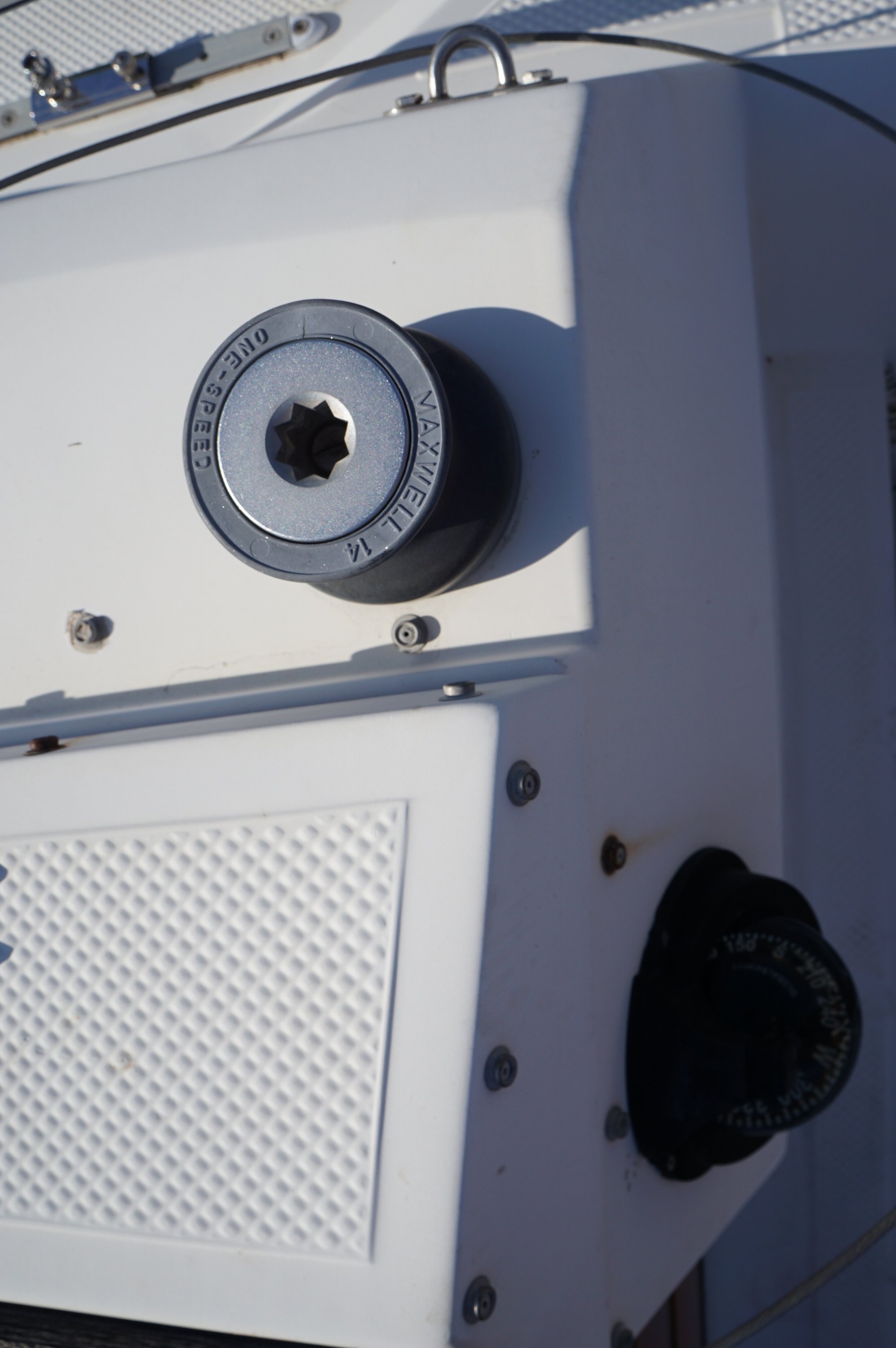

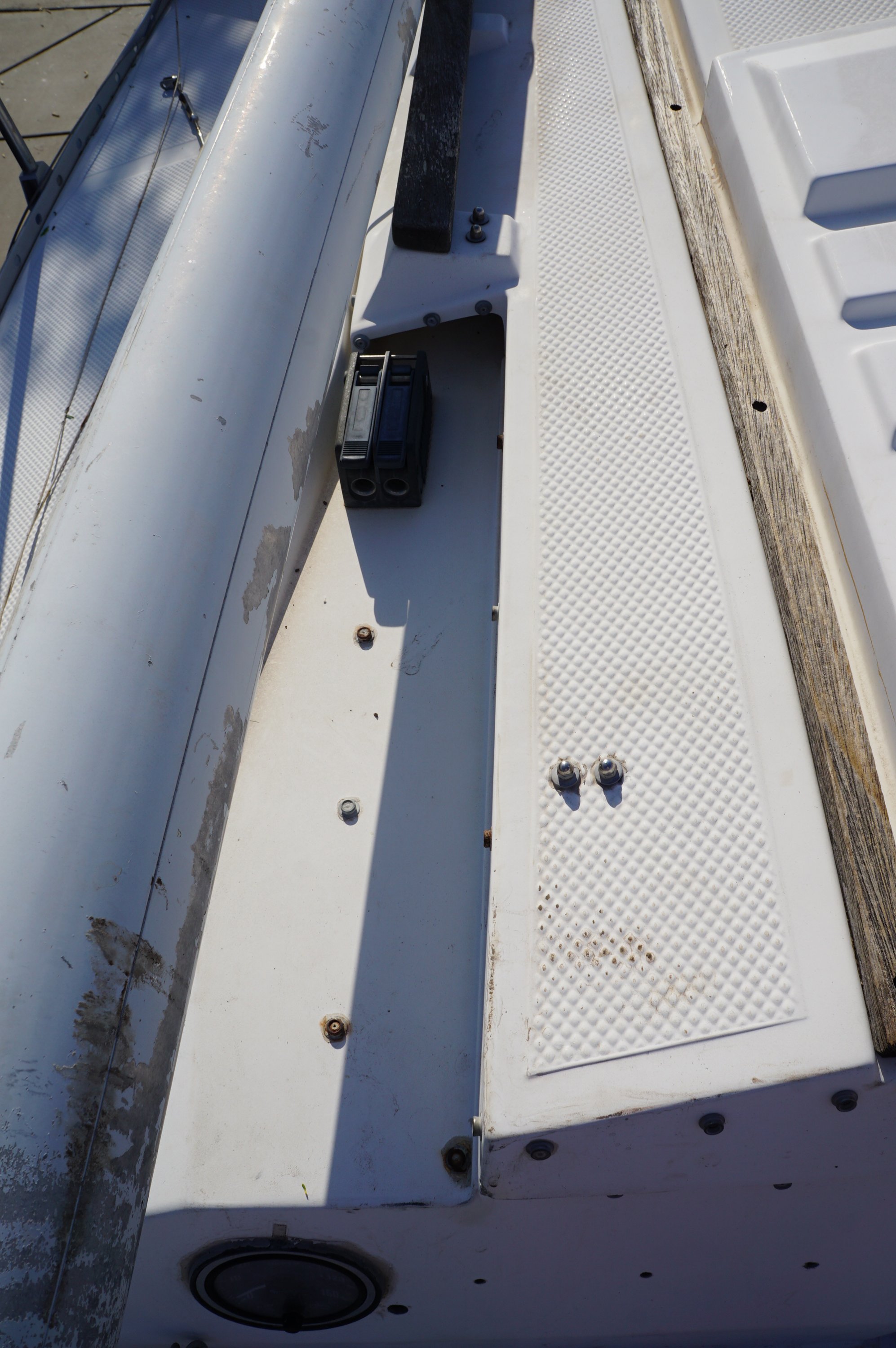

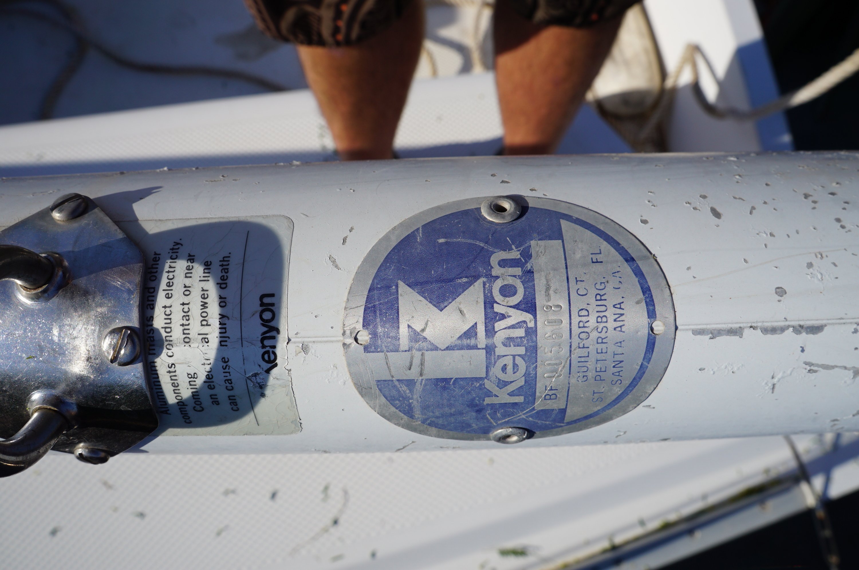

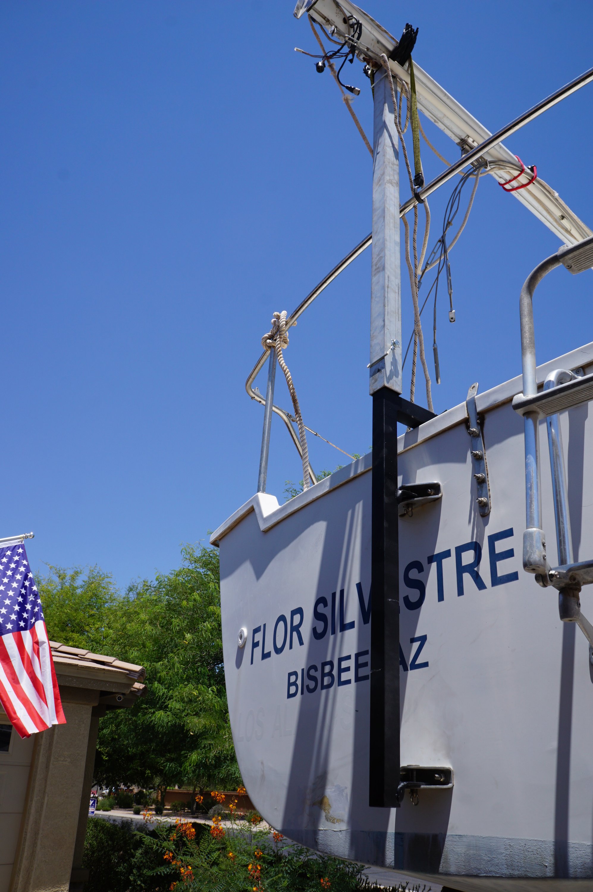

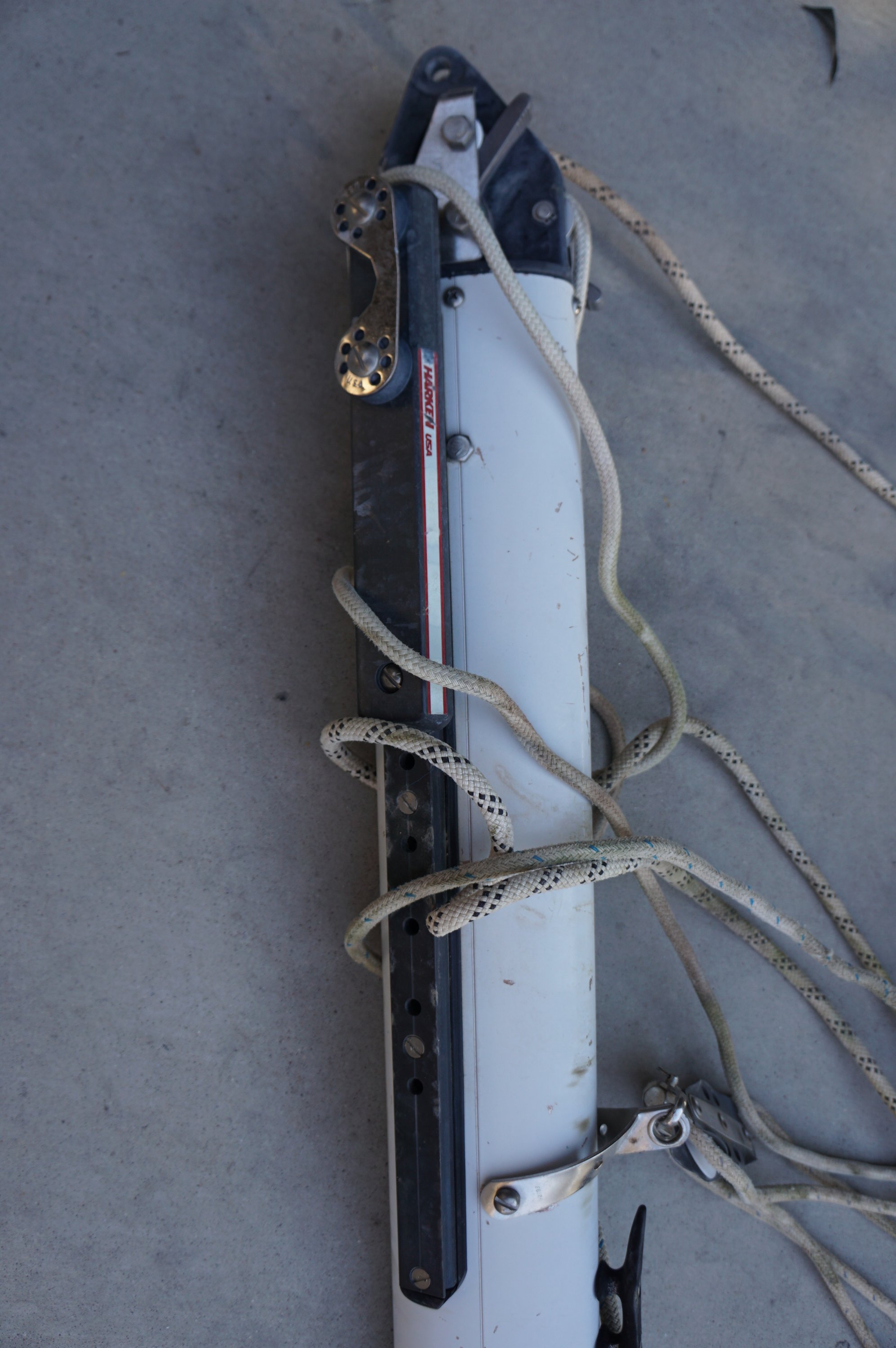

OK here are some pics of the mast, the two cockpit winches and the one odd winch on the starboard side of the pop-top. I also included the boom and various other parts that I'm 100% sure how it all goes together. My contact info isn't private, you can email me at submarine@jetskiaz.com. The domain routes to my gmail which has excellent spam filters. DSC01784.JPG DSC01785.JPG DSC01786.JPG DSC01787.JPG DSC01788.JPG DSC01789.JPG DSC01790.JPG DSC01791.JPG DSC01792.JPG DSC01793.JPG

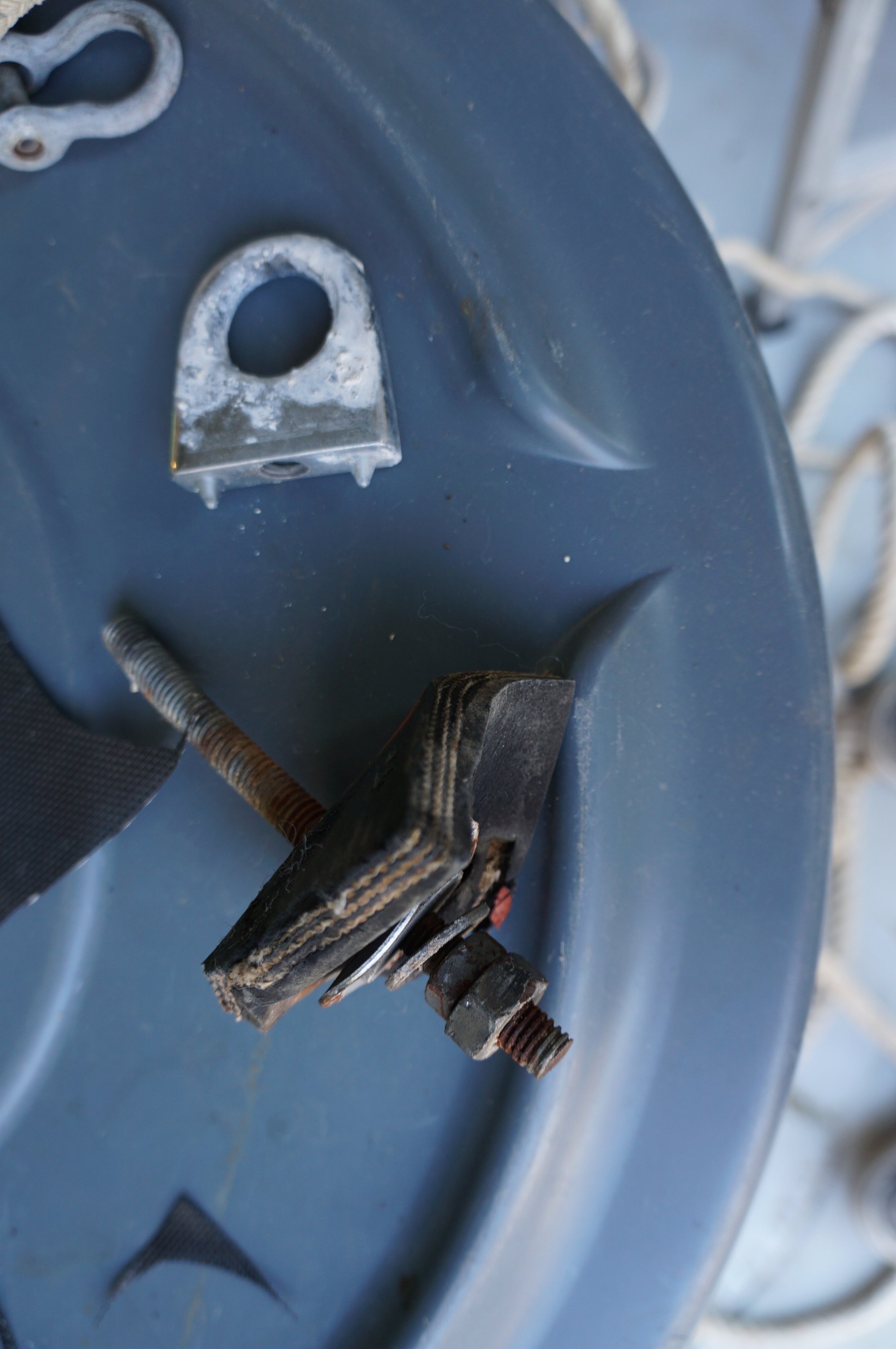

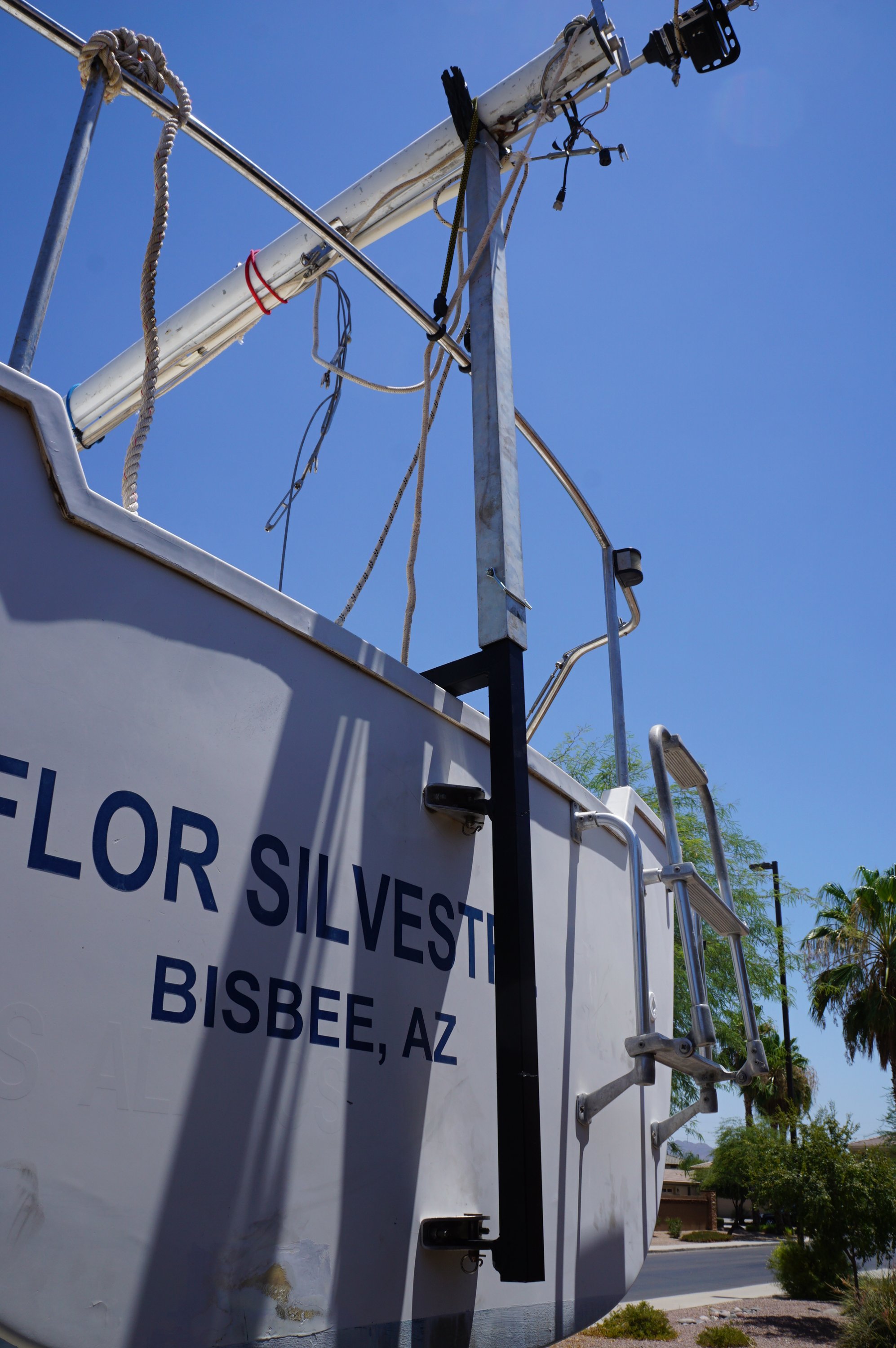

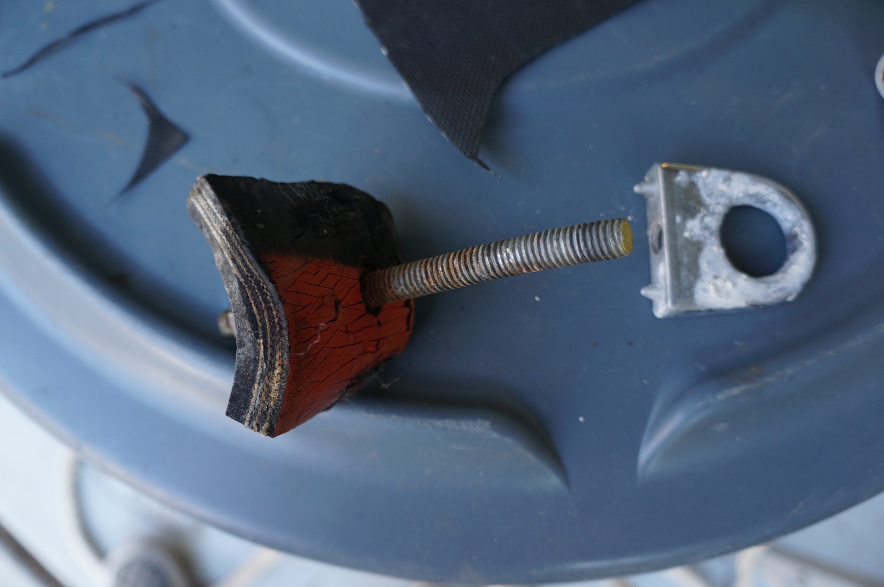

more of the boom, the broken bow eye that I need to replace (seems rigged to me)DSC01794.JPG DSC01795.JPG DSC01796.JPG DSC01797.JPG DSC01798.JPG and a mast support I made today

The third winch on the starboard side is for the main and jib halyards. They route under the pop top through the eyes just forward of the winch.

You have a Kenyon Isomat mast and the best place for parts on the mast and boom are Rigrite. However, I know you have filters but suggest removing personal contact information and go thru the forum email. You will get a lot of junk and possible a hacker or two but that is your choice.
