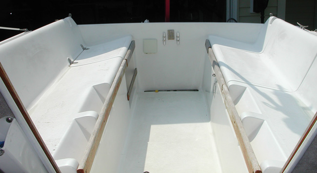

2. The boat has had several non-essential parts removed. There are a couple of wood (teak?) boards to latch your feet into in the cockpit that are gone and the holes caulked. What are the dimensions for these boards?

I tend to backwind my jib a bit during a tack, and also make sure you have some momentum. I just hauled my boat yesterday for the season, and have to winterize it - I will try to check the teak strip dimensions when I get back up there. It is not critical; they are about 2 inches by about 1/4 inch, and as long as the recesses, plus enough to reach past the screw holes. I would consider stainless bolts vs screws if you do replace them. Have not tried to solve your other issues.

The wooden pieces you are wondering about are about 2 inches wide and 3/8" thick. I have uploaded a photo for you to see how they fit.

Not that it matters much, but the wood strips on mine only extend a bit (say maybe one or 1.5 inches) past the recessed gaps. My boat does not have wood across the edge of the lazarette hatch, the gas tank recess hatch, or on the stbd side, all the way aft to the edge of the gas tank hatch. They are only long enough to provide handholds or footholds or places to hang lines (or whatever they are for) over the recesses. As you can see, they are screwed in at the ends and also the center.
