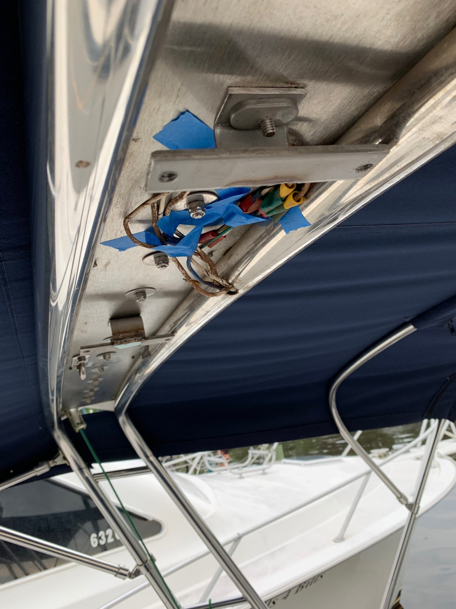

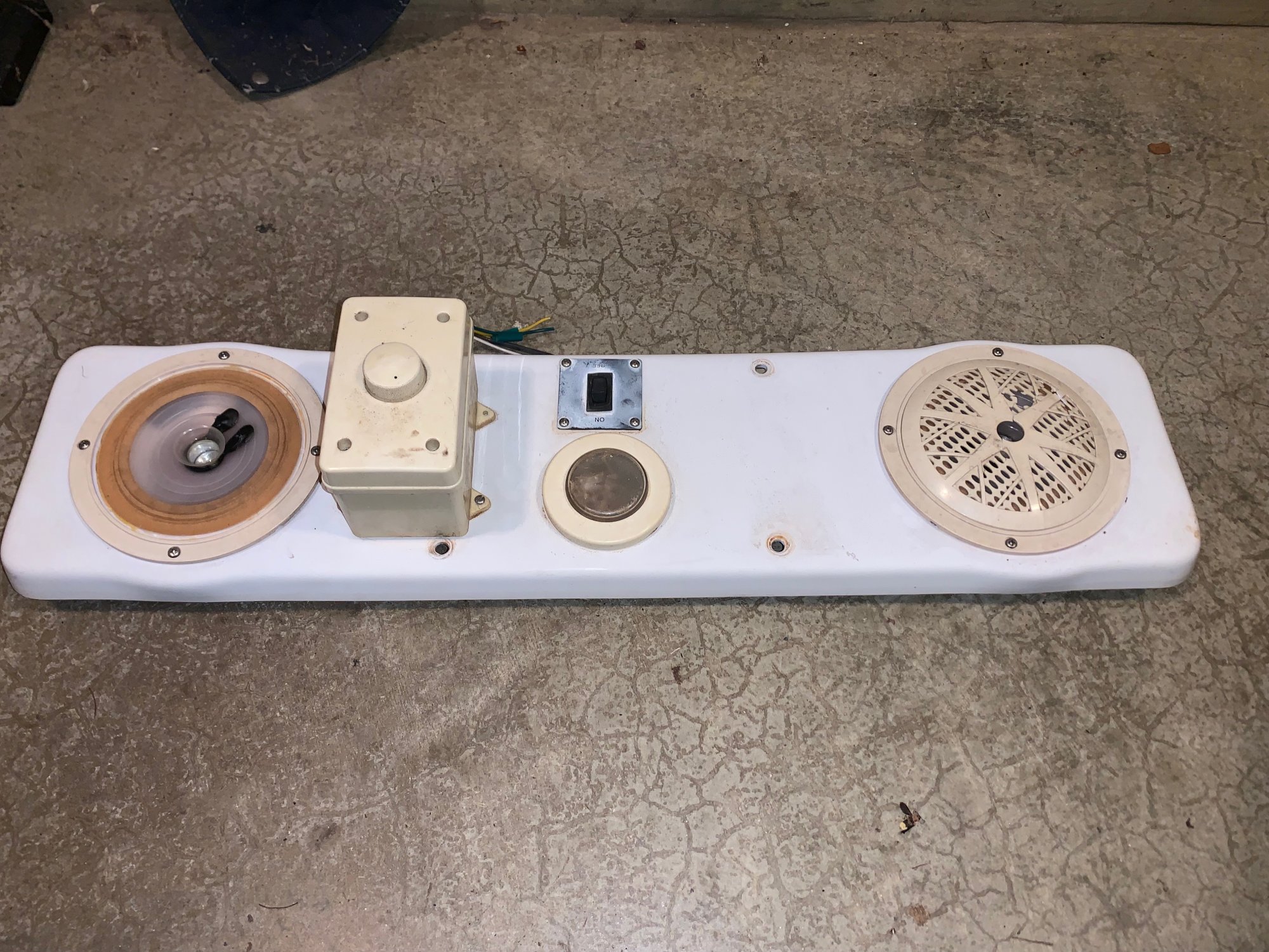

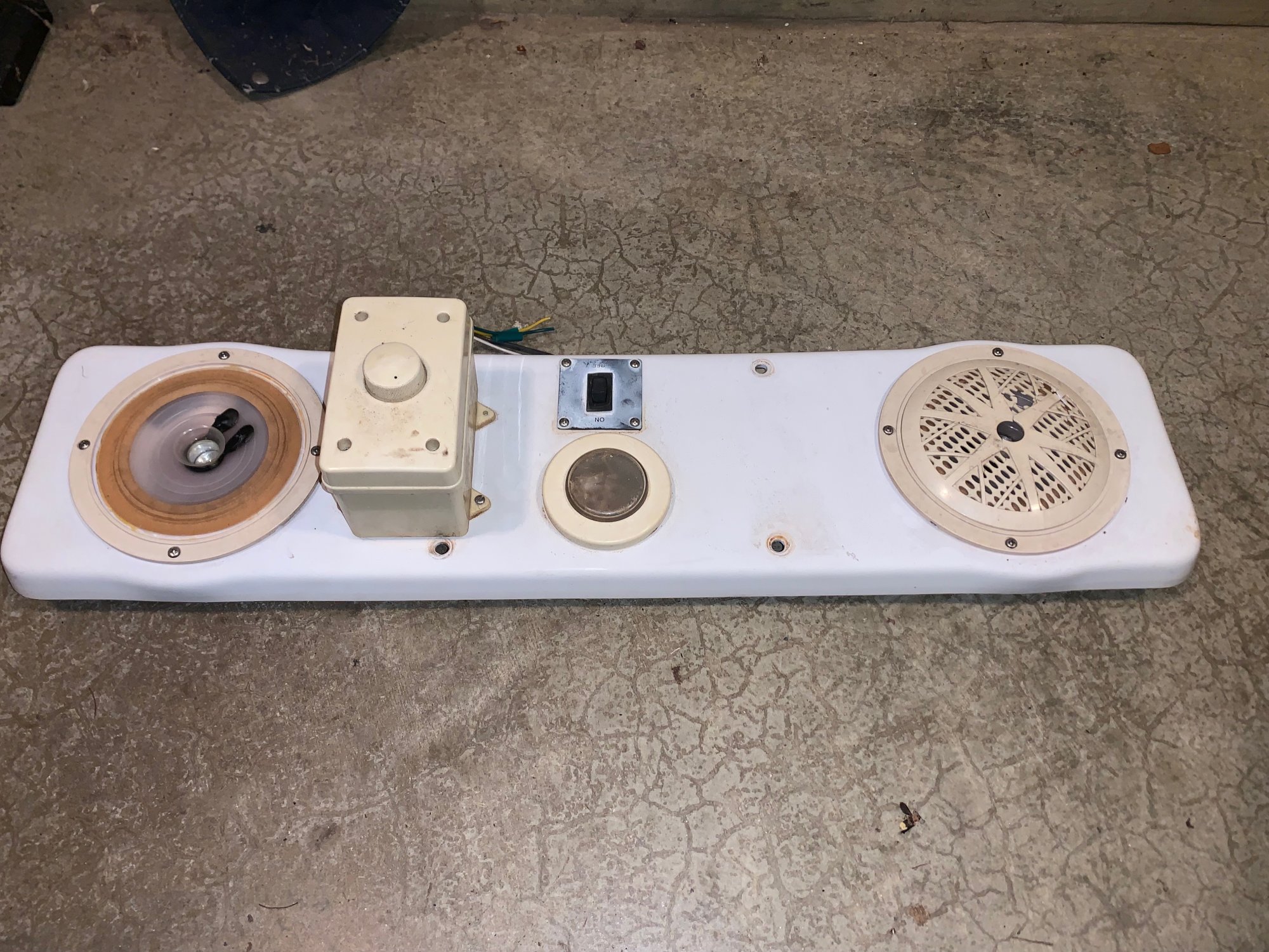

Here's an update on the new arch panel project (maybe console is a better term?). So what was I starting with? The following hideously ugly piece of... stuff:

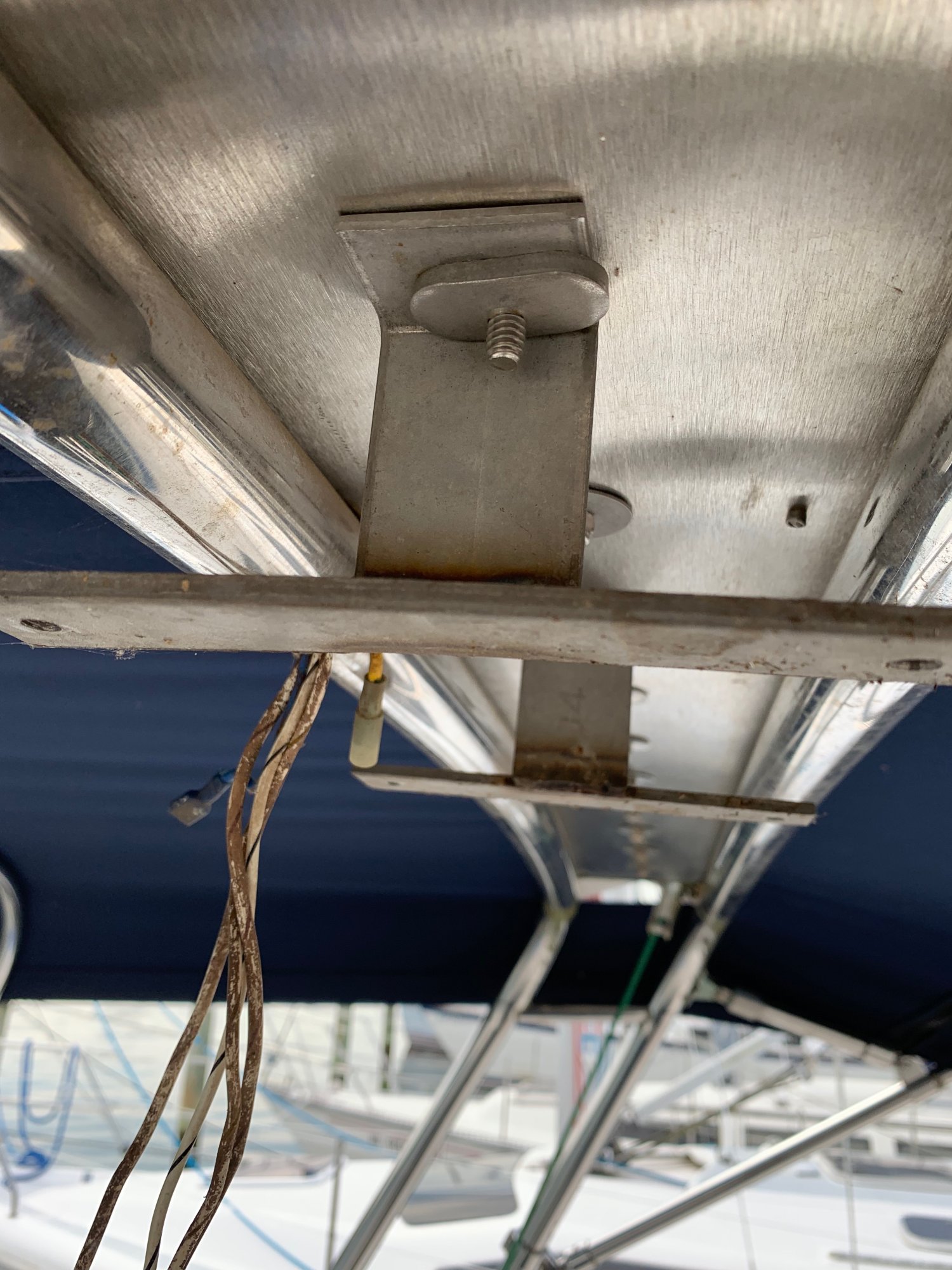

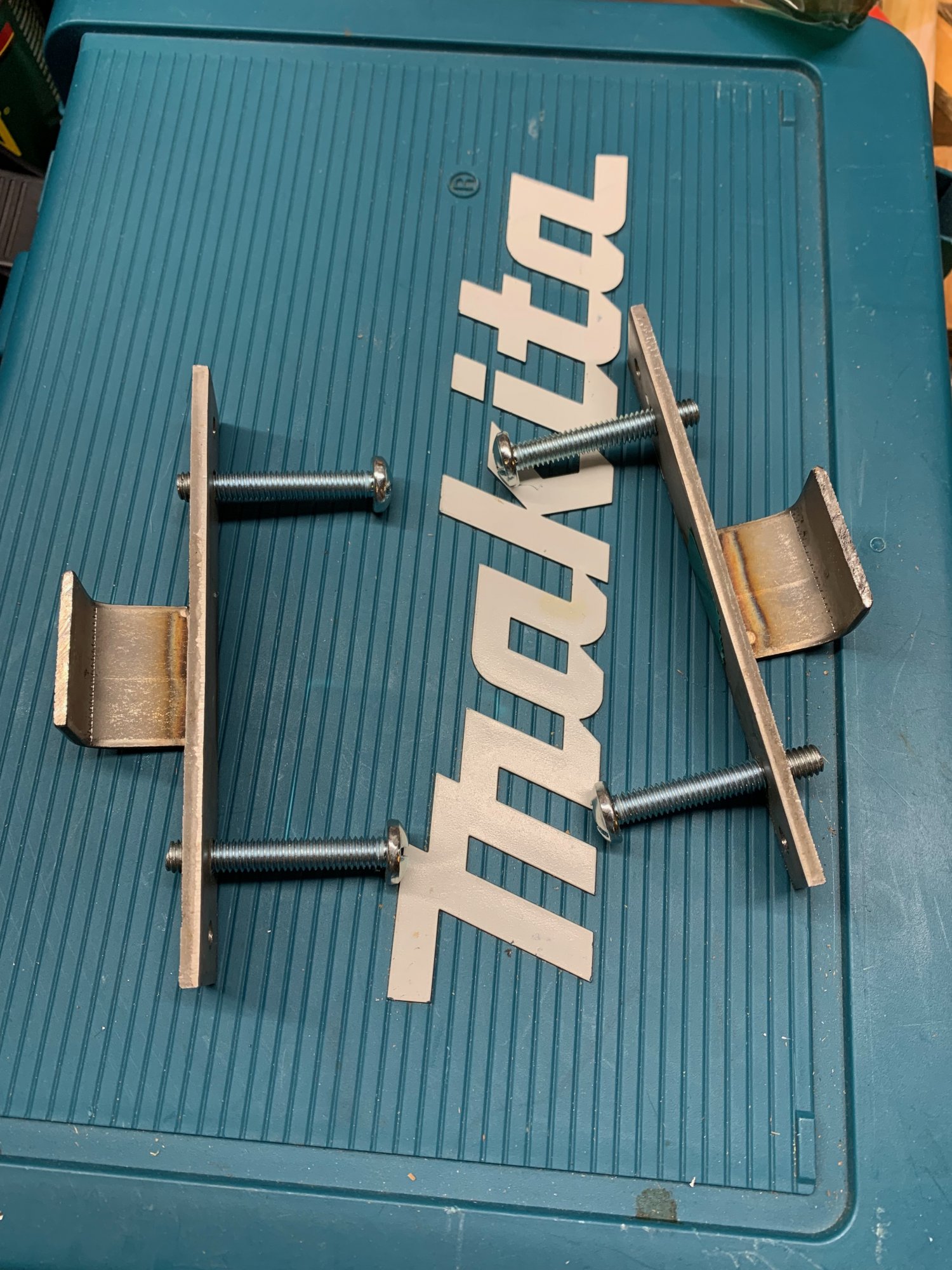

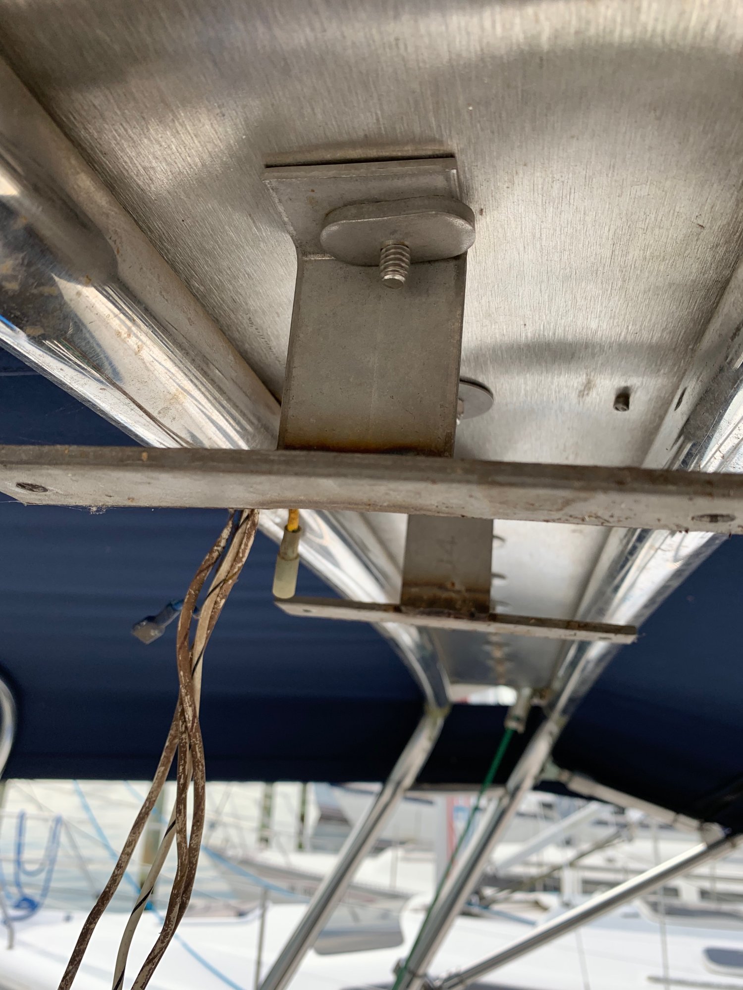

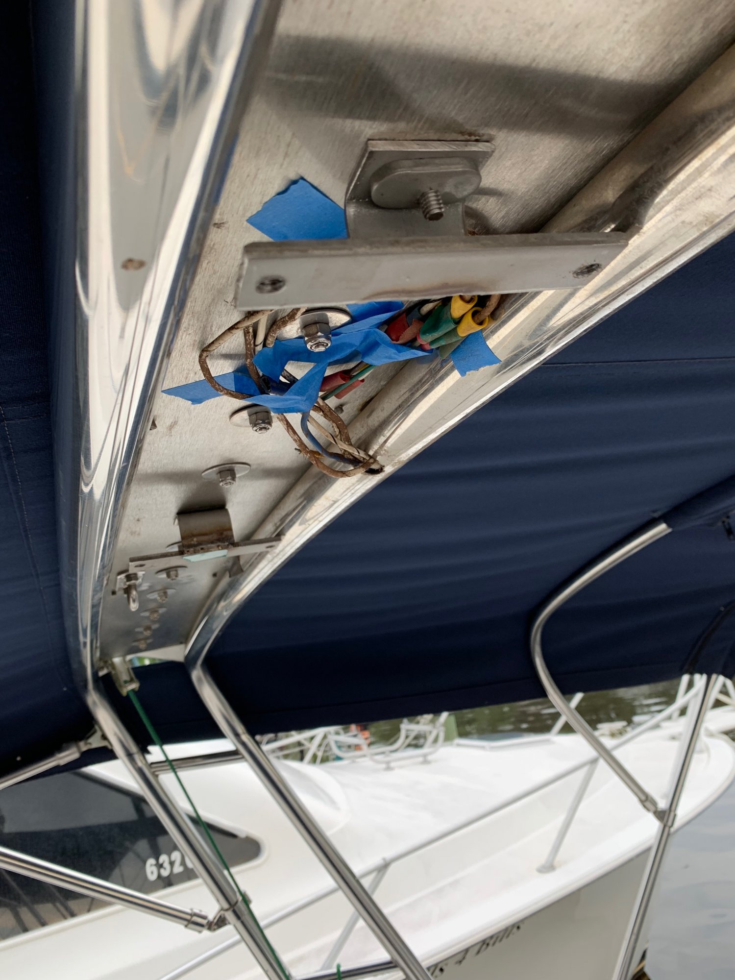

Most of this ugliness is Hunter's fault, but the large carbuncle on the left (a speaker volume control) was my brilliant idea in around 2016. I thought it was important to be able to turn down the stereo volume when at the helm, say if a call came in over the VHF, or if I wanted to talk to an actual person in close proximity. The execution of this idea was less than ideal. The old console was attached with a pair of steel brackets which (as it turns out) hung down below the level of the arch tubing:

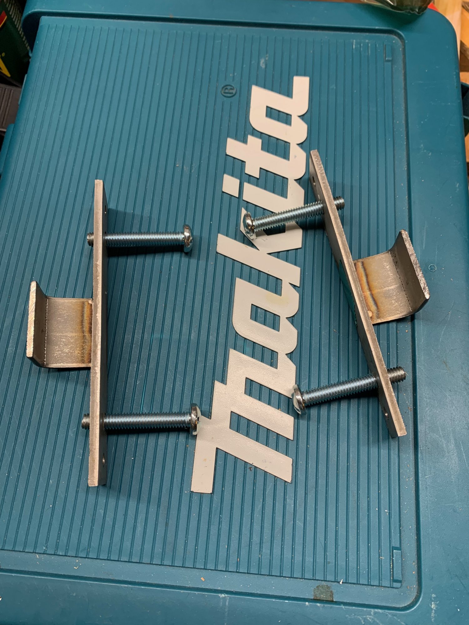

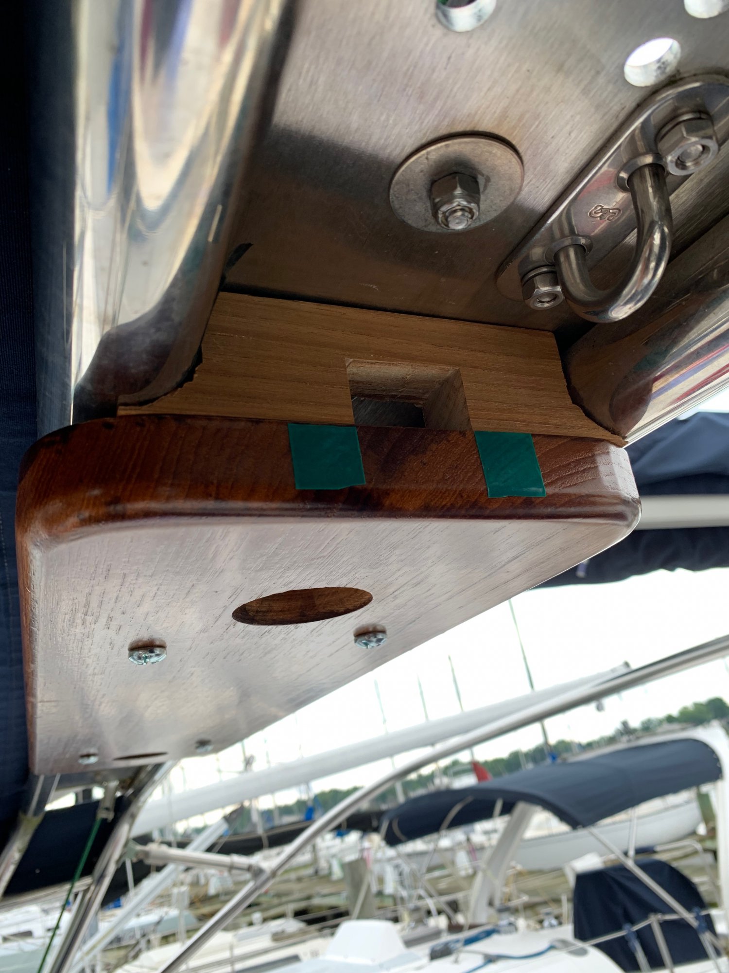

This wouldn't work for a teak console which needs to be flush with the tubing, so I had to modify the brackets, which involved tapping new holes, shortening them vertically (some metal bending) and trimming them horizontally. Here are the modified brackets before trimming off the horizontal tabs:
and here they are mounted to the arch:

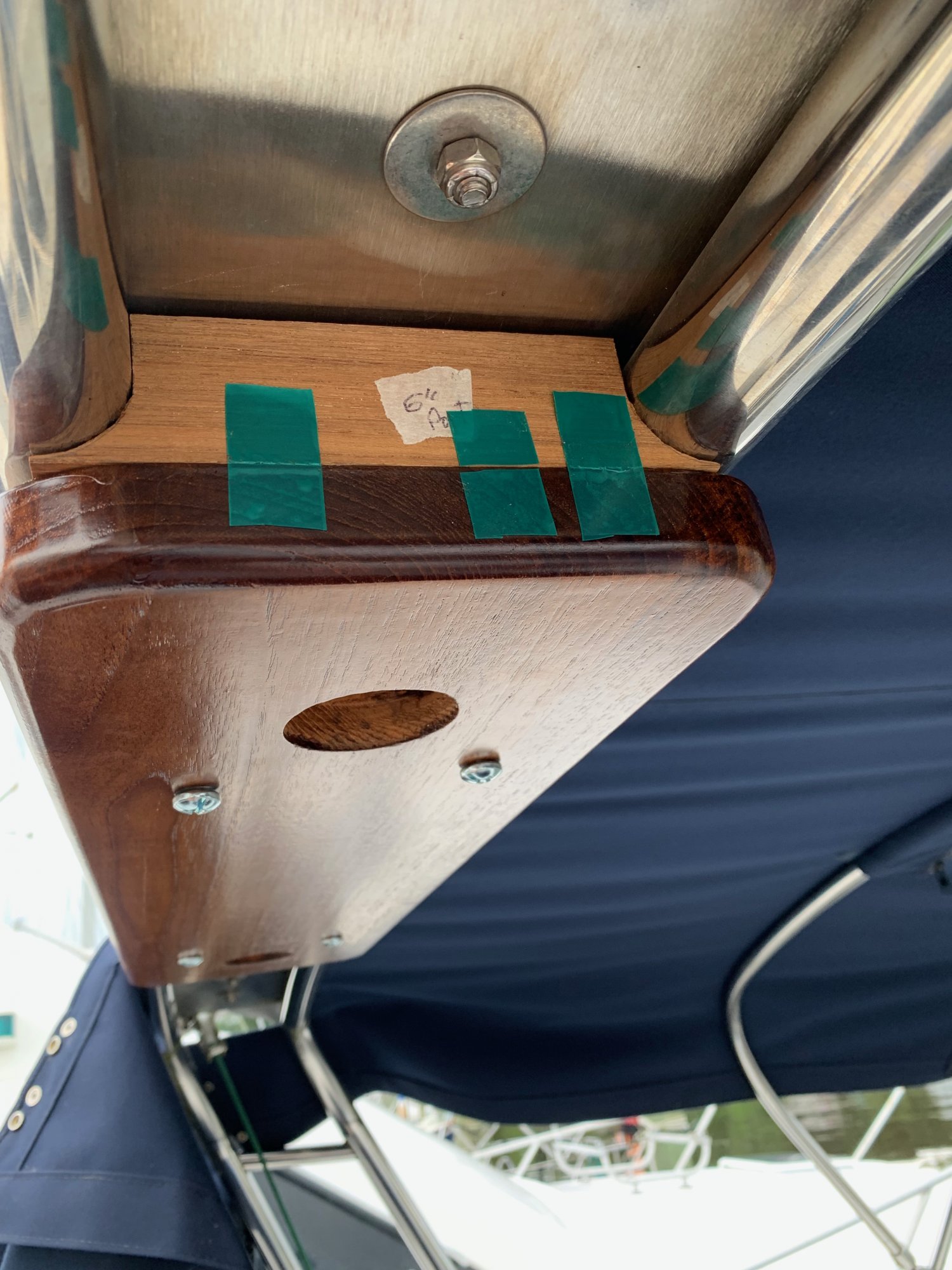

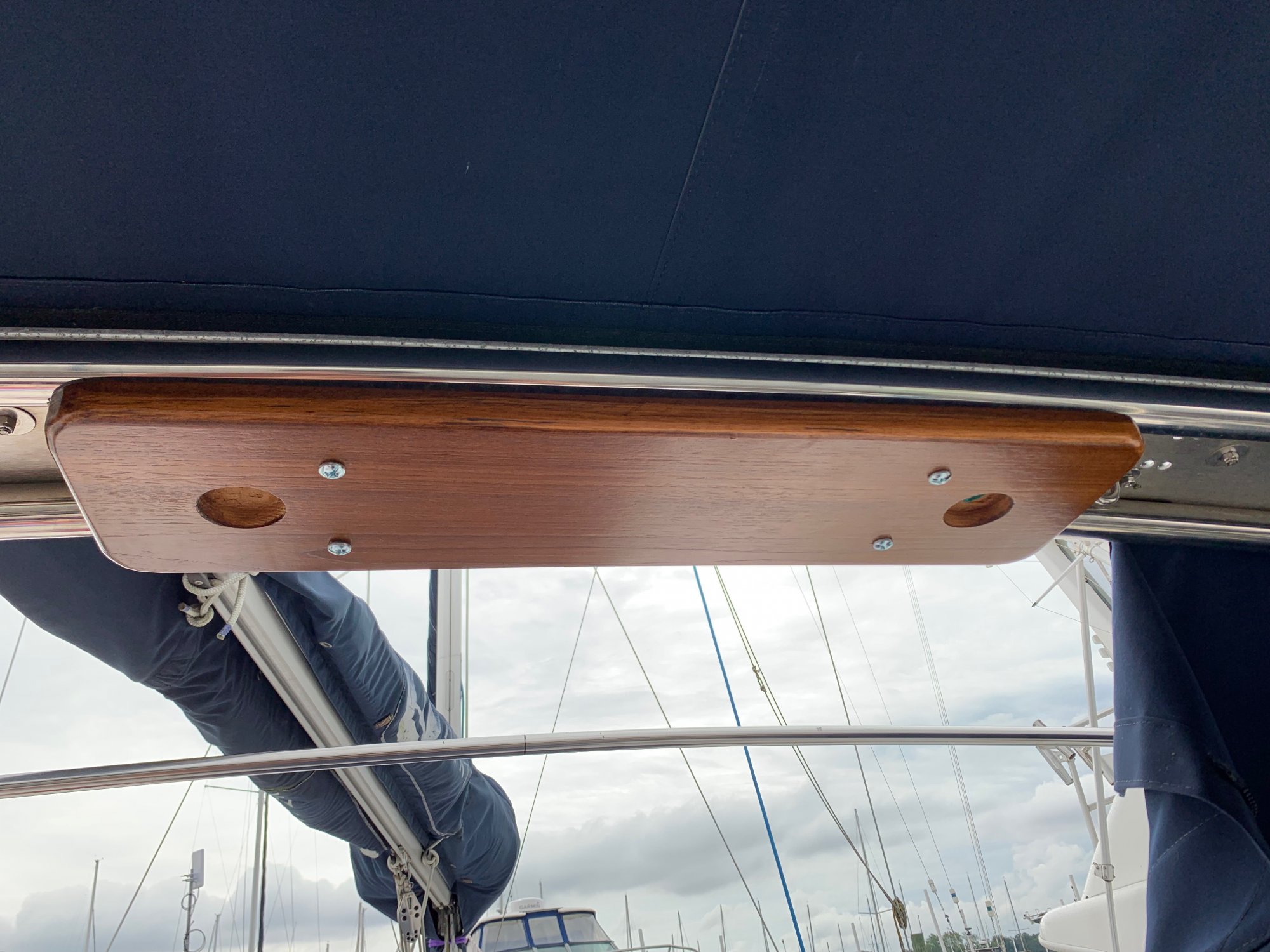

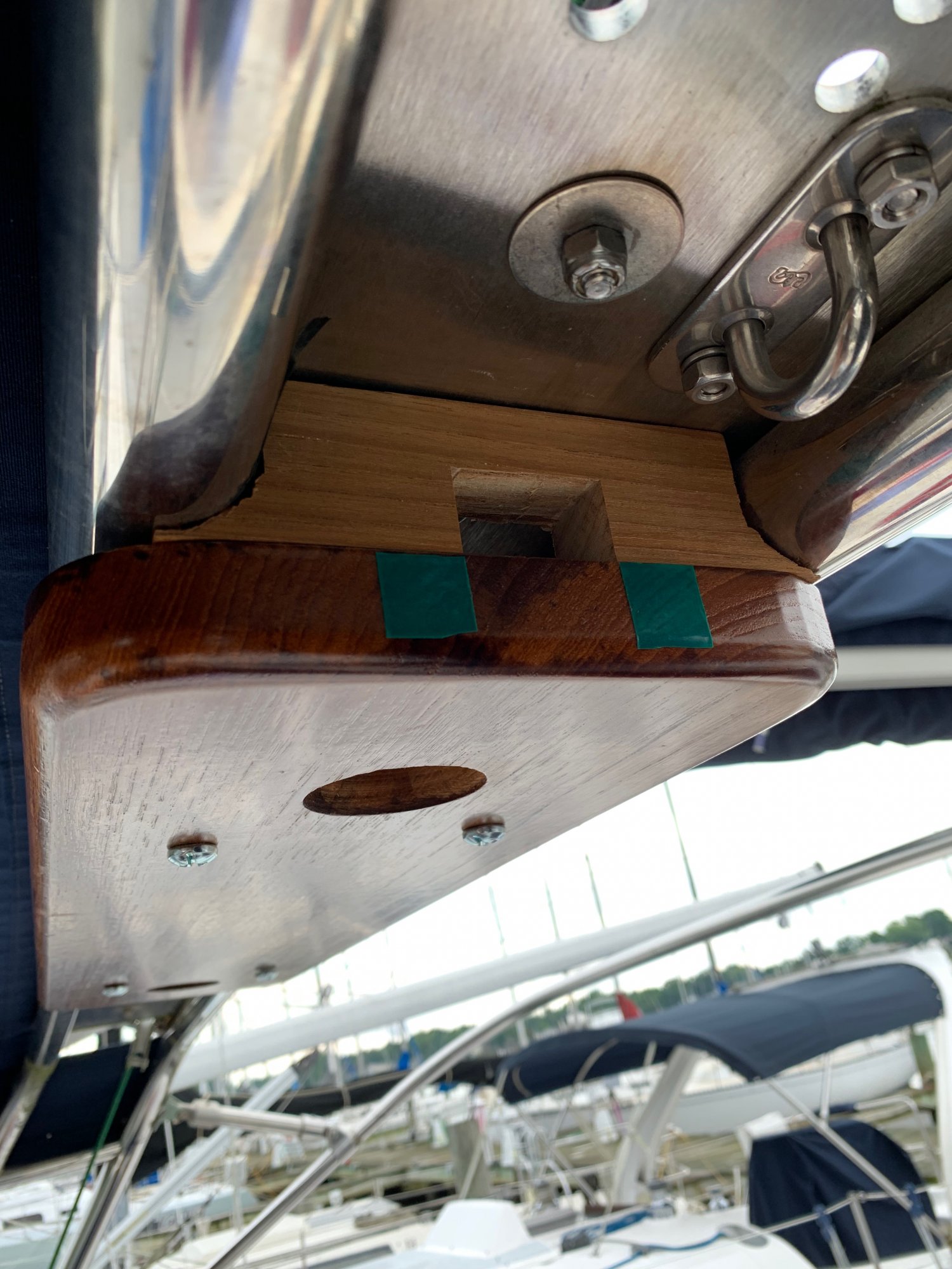

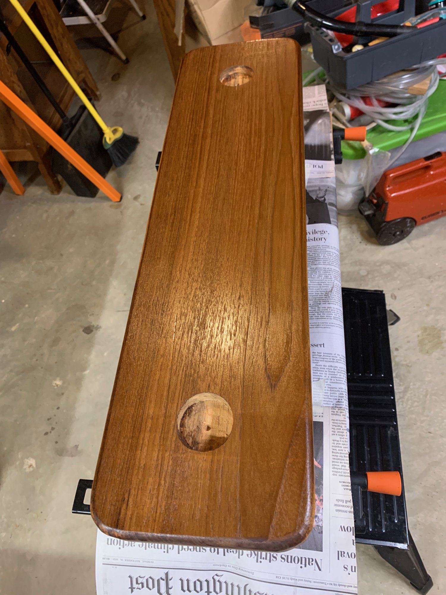

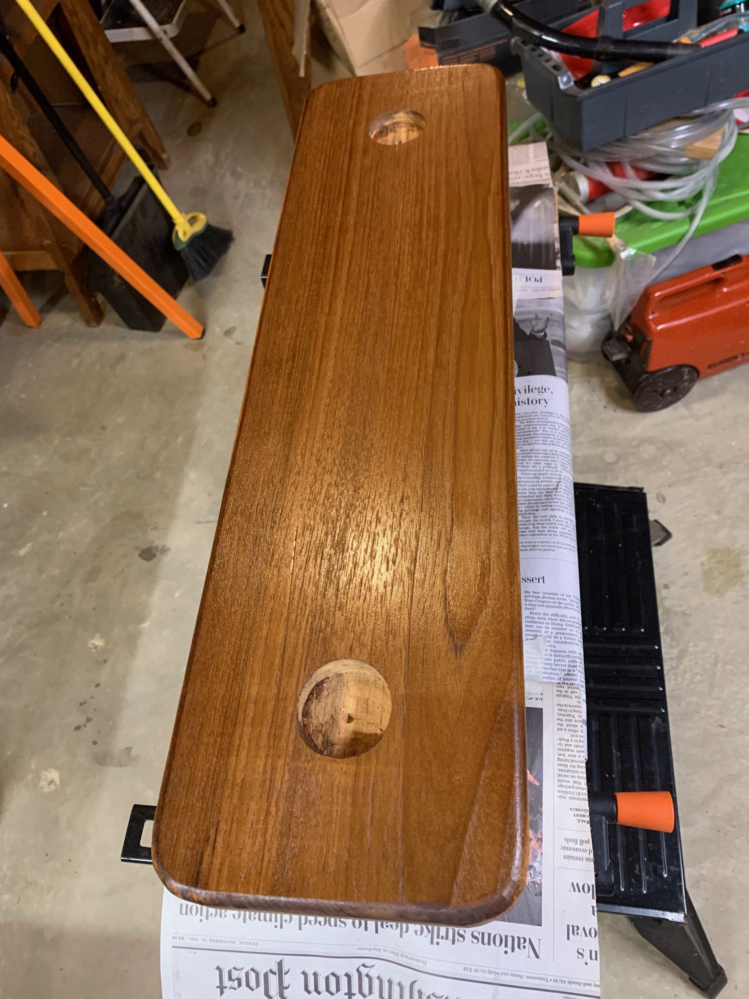

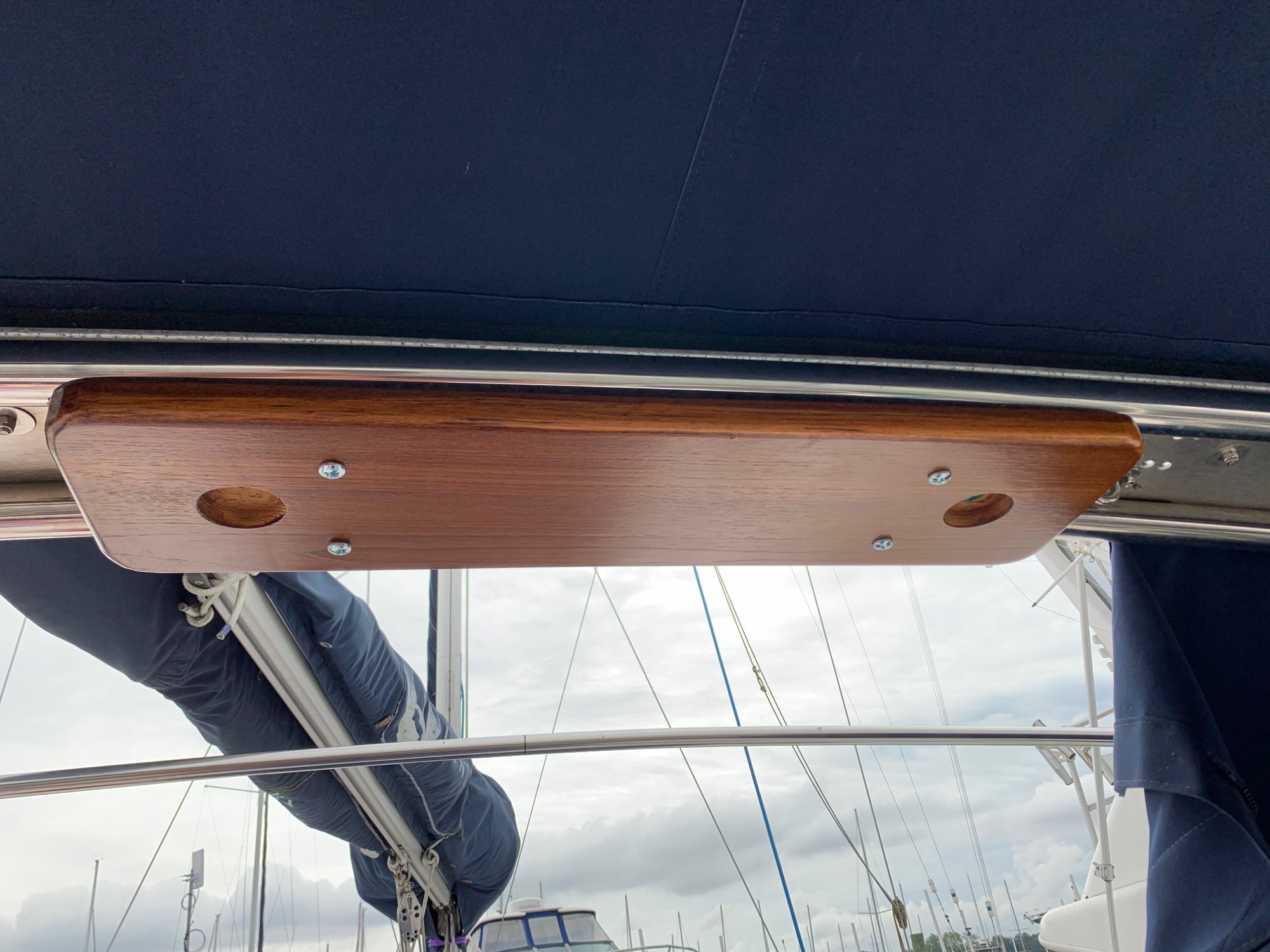

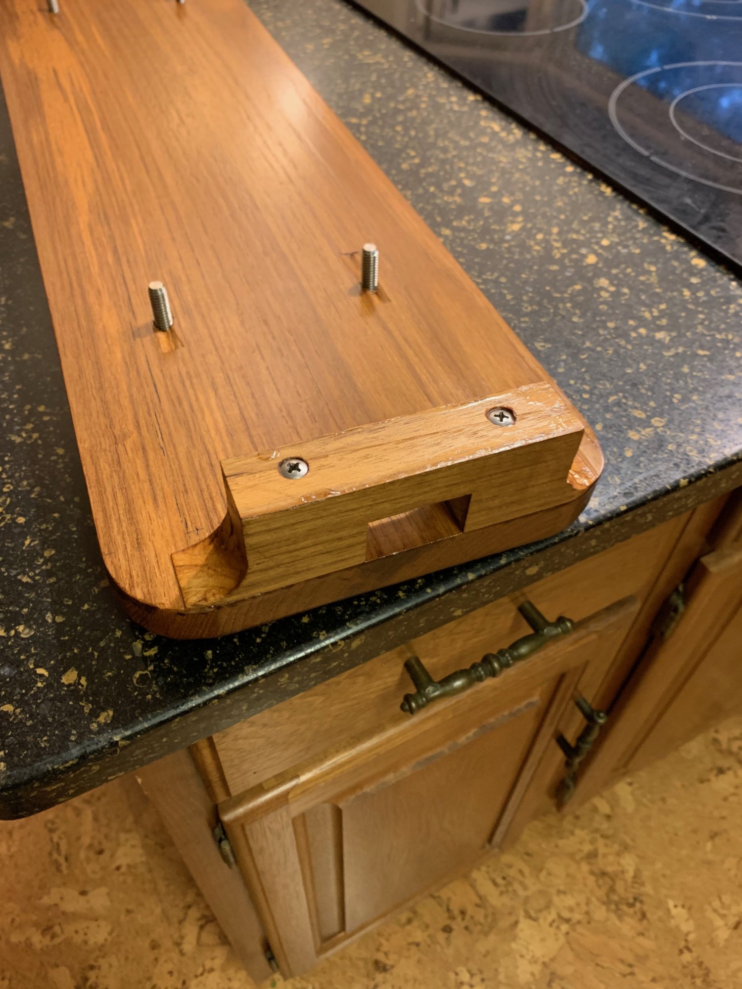

So I bought a couple of hunks of pretty expensive solid teak, just a bit over 1" thick (true), and maybe 8.5" wide and (?) maybe 30" or so long. I think they were maybe $125 each, for inquiring minds. The guy at Exotic Lumber in Annapolis told me that they soon wouldn't be able to import teak at all (no further information on that last bit.) One became a new companionway step, and the other became the new arch console. I rounded over the edge with a router (a first for me), rounded the corners off manually, and sunk 2" holes partway through the board for the lights:

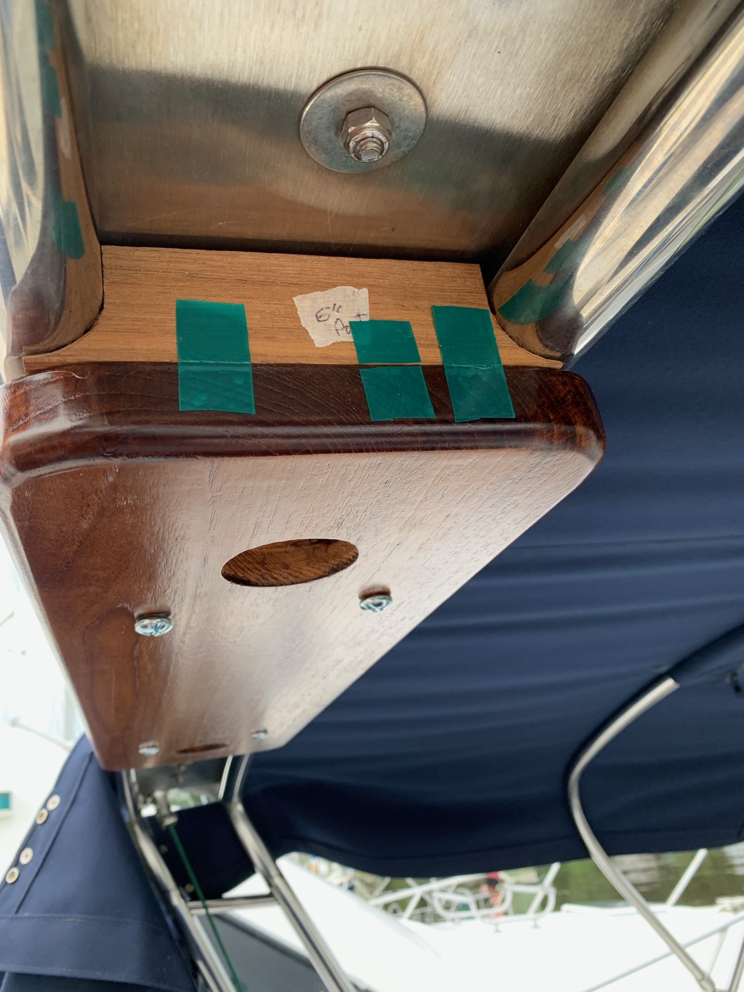

This is with a couple of coats of oil based Minwax Spar Urethane. After trial fitting to the arch, I fit the end-pieces, to keep the birds out (a huge problem with the old console):

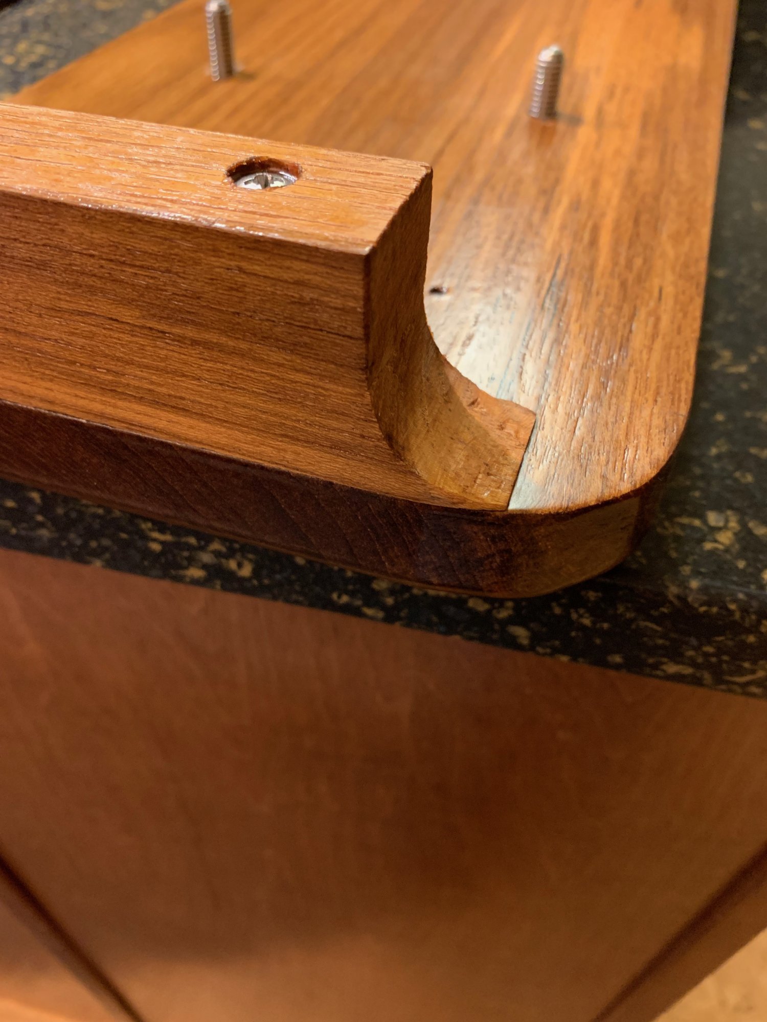

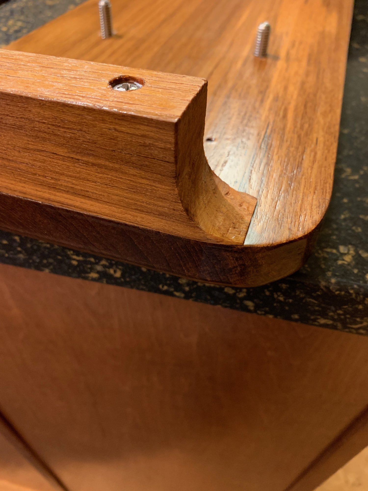

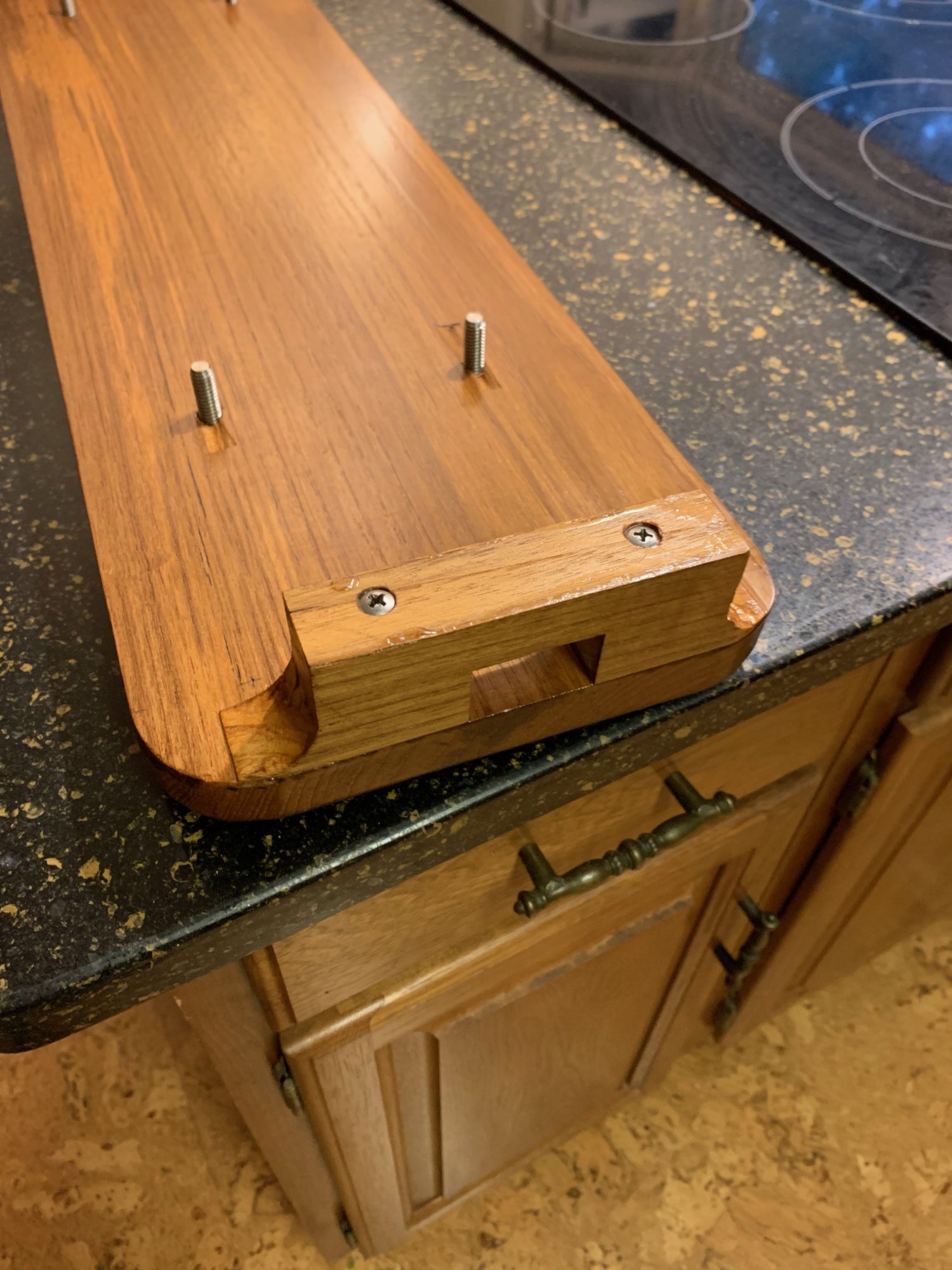

and then attached them permanently and sealed with spar urethane:

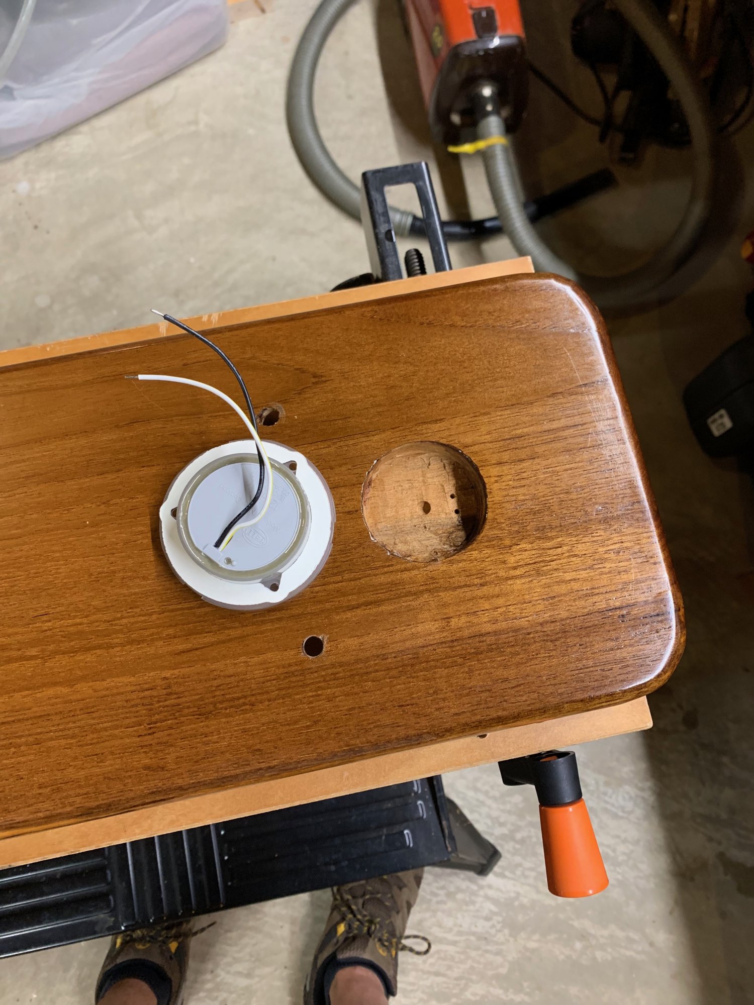

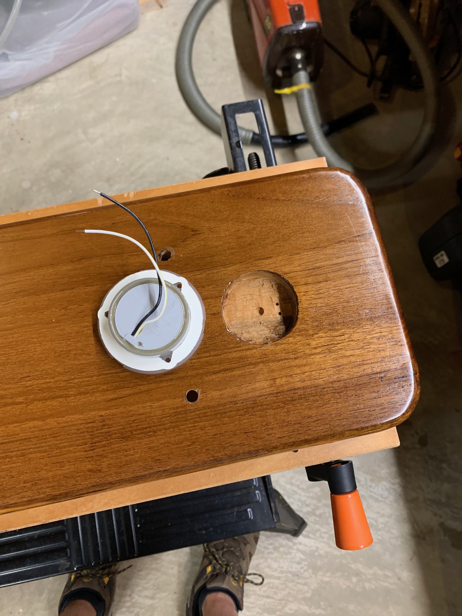

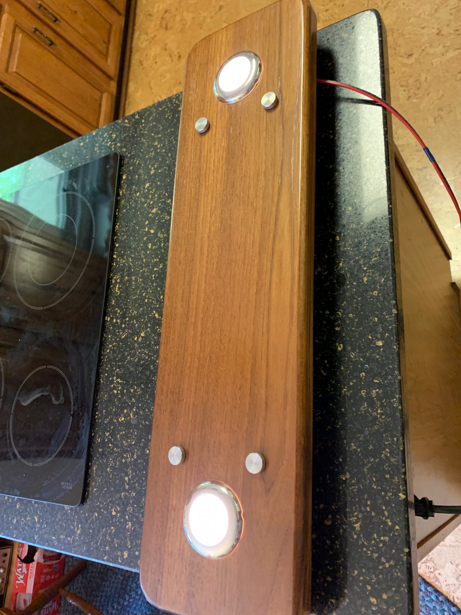

Here are the Hella Courtesy Lamps (back side), which look to be mostly waterproof (IP67) and a pretty standard insert diameter (2") for purposes of future proofing:

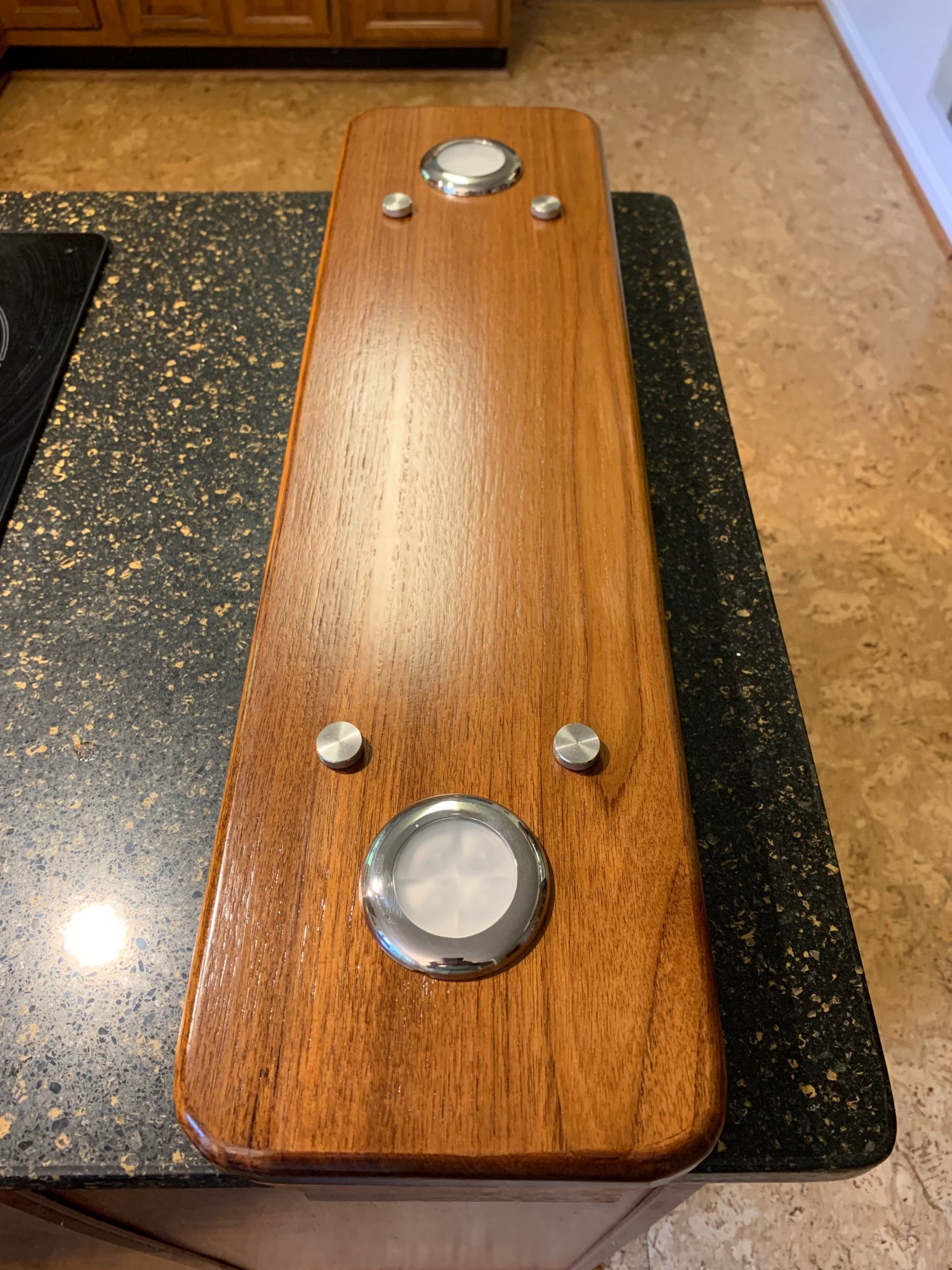

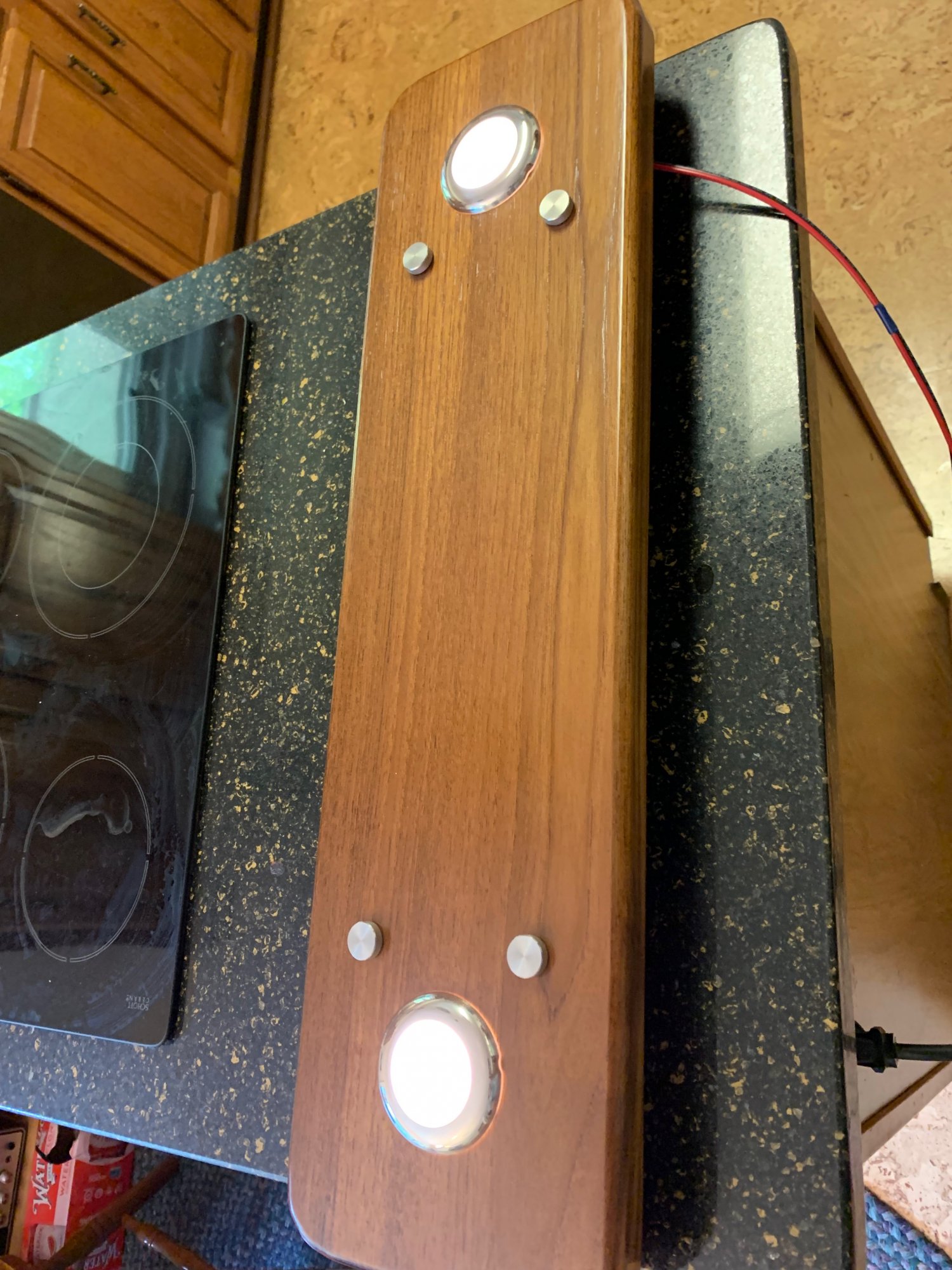

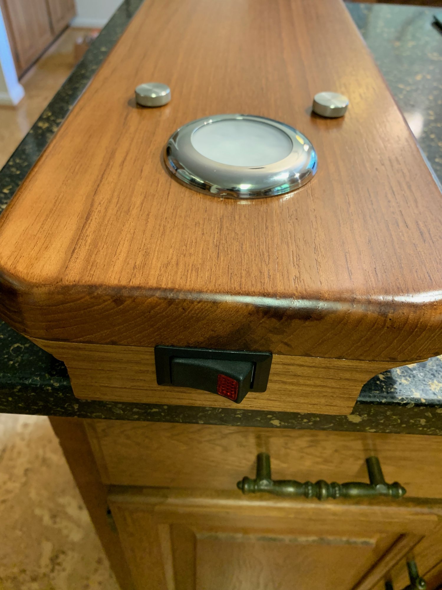

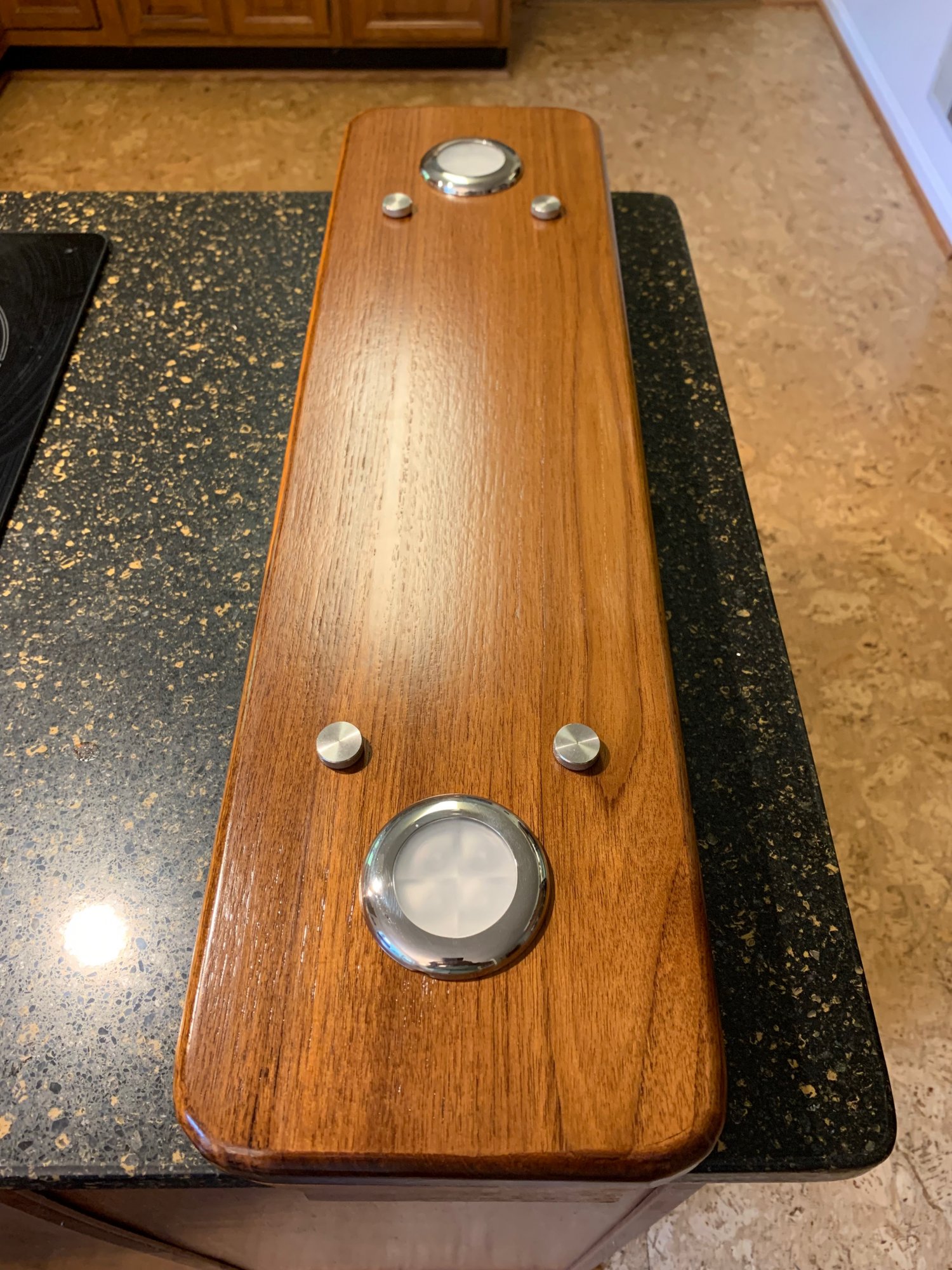

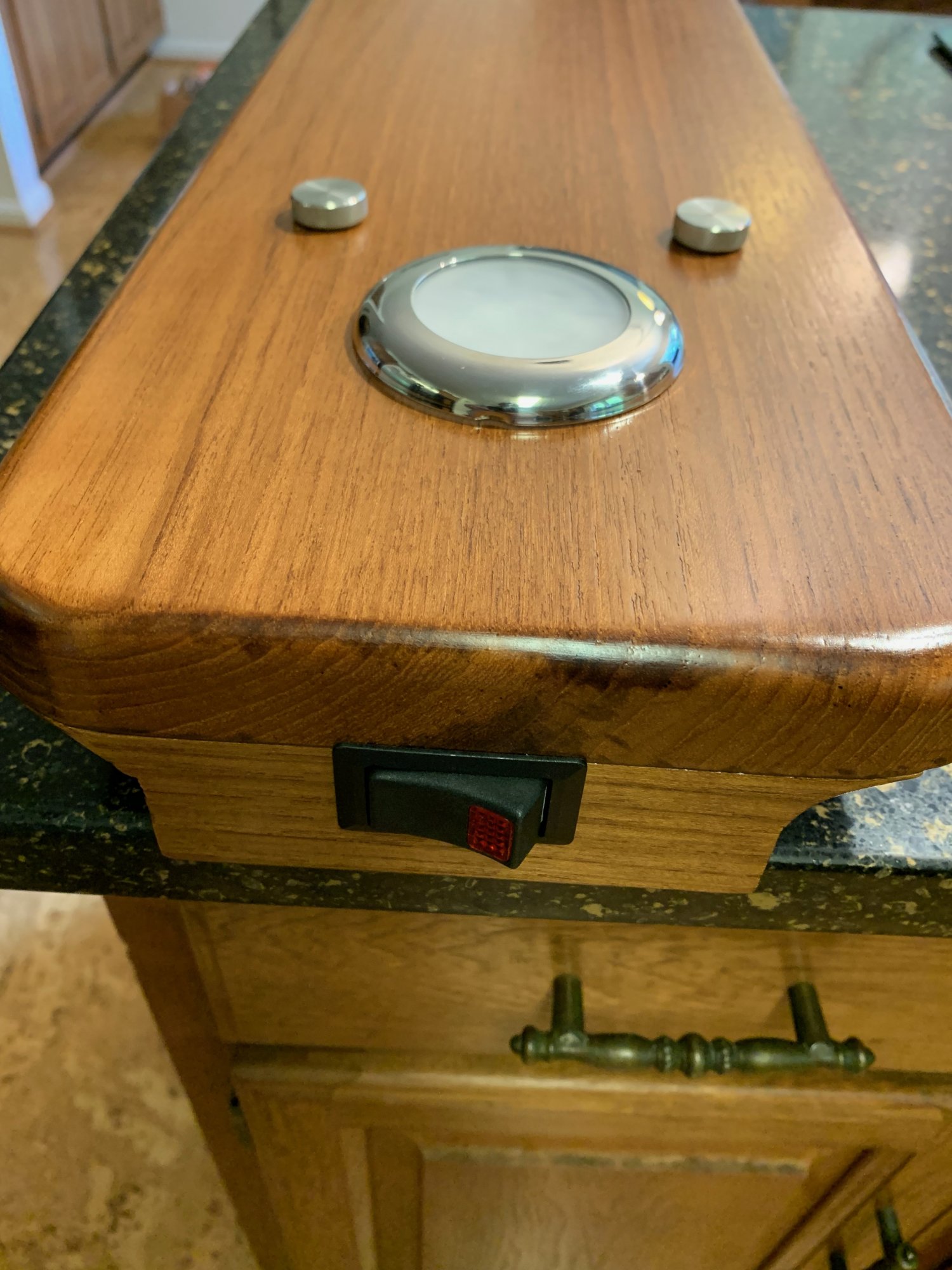

I chose the courtesy lamps because they were a bit less bright than their EuroLED lights. They have a 216 stainless bezel, which I hope will hold up. I had been planning to mount them with regular phillips head screws (as you see in the previous posting), before a family member pointed out how fugly this looked. I managed to find some stupidly expensive stainless thumb screws on McMaster-Carr which looked somewhat better. Here's the finished product (not on the boat yet):
and a light-check:
