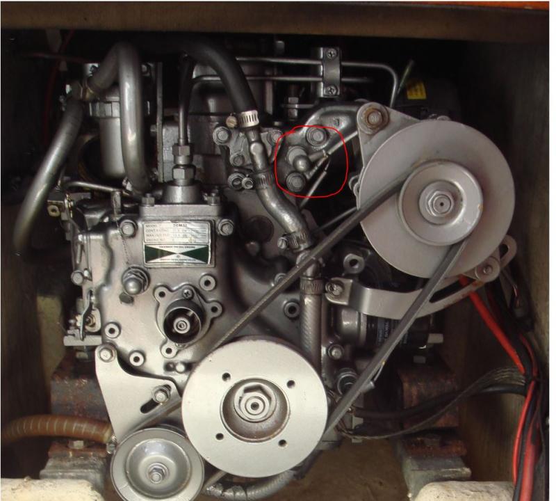

Thanks Bill. Yes, it sounds much weaker than the start alarm. I'm not quite sure where the temp sending unit is located on the engine. Another member, Steve Dion sent me a picture but either I'm worse than I think or my engine is different. i have a 2GM20F engine in the boat. The CW light flashes on and off. Not with any steady patern. I'm thinking along the same lines. That its an electrical issue. If only I can find that sending unit I can begine the troubleshooting process. Thanks!

Steve has it correctly circled. It may be that the "cap" on the wire is gone so it looks different, but that's where it is. All the wiring between the engine and the cockpit instrument panel runs into the starboard locker and then through the wall between the locker and the aft berth, and under the pedestal to the panel. If the temp sender wire is shorting, it is most likely to be in the engine compartment or at the cockpit panel. The H31 was not handsomely wired and was very short on shrink tubing.

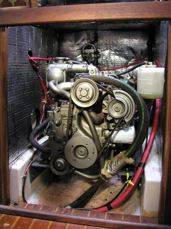

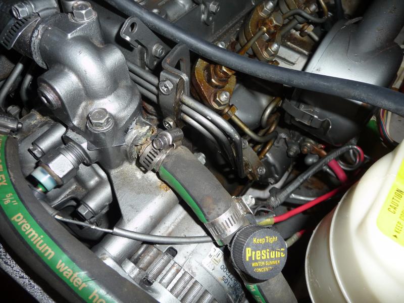

Temp switch, 2 GMF
Morich, on your 2GMF, the switch is just below the thermostat housing, probably just aft of the hoses that go to the water heater. These pictures are of a 3 GMF, but the front of your engine looks pretty much the same. The switch is behind the top most belt pulley and kinda hidden behind the hose with the green stripe on my engine.
