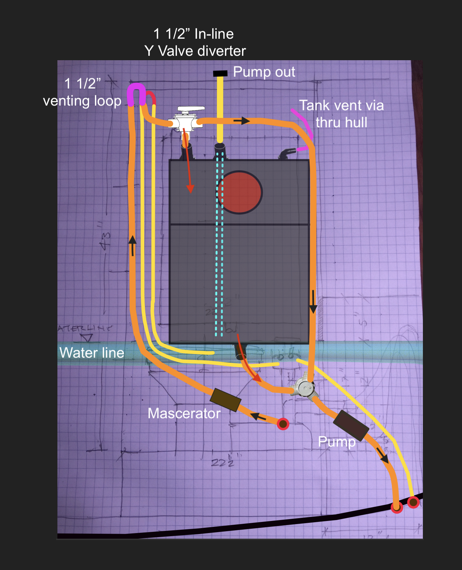

I am thinking of fitting a holding tank to my small Mirage 27as per this layout (theres not the room in the bow for a tank and so Im looking at a bulkhead solution). The bottom of the tank would be roughly level with the water line and Ive tried to make the runs (no pun intended!) as smooth as possible.
Any thoughts and observations welcome.

Some quick thoughts.
This will be a gravity drain tank. Keep it simple. There is no need for a direct discharge, just open the the drain to the tank. Gravity will do the work. You will need a pumpout for those times you are in a no discharge zone and you will need to have a valve to prevent the gravity drain.
The head pump should be adequate to lift the stuff to the top of the tank, no need for a macerator.

Thanks Dave - its a pretty small capacity holding tank (but not a big boat) ...the thought process was to have a direct discharge as a back up in case of travelling within the 3m zone with a full tank. But its a lot simpler as per your suggestion ...and less things to go wrong. I may have misunderstood your point about a 'valve to prevent the gravity drain'?
14,164
You have a Y valve below the tank, if you remove the direct discharge then the Y Valve can be a simple ball valve.
As for the small holding tank, you'll just need to find a pump out station or take the boat "for a walk" offshore. ;)

Makes sense - I guess as well there'd be no need for a venting loop on the 1 1/2 as there'd be the tank vent through which would do the same job i.e simplified as per this https://www.mirtoart.com/image/I0000KBRZYh79ZtU
14,164
Yes, this is the design you want. Easy, simple, less expensive.
Also, the vented loop in your drawing was in the wrong place, it belongs on the other side of the Y-valve.

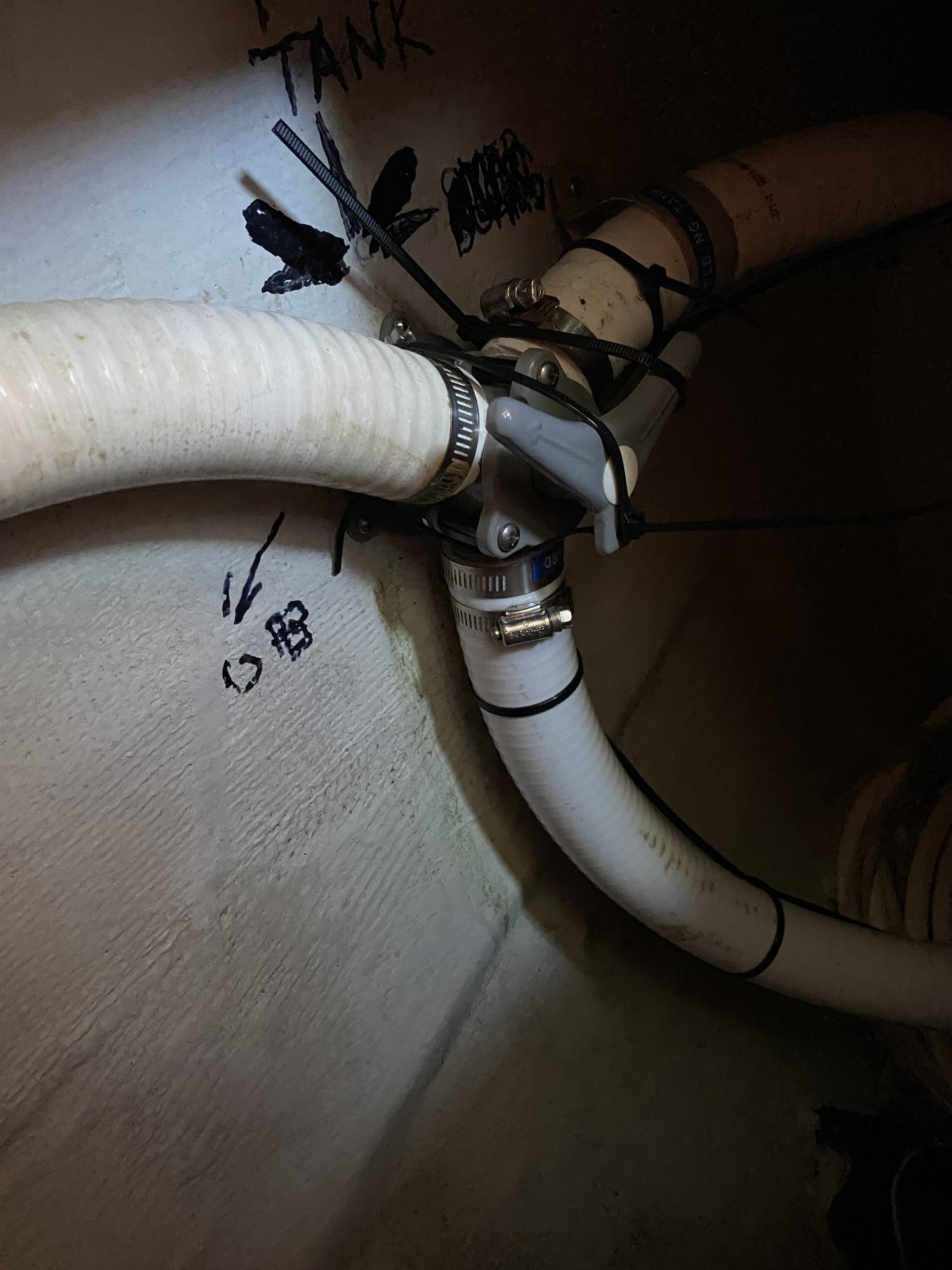

Peggie, thanks again. For the reason you highlight, I’m back on track for installing the Whale sanitation pump. As I plan this out, I wonder if you (or others) can help me through another related question.
The current blackwater plumbing is this:
  • Toilet line to Y valve (a)
  • Y valve lines to b) top of tank; c) thru-hull valve fitting (elbowed)
  • Separate hose from bottom of tank to deck pumpout fitting.
Question: if I install the pump inline between the Y valve and thru-hull, as instructed by Whale, my configuration has it drawing from the top of the tank, which can’t be right. Will I need to install the pump inline with the deck pumpout line to assure proper suction from tank bottom?
Thanks a head
Dec 2, 1997
9,011
- - LIttle Rock
If I'm visualizing this correctly, you have a y-valve in the toilet discharge line that lets you choose between flushing into the tank or flushing directly overboard.
The only discharge line coming out of the tank comes out of it at the bottom and goes to the deck pumpout. You want to add a line that lets you dump the tank at sea and are asking for the best way to do it.
Jumping to the conclusion that I've gotten all this right, here's how I'd do it:
Instead of complicating the system by adding a y-valve to the pumpout line, repurpose the discharge line coming out of the tank at the bottom to serve the "dump out" pump exclusively and install a new discharge fitting in the top of the tank for the pumpout line...actually fairly easy using a Uniseal UNISEAL and a diptube--a length of PVC pipe that will also double as the hose fitting.
IMO, you couldn't ask for a simpler system. I'll be glad to work out the details with you if you want to send me a PM.
