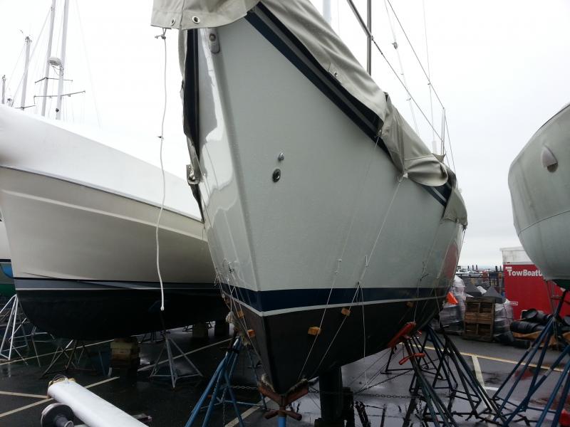

In deciding on the vent I'll go with a 3/4" dia vent mounted on the center line of the new tank. The vent thru hull to replace the one I have (which is the original 1/2" screened fuel vent style) will be a groco 3/4" SS model mounted near the bow. Is there any issues with using SS or would marelon on or plastic be better? Not sure if one might be corrosive with gasses.
