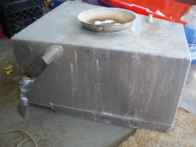

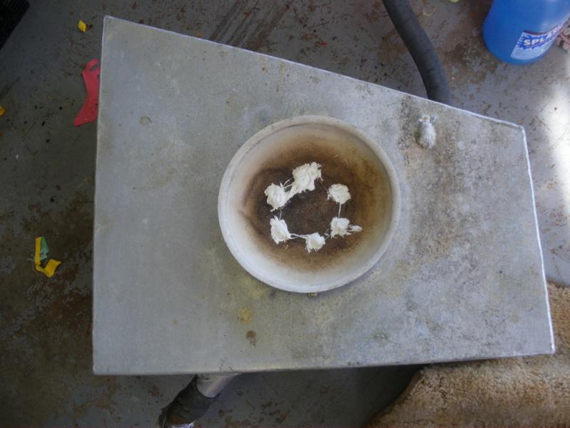

Old Tank...
The tank had a hole in it and the vent was broken/clogged--? I don't know the details on that part. The survey revealed the tank problems; there wasn't a hole in it at that point, but it was just about there. We were hoping it would last through the season. It made it up to mid-August before a repair became necessary. You can see the classy and functional repair job that my husband performed on a hot, humid, 90-degree day out on the mooring. A good time to be the First Mate and not the Captain!
It's not clear from the picture what's going on here. I see what appears to be some sort of bowl or pan that has been attached where the level sender would go, and a short length of really bad waste hose with some duct tape on it. If the tank itself is sound, I think you'd be way ahead of the curve by just fixing the tank by putting in a new vent connection and installing a new WEMA holding tank sending unit. And new hose of course. If there's a hole somewhere else in the tank, you might be able to get another five years or more out of it by cutting an access hole in the top of the tank, thoroughly cleaning the interior, and then painting it out inside with several layers of epoxy and maybe some fabric where the hole is. Install a Seabuilt access plate in the hole when you're done.

The tank had a big hole on the top and had more signs of corrosion on the bottom; even the surveyor said it had to go. We are going to replace all the hoses--hence the hose attached in the photo. I looked at the Ronco catalog and there are six 30 gallon rectangular tanks. Hopefully one of those will work.
The tarp is coming off the boat this weekend so we'll get some measurements and then perhaps make a mock-up with some cardboard if necessary. We plan to keep the boat for another 8-10 years so it would be great to just have this taken care of once and for all. We do have a local welder who could make a new metal tank, as you previously suggested. That would probably last long enough that it would be a problem for the next owner! My husband replaced the hoses, head and tank on our last boat.
