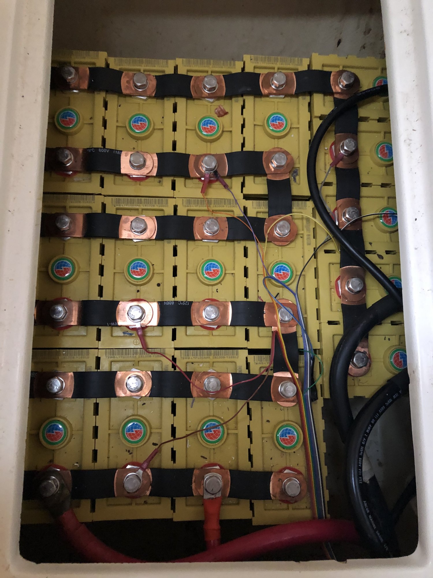

The posting list the house bank as 400AH lith. From the photo it appears that you have the makings for a 5P4S bank with 20 80 AH prismatic cells. I say "makings" because they are not connected other then by the 3 bus straps that are lying on top of the contacts but not bolted down. Has this bank ever been installed with top-balancing and a proper BMS (battery management system)? This can be a fantastic house bank but it needs to be set up correctly. one very good place to start is the "LiFePO4 Lithium Technical Discussions for Yachts" facebook group. There are a bunch of good guys that are very knowledgeable in setting these systems up.

You’re speaking Chinese for the most part to me. I can follow regular solar stuff that’s non lithium. I know little about lithium except they’re more expensive and in my opinion, better overall than a regular fla bank. The owner did the work and he’s just a normal guy like myself. I’ll check into the above mentioned lithium site.
Thanks, you probly saved me multiple issues.

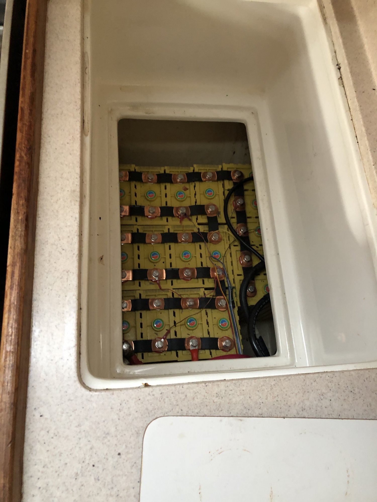

I just went back and looked at the pic you saw. I believe that’s before installation. I’ll see if I can post a pic I took of the bank installed under the galley aft countertop.

That is a bank. The photo in the posting was just a bunch of cells. It appears that this bank has 4 fewer cells than what was shown in the listing. I only can see 16 in the installed bank but there were 4 rows of 5 cells in the listing. For easy math lets say each cell is 100AH with a nominal voltage of 3.2V. There are two ways to wire (16) cells to create a 12v battery. In your installation, you have four 100AH, 3.2V cells in parallel which adds the capacity of each individual cell but the voltage remains the same, ie, 100x4= 400AH @ 3.2v. Then those groups of four were connected in series to add the voltage of each group but the capacity remains the same, ie, 3.2v x 4 = 12.8V at 400AH. You can also go the other why and make the series connection first to get 100 AH @ 12.6v then parallel to get 400AH @ 12.6v. The small wires connected to each group of 4 cells is most likely the BMS which is a critical component. The biggest thing that I see missing is any form of clamping. this is needed to prevent the cells from expanding or swelling under large current loads or charging. The Facebook group can give you much more detailed info.

Thanks for catching that. I’m assuming maybe the other four are somewhere else. I took that pic last Friday.

it appears the bank is not secured. if you were to get knocked down this could be a major problem. Also, best practice with prismatic cells is to have them held against expansion. Typically this is done with aluminum plates and threaded rod. It does not appear to be the case with your cells.
My advice is to read the article on lithium batteries on Marine How To.
