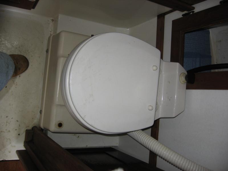

It's time to replace the head on my 78 h27. There was an old self contained Sealand Traveller type head when I bought the boat that leaked so I replaced it with a Porta Potti that lasted a couple of years. There is no holding tank on the boat and I can't see a good place to put a rigid tank. I'm looking at the Sealand Traveller unit and the Thetford Curve that I just found. Besides the size difference are their any opinions or ideas you have for which one to use. Most sailing is day sails with some 4-6 day sails thrown in. Thanks for your help.

The curve looks nice but does it come with MSD?.
10,257
MSD = Marine Sanitation Device.. required by Coast Guard in US.. I suspect similar laws in Canada
The Traveler requires a holding tank so unless ya install one somewhere (or use the tank that is there under it now) , that's out.. The Curve is self contained.. a fancy porta pottie, basically. Parts for rebuild are generally available.. so you could rebuild the existing SeaLand ..

Got it. As far the rules go I think it's the same in Canada. The tank on my old one was rotten and the base was cracked so it went to the dump. My wife says a Porta Potti is out so I guess the Sealand it is.

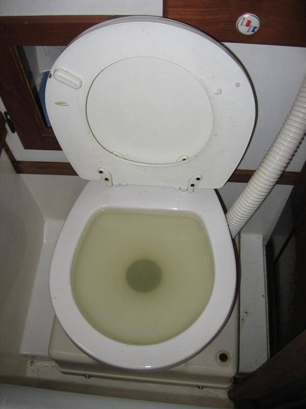

just curious, what's the reason for sharing a full toilet with us? could not pump out ?? Thanks for sharing :redface:
Feb 17, 2013
6
Hunter h27 Gimli, Manitoba
LuzSD, that was a surprise. I pumped the head and put the boat up on the trailer for the winter. When I returned from lunch the bowl was full and I couldn't figure it out, until I realized that the trailer hitch was just high enough that water was siphoning out of the water tank into the toilet. Always learn something when I go to the boat, even when it's pulled out for the winter. :)
