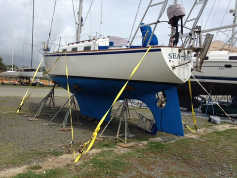

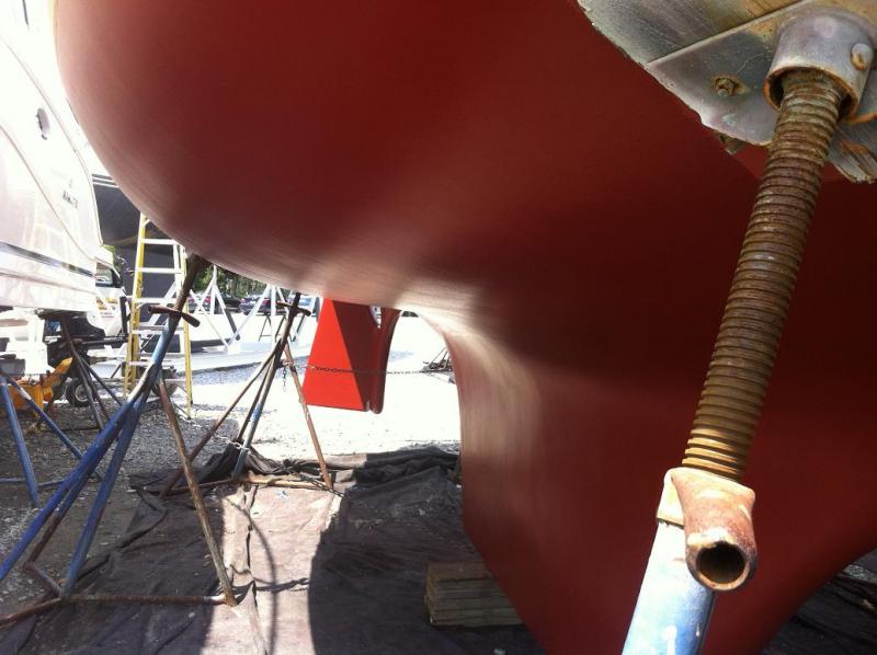

Oct 9, 2008
1,742
Bristol 29.9 Dana Point
Actually that's a terrible angle. But it's the only bottom pic I have on this phone.
Here's a sister ship. Same rudder and prop config.
