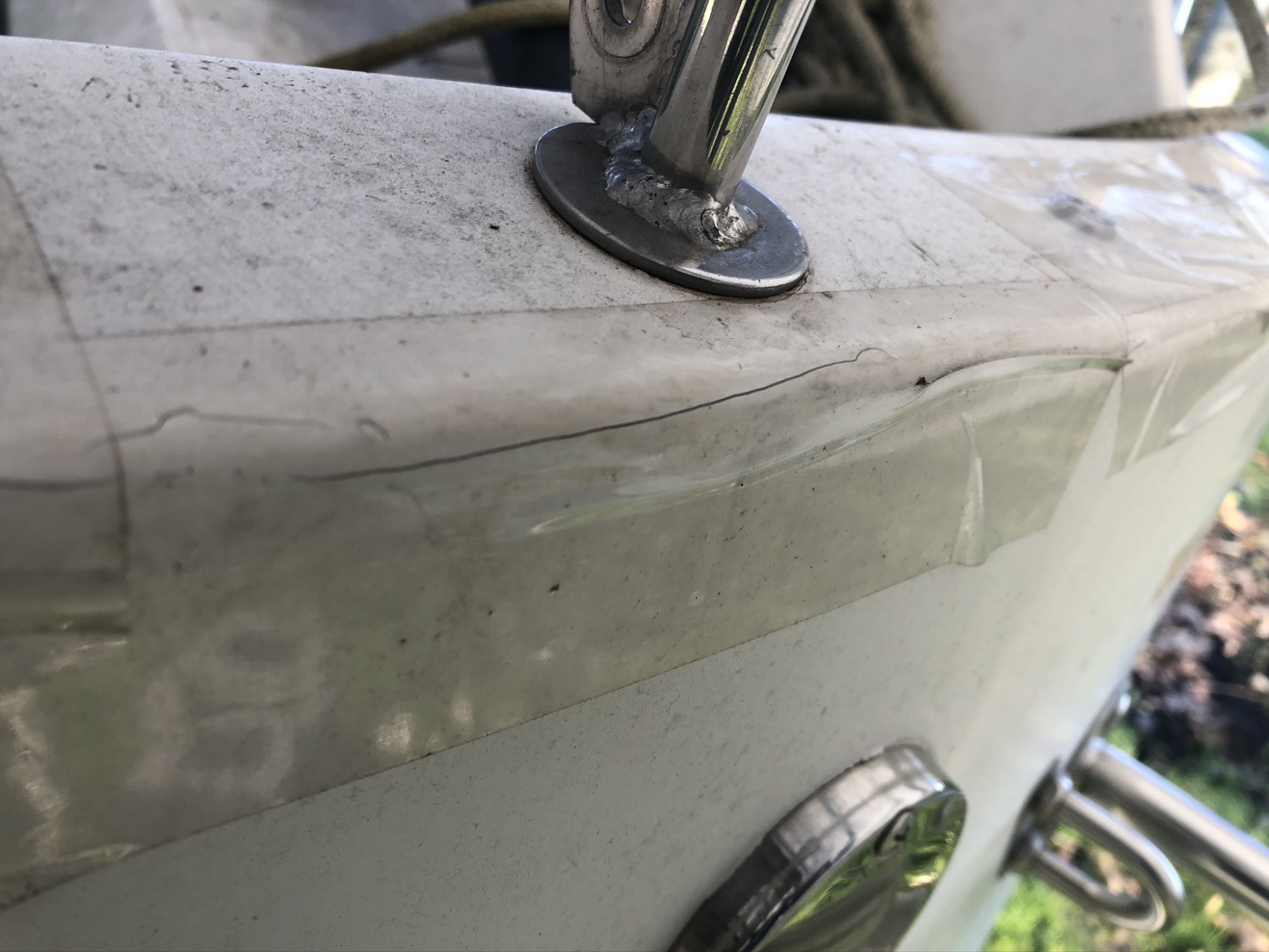

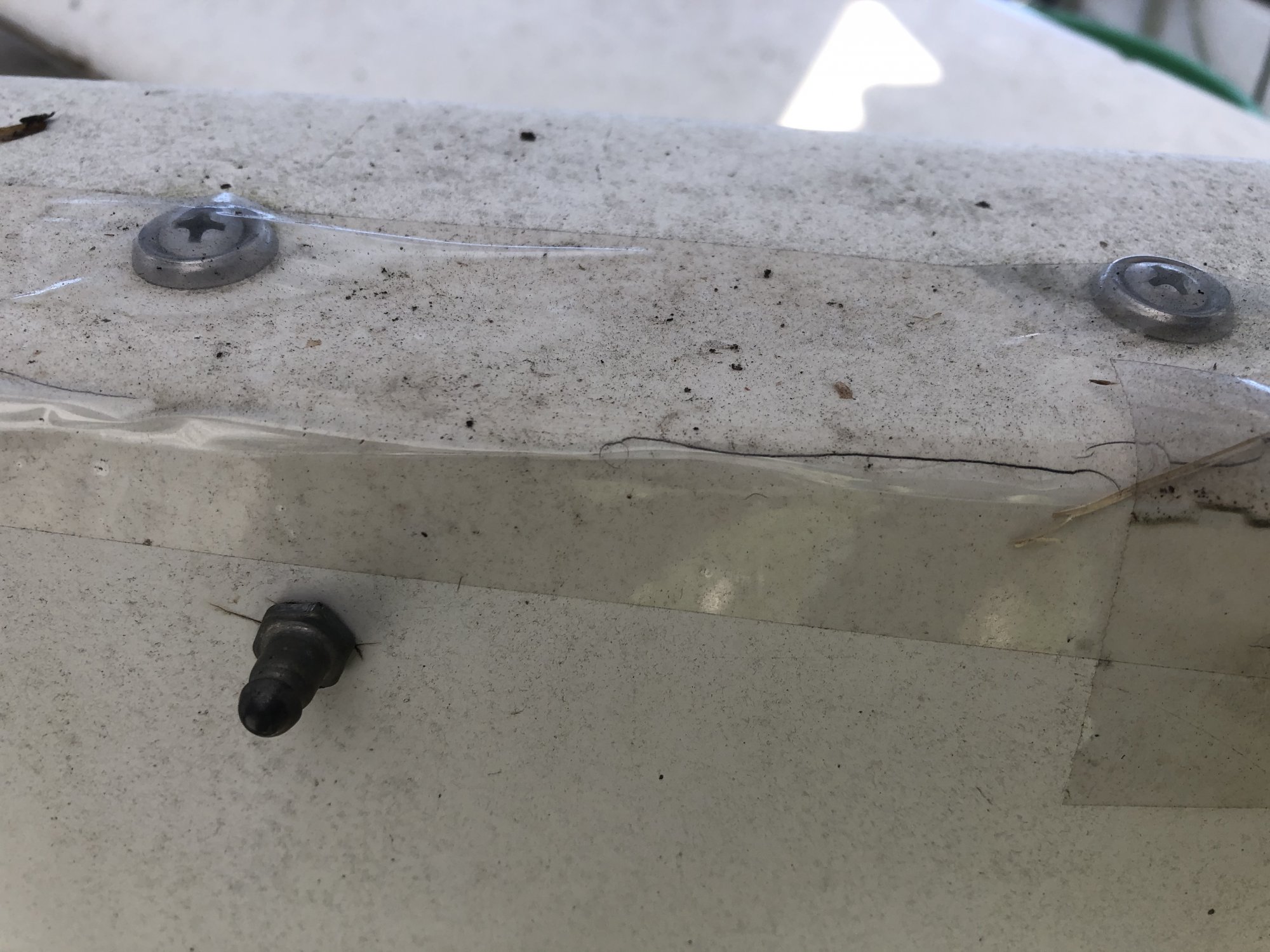

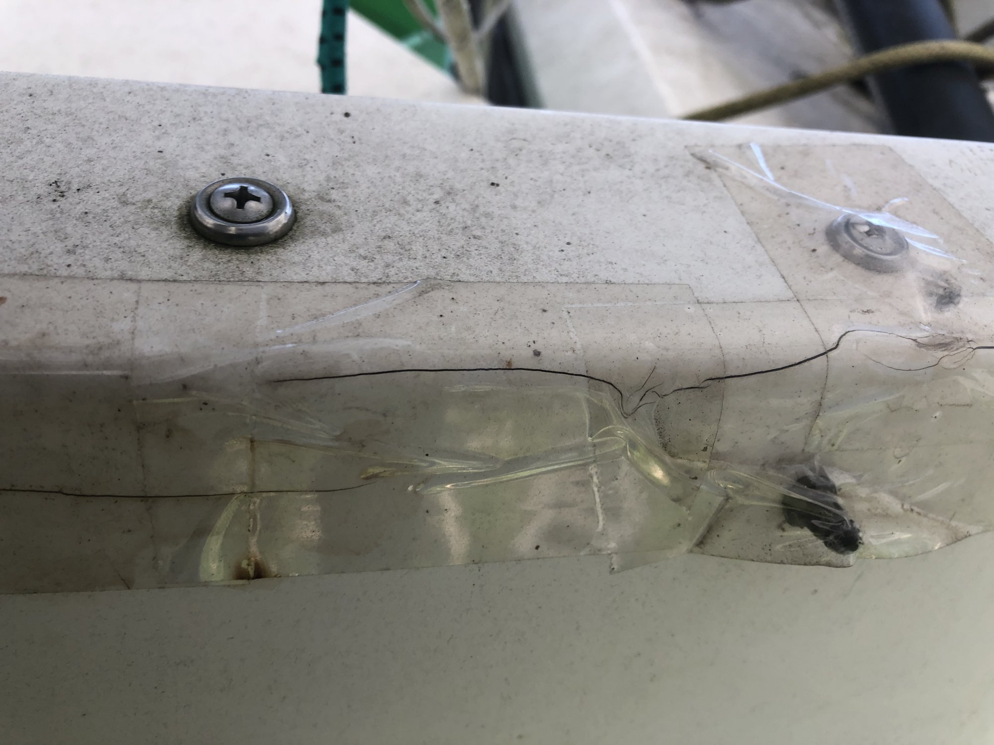

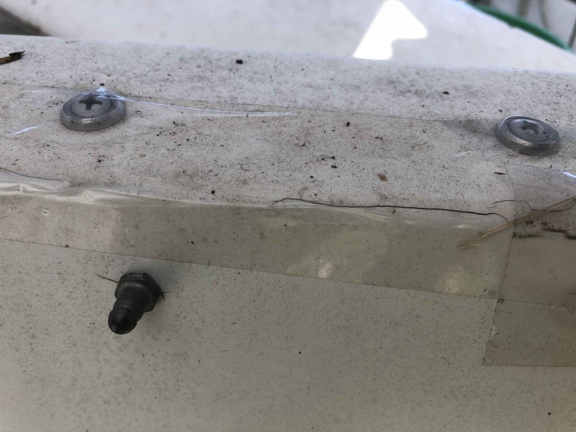

Well, you may not like this answer. The crack is either no big deal or it's huge.
Going with the "no big deal" route first. The crack is on a tight radius. One common problem with fiberglass is trying to lay up glass on a tight radius. The deck is built by first spraying gelcoat into a mould and then laying up fiberglass on top of the gelcoat. With a tight radius, like you show in the photos, it is difficult to get the fiberglass cloth to conform to the radius. The glass pulls away from the mould and gelcoat leaving a void. Sooner or later the gelcoat cracks because it is unsupported by the glass. Gelcoat (and resins without glass or fillers) is really brittle, it breaks easily. This is not a structural issue.
The next step is to remove some of the cracked gelcoat. If you see a void and solid glass laminate beneath the void, you're in a good place. Just remove the gelcoat, chip it out and sand. Rebuild the area with thickened epoxy and paint or gel coat over it. Or use a good marine quality polyester resin filler and gelcoat over the top.
If the laminate is cracked, well, that might be a big repair. It is a structural issue. :(
While you're messing around with gelcoat, what are those screws for? It might be worthwhile to remove them and fill the holes.

The transom looks like it gets a good deal of abuse with the boarding ladder and outboard right there. The extent of the cracks, as dlochner says, makes it look like surgery may be necessary. I would be suspicious that perhaps something hit the stern and pushed it in to make it crack like that, but we don’t know. The thing to do is to explore the crack and open it up to see what’s going on in there. It could just be a crack in the gelcoat, as dlochner says, and simply need filling with epoxygoop with a gelcoat cap to match the color.
If it goes in beyond that, into the laminate, there will be more to do, and that depends upon how the transom was built. If the transom isn’t cored, the crack, if it’s in the laminate, will need to be exposed along its whole length ( a disc sander is useful for this) and new fiberglass cloth and possibly roving will need to be resined over it to make the repair. Gelcoat can go over it when it has set and been sanded smooth. If there is any coring (we don’t know how this transom is built- there may be plywood or balsa coring, or there may not be any) exposed by the crack, it has probably gotten wet and may be delaminated or rotted. The fixes for this depend a lot on how bad it is. If it is really bad, with rotten core leaving an empty space instead of connecting the inner and outer laminates, it will need to be replaced. This means opening up the whole affected area back to solid core and re-doing it. If the core is simply damp, but not delaminated, people sometimes drill holes to help dry things out with fans and heat and then inject epoxygoop into the holes to hopefully stick it back together and keep it from getting worse. (It’s not the best but may be quick and sufficient.) Essentially, you need to take a look and find out. Good luck!

My Starwind had a similar crack in the transom. Other sailors said it wasnt an issue. As far as I know water never leaked into the hull.
