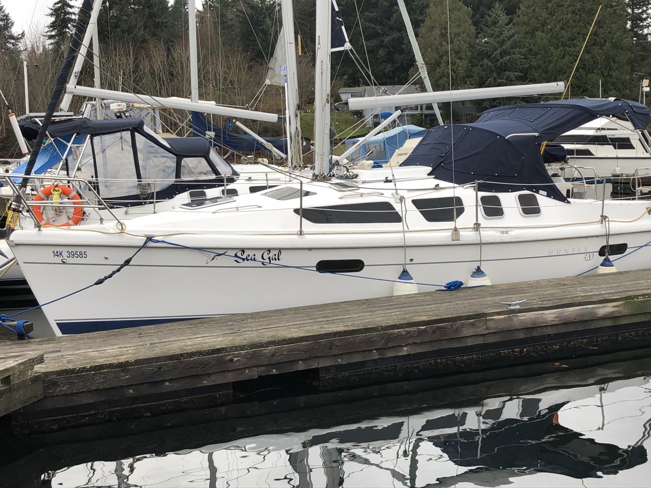

Here's a pic, I'll figure out how to upload more when I have time.

She even has the name of a mistress. Beautiful. You're a lucky guy.
