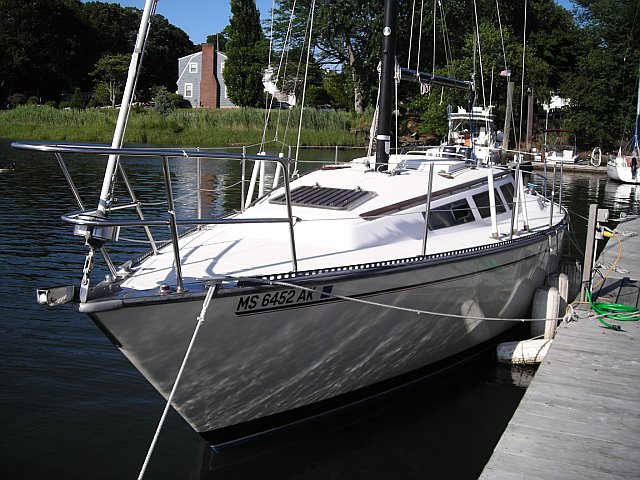

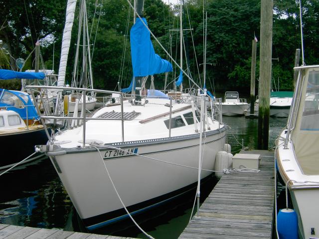

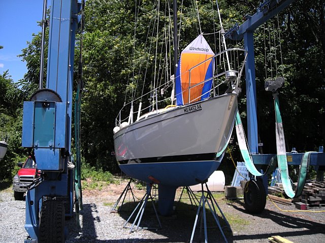

I have posted two photos that are quite similar. One is from the previous owner in which it appears that there is no poliglow on the boat yet (sticker on hull says 05). Note that the stripes are all intact still too. The second is the summer of 2008, a few days after poliglow was applied. In particular, look at the reflection of the bollards against the middle of the hull. The third photo on stands gives you another look at the shine.
