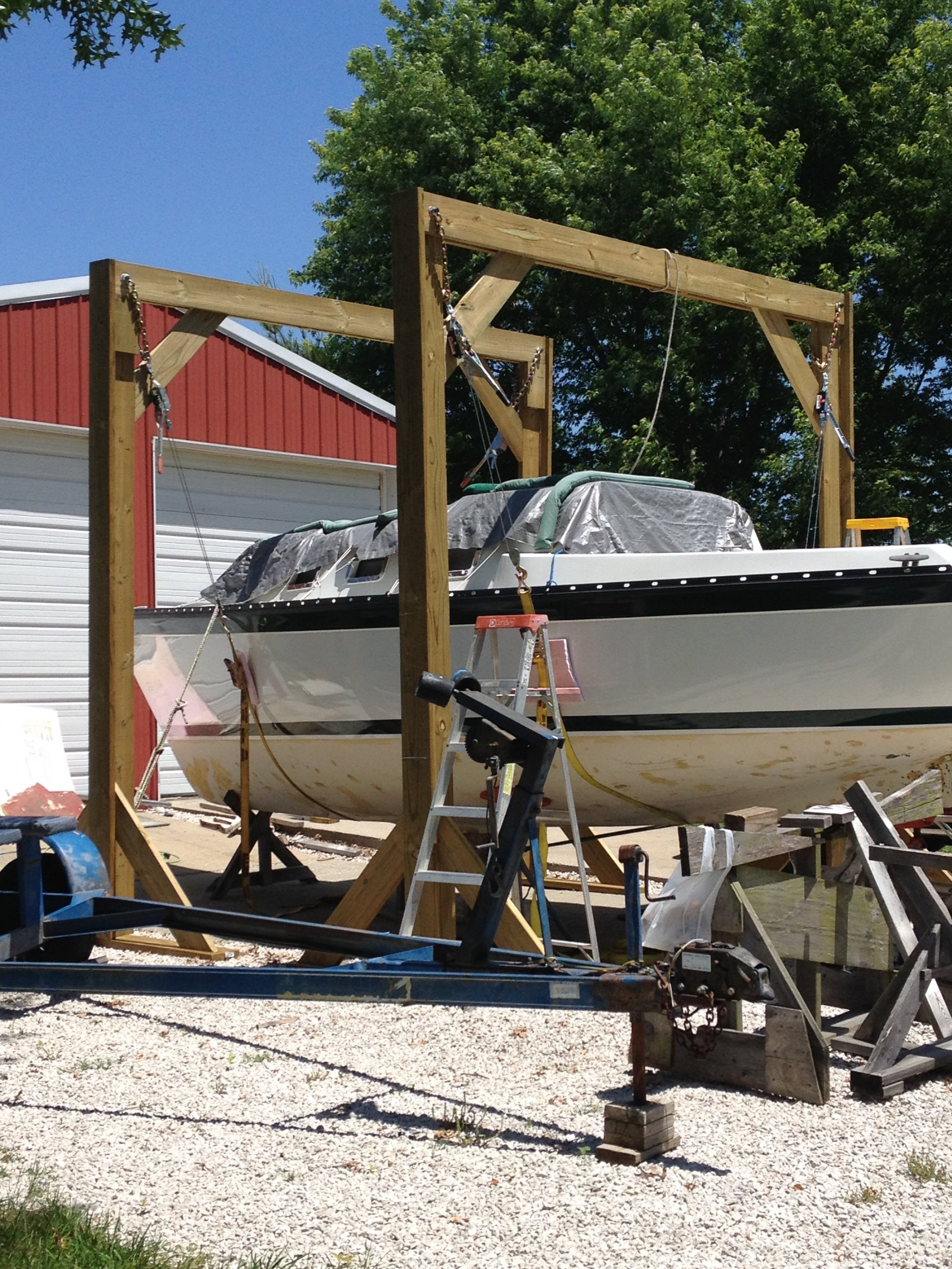

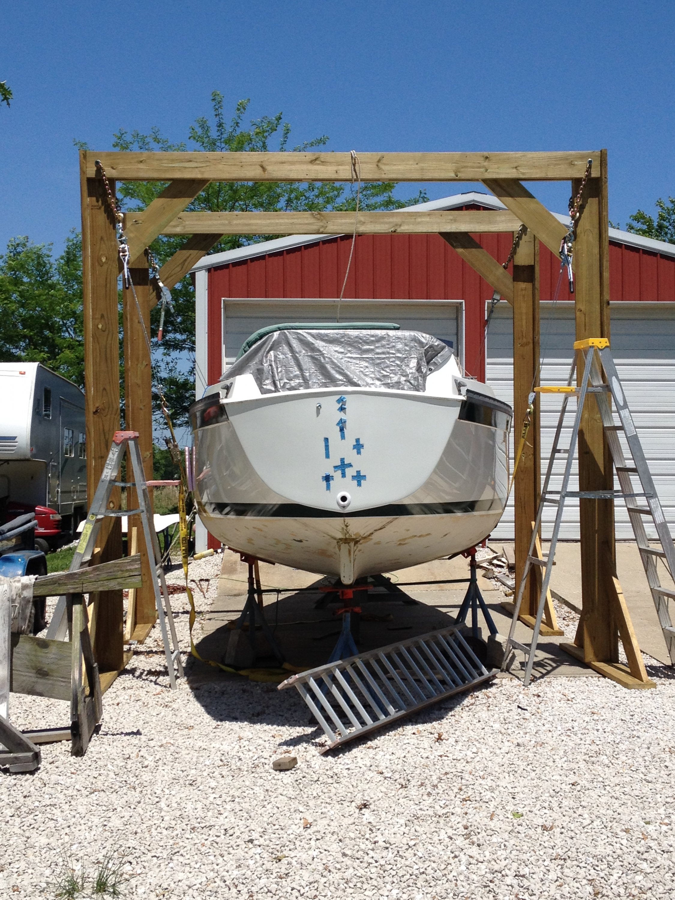

Just finished building my new gantries. Almost time to get the keel back under her. image.jpegimage.jpeg
1,099
Nice. Now, if you had a waterfront lot and a slip, you could dry-sail your boat!
Seriously though, good job. No plans for fore & aft bracing between the gantries?
Jim,
Each gantry has a 6' leg with diagonal supports on each side. I may brace between them when lifting with the keel back on to get it on a trailer. Thanks
