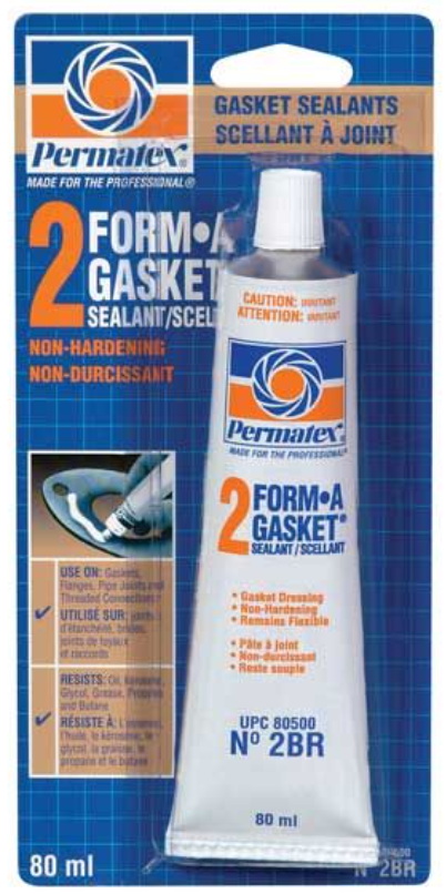

Brilliant use of Starboard as it's impervious. Rather than a solid gasket, I have found Permatex the only sealant that sticks to poly like :poop: to a blanket:
Nothing else will stick to poly.
