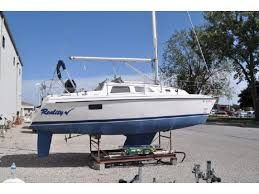

If you are not going to trailer the boat and if you lake has deep water, you may find that you prefer to stay away from the swing keel and/or water ballast boats and go with a more traditional fixed keel boat. They sail better and are more comfortable under sail. If that is the case the only boats on the list I gave above is the Hunter 270 and the fixed keel version of the Catalina 250. The Hunter 270 is essentially the same as the 260 but with a fixed shoal draft wing keel.
But some other boats with walk-off transoms under 29' (that are not water ballast swing keels to consider) are

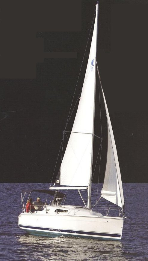

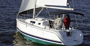

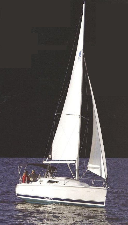

The Hunter 25
The Hunter 27
The Hunter 27-2
The Hunter 27-3
And then Hunter 28, 28.5 and 290

If it were me and this was my list of priorities in the lake you are looking to sail in..., I think I'd look for a fixed keel boat with less than 4.5' of draft. But every decision is a trade-off.
I like to trailer to new places so the water ballast is helpful... and I like to explore estuaries that are often shoal so the swing keel is also a plus... but I give up some stability and comfort under sail.

Since Flathead is so (relatively) small is the fixed vs swing keel that significant of an issue?
If your swing keel is also your ballast, then the only real difference is the swing keel is one more system to maintain. and the pivot bolt will need regular replacement of the gasket or you will have a wet bilge after sailing. And the keel winch is usually in the way. If you have a swing keel water-ballast boat then there are real differences in performance. The water ballast boats have little (no) righting force when they are sitting flat and need to heel before you get any righting effect from the ballast. The righting effect increases with heel so at first they seem like they want to tip over and even at anchor they are very tipsy. But once you get to about 7 degrees of heel they stiffen up and feel "normal". My H26 is rather fast in a light breeze and I will do 4 kts in a 6 kts breeze but I seldom get her above 5.9 kts unless I'm really pushing her but I have seen 6.5 once. The H26 also points surprisingly well. I am also starting to reef at 15 mph wind and in a fixed ballast boat of similar size and with proper trim I'd probably push that to 20. On the other hand, when lake sailing you are usually in the 10 mph breeze range so ....
I guess the key to making a good choice is to accept that every design decision is a compramise. Decide how you want to sail and where you want to sail bla bla bla. I think you already presented a good list of priorities. You may not care if it is swing or fixed and/water ballast or not. What was definitely true for me is I didn't know what I really wanted out of my boat when I bought my first boat. So maybe you find a nice boat, in decent shape, ready to sail and not very expensive. Then go sailing and find out what you really like about it and what drives you nuts. Then sell it and start this process over with a clearer picture of what you want.
It is a very personal decision. To my way of thinking the swing keel boats were designed for trailering and since you don't plan to trailer, they don't have much of an advantage. However, I love to nudge up into the salt marsh and anchor so the swing keel has a alternative advantage for the way I like to sail... the ability to get into very shallow water.

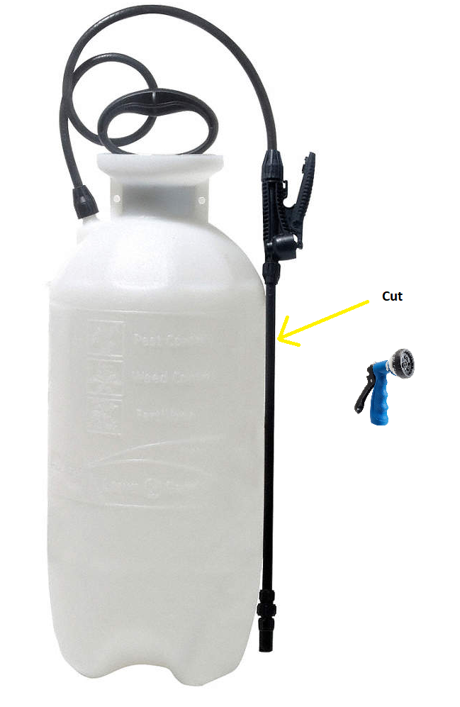

Regarding a shower on board Something I've done (and it works very well) is to take a garden sprayer (like this one) and remove the wand and buy the necessary adapters to put a garden hose nozzle on the end. Then paint the bottle black. Fill it with water and bungee it to a stanchion for the day. When it is time to get ready for bed, you have 5 gallons of warm water you can pressurize and spray yourself down with in the cockpit. Soap, rinse, repeat. Nothing quite as nice as going to bed clean and getting all of the stale sunscreen off of your skin. We also take the "bottle shower" with us camping.
NINEv2
Jul 21, 2020
88
Catalina 250 Black Hills
My Hunter had a walk thru transom and it was one of my favorite features of the boat.
But you should consider the basics first. Buy a clean boat. It should have a smooth bottom. No deck issues. It should be fun to sail - which means it can go upwind. No odor from the head. Expect to buy sails but don't do it right away. Standing rigging on a lake boat is likely to be in good shape.
If I read it right your intended use is
on a 300’ deep lake? I’d get the keel boat.
The walk thru is key. A non-stank head would be nice too...
That's... a really good idea. Thanks.

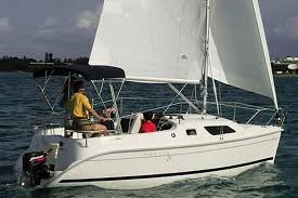

My choice would be this one...
The only button it does not tick off is an outboard
I was looking through your list and that is one fine looking boat! With the tall rig that baby is going to sail nice! I was going to post that this is the one I'd put on the top of my list if I was the OP... Great find @rgranger !
