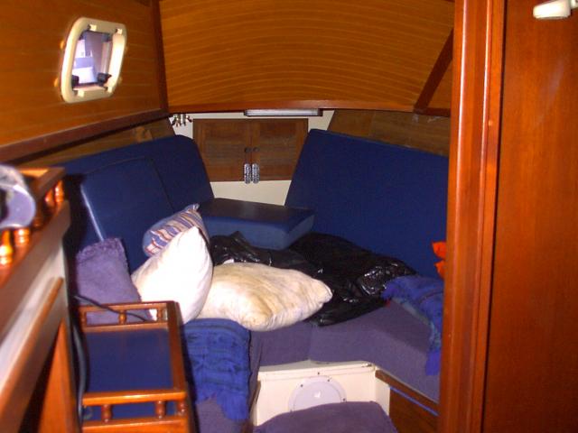

A thought on the solenoid.
I have a windlass that originally had the solenoid mounted in the windlass housing where it failed several times due to condensation (the housing was sealed against water). I decided to put it in the anchor locker as you are, but a pounding cruise in the straits of Juan De Fucca, where I buried my bow on every other wave, and had green water rolling back to my dodger made me realize that I was getting a lot of water down the chain pipe into the chain locker. So I changed my mind and put it on the inside bulkhead of the fwd cabin, just below the deck, and caulked the wire in the holes. It has remained dry for 8 years and I have never had to service it since.
In the picture you can see it above and the left of the chain locker doors. Don't pay attention to the mess on the bunks.
The directions for the solenoid should tell you to NOT mount it in a wet area- like the anchor locker or chain locker.

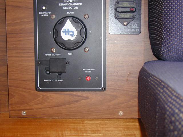

Below Water tight
All my electrical connections are under the windlass where no water is allowed in forward of the vee berth.
The circuit breaker is under the navstation where the the main battery 1-2 switch is and where the haevy batter cables start the run up to the windlass.
