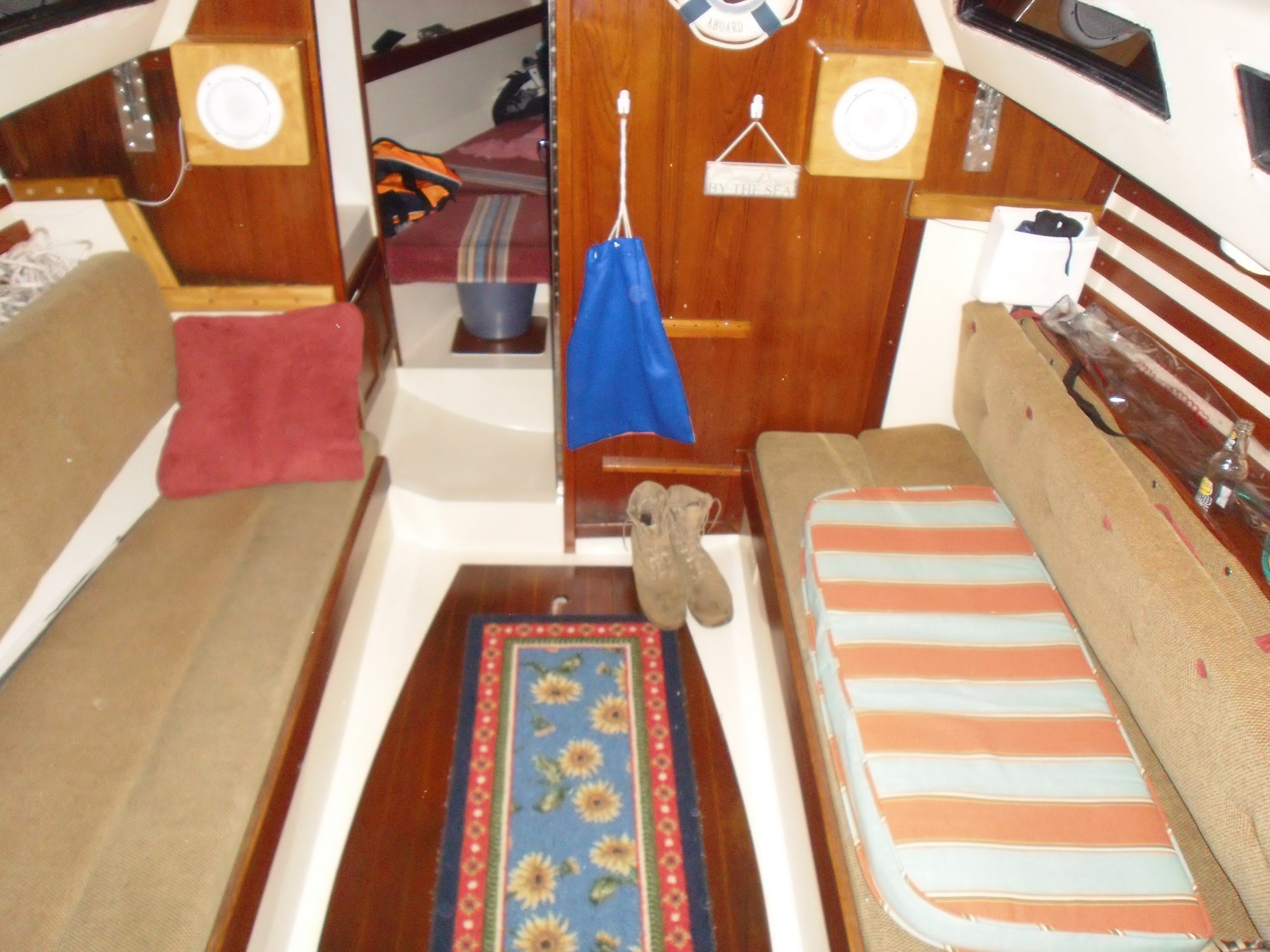

It is a very uncomplicated shape. The ends are straight but the sides are curved like an oval (mimicking the sides of the boat). It is only 6' long because it is basically in the center of the salon. The fiberglass floor pan basically follows the contour of the boat bottom except that the pan is flat and recessed 3/8" where the wood sole is inserted. The two bilge panels are just 10" x 20" rectangles and all four edges catch the edge of the floor pan at the cutouts for support. The bilge panels are built up underneath with solid wood stringers for stiffness. It's very simple. The panels fit inside the cutouts in the sole pretty snugly (sometimes they bind on the edges if the heat and humidity is high). There are just finger holes in the panels to lift them out when I want access to the bilge. Very simple - no hardware, no hinges. I just want to make the panels a nice snug fit with clean cuts. The curved sides of the sole can easily be cut with a jig saw and sanded smooth to fit the recess - not worried about that. I am most concerned about the clean cuts for the panels into the bilge openings.
As for materials - I suppose the simplest solution is teak & holly plywood. I don't want to mess around with gluing down veneer. There are some laminated products now that appear to be like individual planks that click into place. They are thin and would have to be placed over a thin plywood subfloor. I would still have to deal with the cuts and the fitting to line up the holly strips in the panels. It seems like more work than it is worth. PlasTEAK makes a product that comes in a roll that you have to glue to a base. Again - maybe more complicated than necessary. I'm not fussy about this floor. If there is a good synthetic product that looks good and is easy to apply, I would consider it. If the simplest way is to put down a plywood teak & holly and varnish it, then that is fine, too. I want teak & holly to stay consistent with the original look. Synthetic or plywood ... doesn't matter but I think I would avoid the rolled products. We buy a carpet runner with the rubber backing every spring at Kohl's to put down on the floor anyway.
Attached is the best picture I can find of it. The runner is covering the bilge panel, with just the hole of one of them at the head of the runner.

The plywood sits flat on the fiberglass floor pan. The only openings in the floor are the two bilge access panels lined up in the center over the keel for access to the keel bolts and bilge pump.
