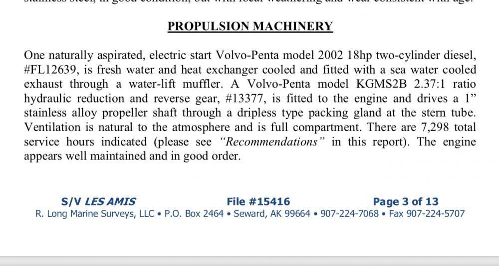

Thanks I have a survey from 2 years ago. I also have receipts for lots of work done to boat but none for the engine. The survey states a Volvo-penta model 2002. I tried all these numbers on volvo’s website but nothing works. Does this mean it was repowered? Going back Monday to spend a couple hours looking under the hood. I have lots of questions and am trying to go armed with as much info as possible. Thanks for the help. And yes I will be asking about the engine hours.
I plan on getting the three inspections unless they are cost prohibitive. I’ll know more when everything opens on Monday.

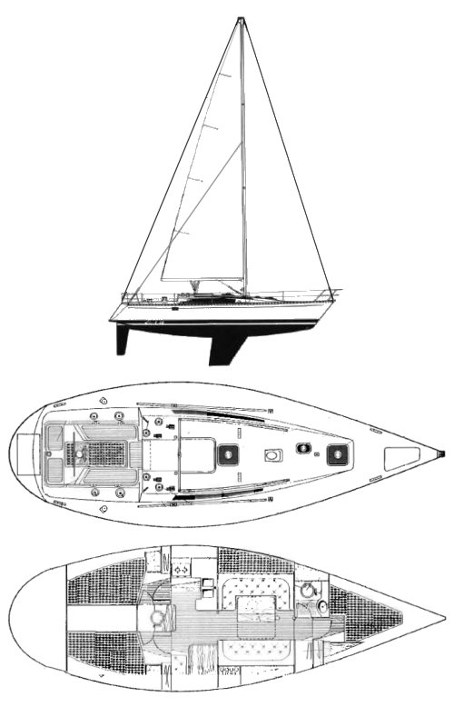

They are checkstays. Lots of Jean Berret designed masthead boats came with them from the factory, like the First 38 of the same vintage as shown below. Someone probably added them. They do help stabilize the mast.
