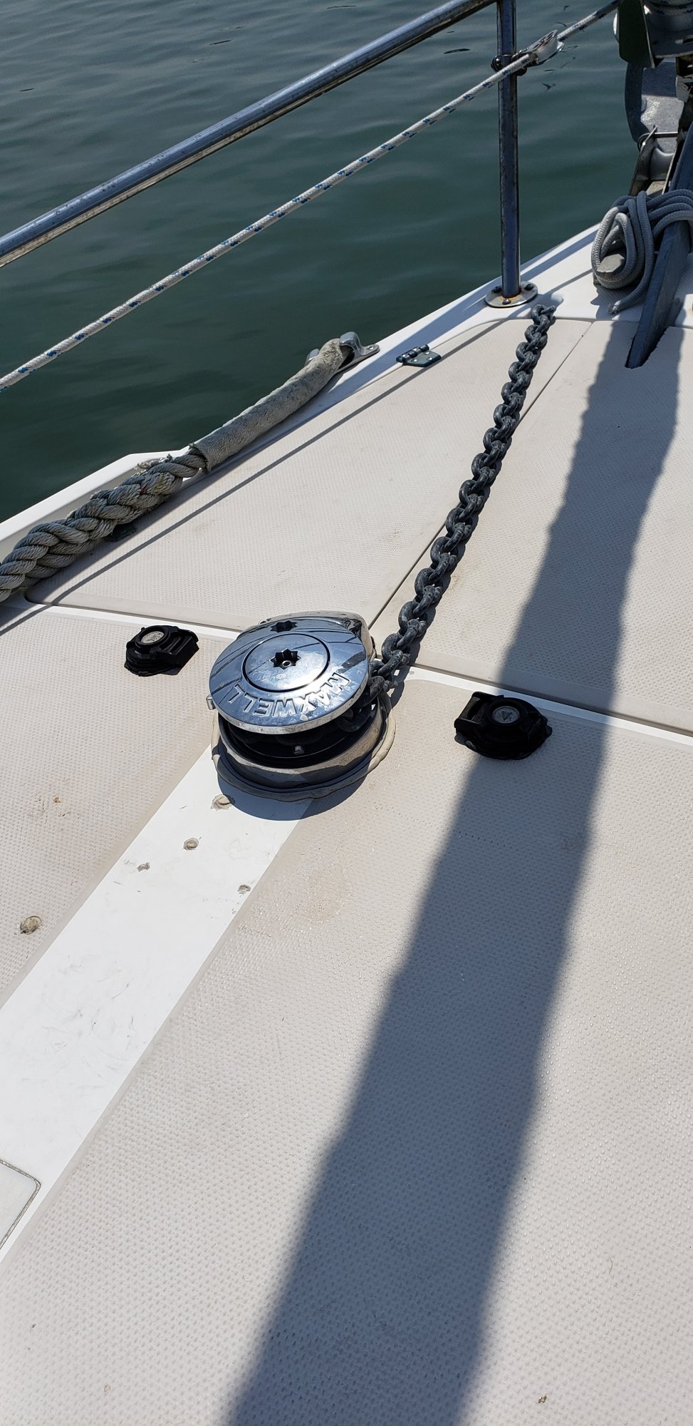

Feb 11, 2017
35
Thanks Mike, but I was looking for how you may have added a windlass and what kind suited your problem best.
I ended up installing a vertical windlass with the motor located in the peak of the vberth. I chose this location for 2 reasons - I didn't want to consume a significant part of my anchor locker with braces and mounting plates. The second reason is that most people suffer severe corrosion having the motor in a wet anchor locker
Feb 28, 2018
10
Hunter 336 Ventura California
Thanks again Mike, the pic helps. Wish I could see inside the locker though. I don't think my locker is deep enough to accomodate this type of install.
