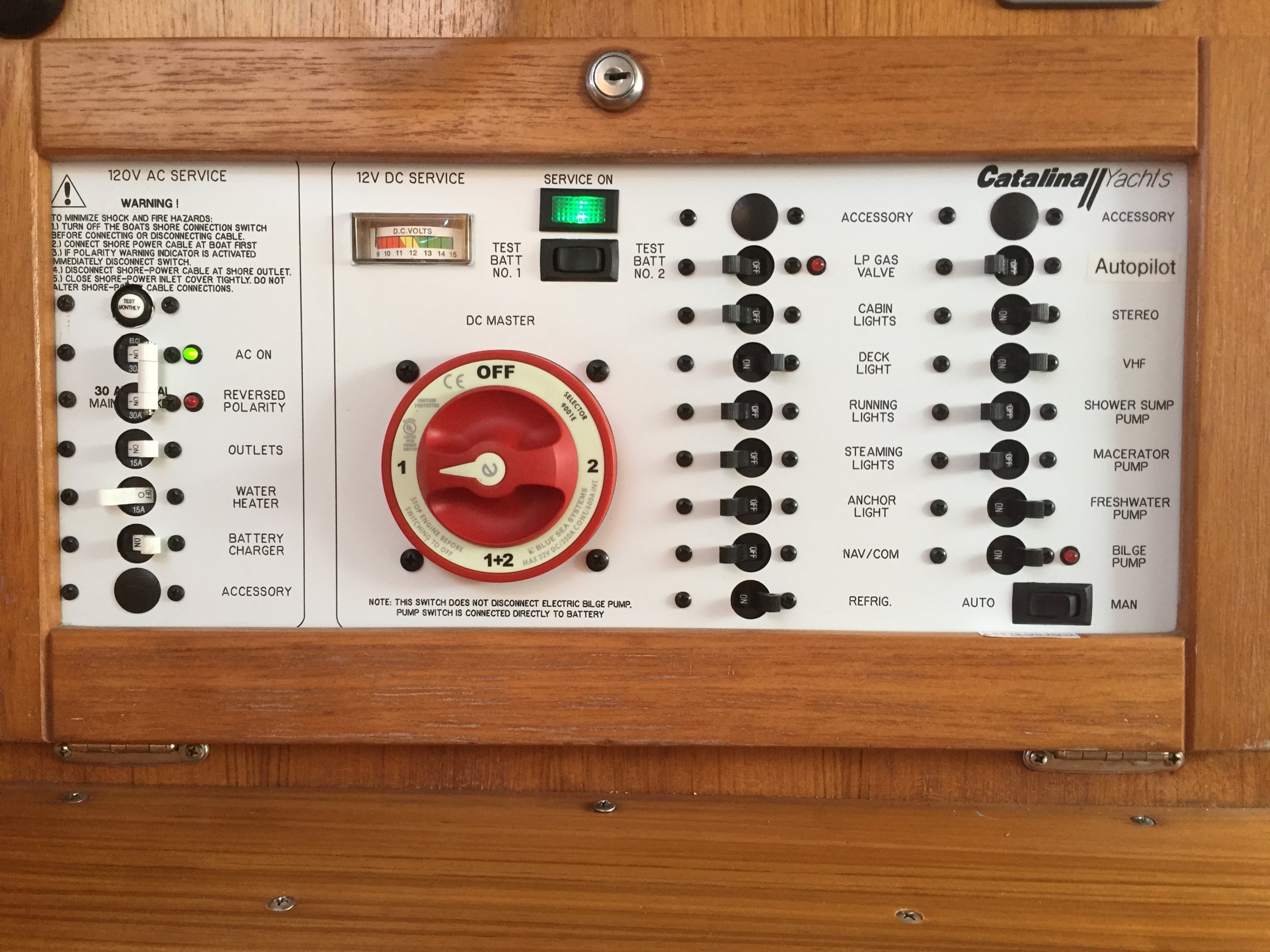

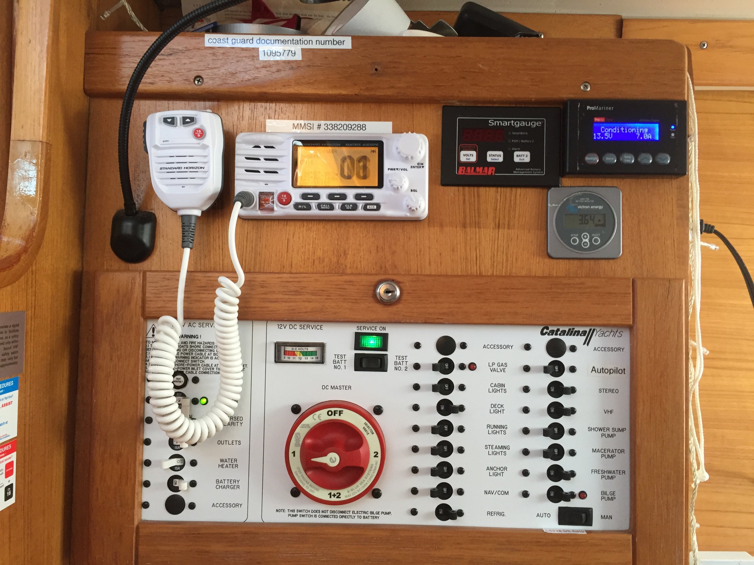

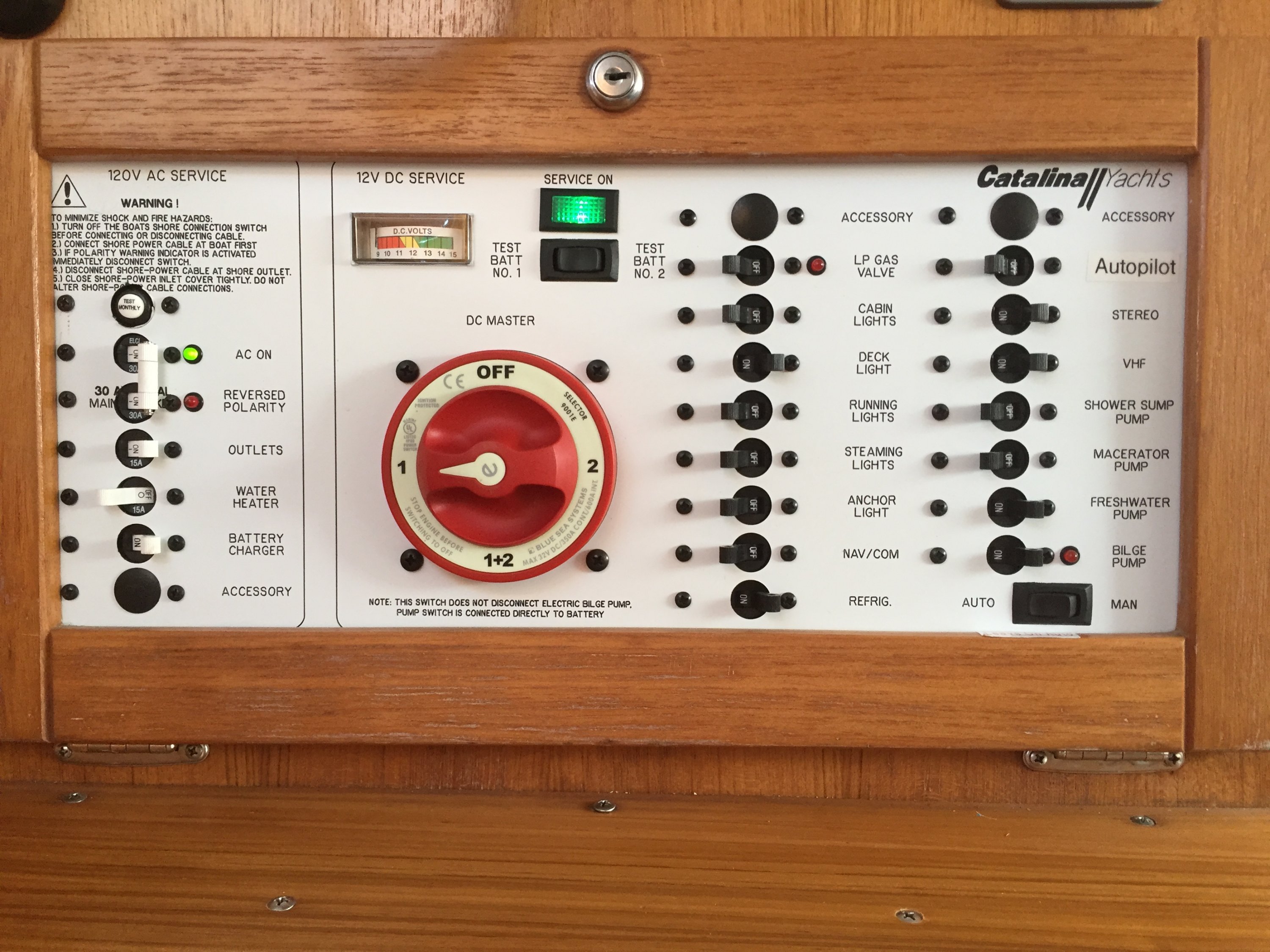

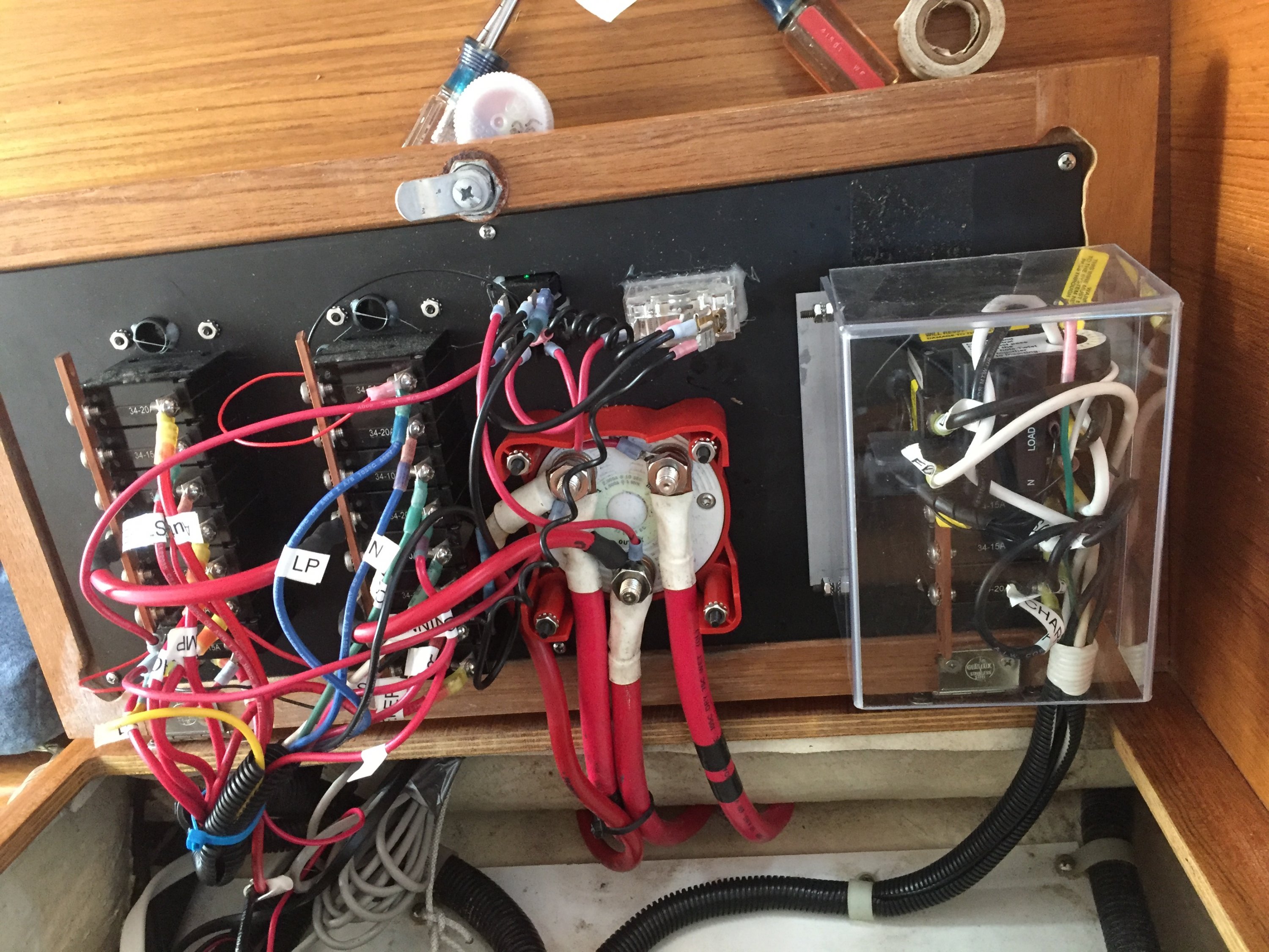

It took 1-1/2 years from when I got the panel, but I finally installed it yesterday. The old panel had no way to turn off individual AC circuits, push on fittings for the DC side, a fair amount of corrosion, and no working idiot lights or analog meter (not such a big deal). A very nice upgrade, and it all works!! Thanks to Dennis Garashi @ Seaward for being so friendly and helpful when I was looking for a new panel, and Maine Sail and the rest of the folks here who have been so great in giving advice and support. I replaced the main AC breaker with an ELCI breaker I bought for our C27 and never used.

I'll bet it's not an LED, although it would be nice if it was! Probably the entire assembly comes out. If you wanted to just replace it as it is you could give Dennis a holler (digarashi@earthlink.net) and see if he's got them available.

The Service On light in the new panel I just installed is a Solico Series 15, 14V, 1.2W. They do make an LED version, but it's for 2V, so would probably require a current limiting resistor.
