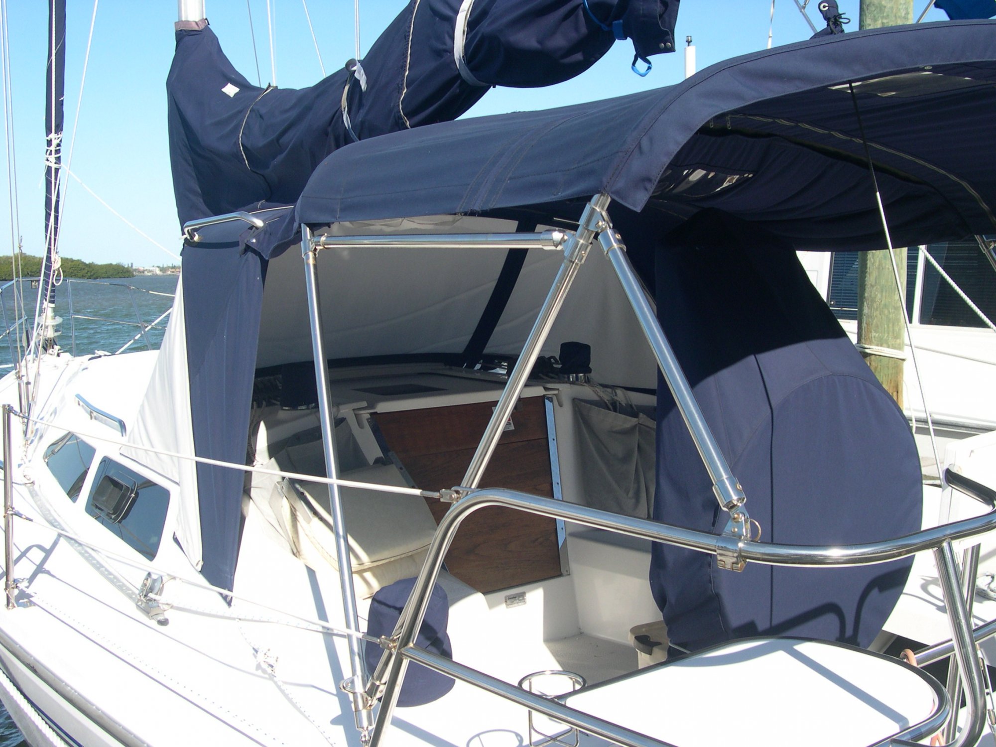

When considering a new dodger, I would advise going for a heavy tube construction, with a grab handle on the outside. It will be more expensive, but the safety the grab handle affords is priceless.DSCN0100 3.JPG

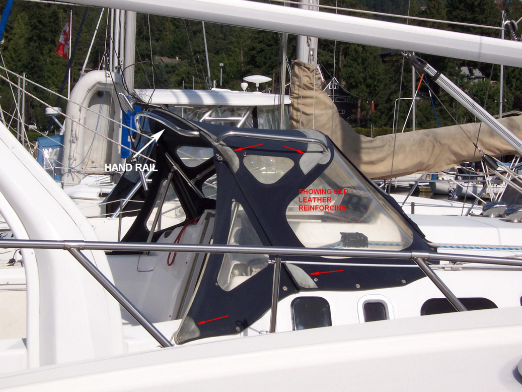

All in on my custom made dodger in 2018 came to almost $3400. I had quotes as high as
5k, but I found an independent craftsman who works the so cal area out of oceanside. I got the best canvas, stainless frame, composite trim (not leather), isinglass (not vinyl), window cover, removable side panels, opening center section, welded rear hand rail, and bolt on side rails.... in other words... top of the line. A really great addition to my boating experience.
Walk around your marina and inspect dodgers you like. Look for the builder's badge, you might get lucky and find a local name and number. Give them a call, see what's up. Ask about thread quality, canvas, types of glass inserts they offer, frame quality, that kind of stuff.
I discourage you from ordering online for project like this. There is one company, I think it's called Island Nautical Canvass.... the prices are pretty low... but the quality is way way inferior and.... you have to do all the measuring and fitting. That's impossible...it's just not worth the thousand bucks you think you're saving. Good luck.
