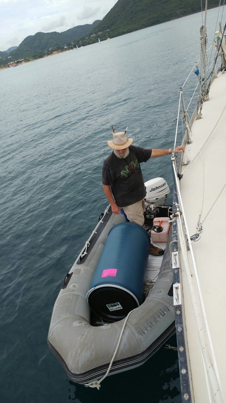

I've never been a fan of RIBS. I've always had inflatables that deflate, kinda the point of an inflatable, IMO. We have the Zodiac Mark 1 Classic w/alloy floors and keep it on davits most of the time. With either the alloy or wood floors you have a larger flat area inside to carry stuff and people and both are lighter than the equivalent RIB of glass.
However, you must have lifting rings installed on the pontoons, not try to put eyes on the floor to lift it.
