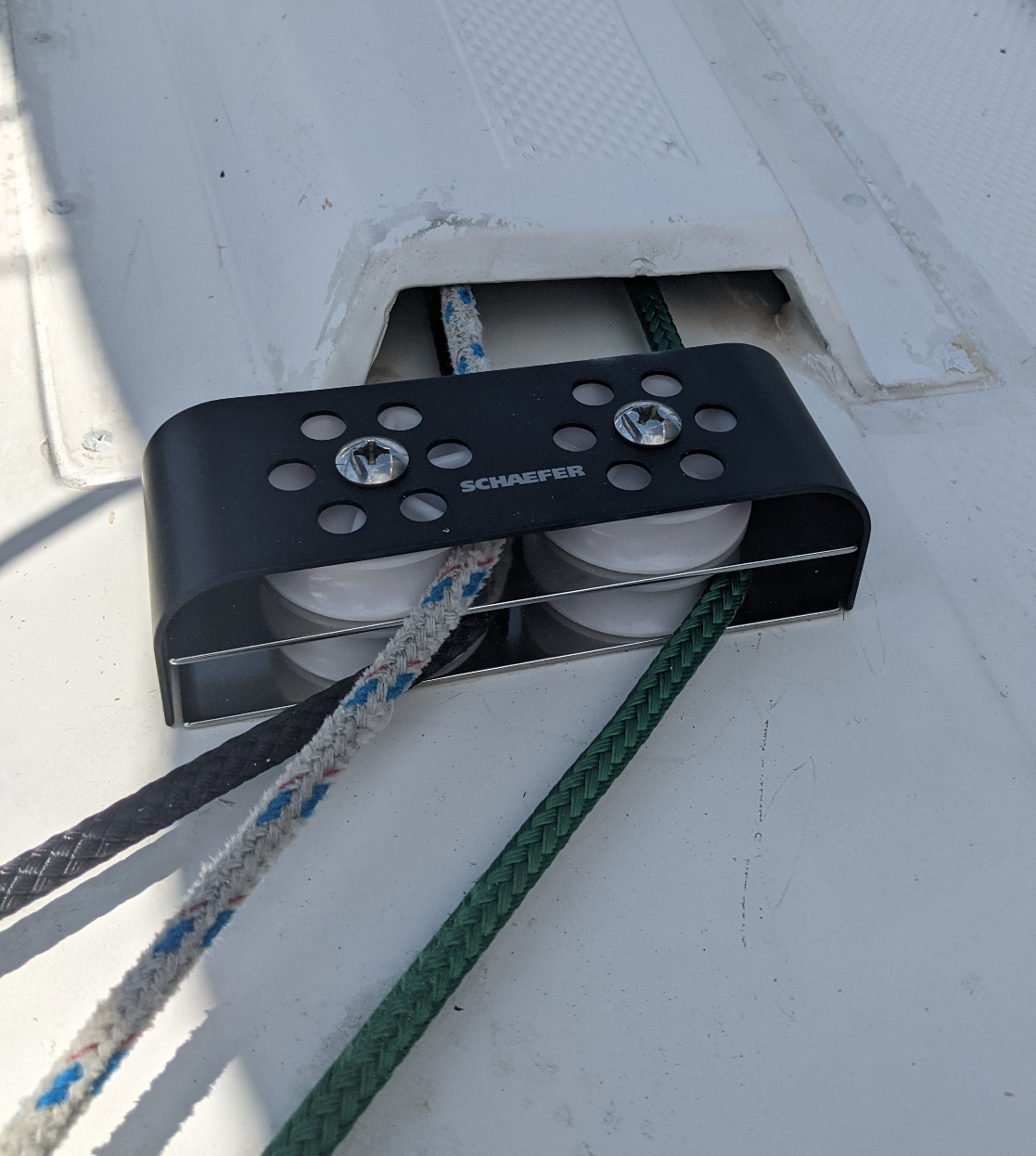

In case someone is looking for an easier way to have a double stack deck organizer on a H34. The Schaefer 704-30 is a direct drop in for the original single stack Schaefer one.
The provided bolts from the double stack organizer need to be shortened but that's it. The new bolts have the same size and distance from each other as the old ones. All in all perhaps a 20 minute job.
I only have use for inner/upper block right now (topping lift) and there's no rubbing on the hood. A line on the other block might require some modification/chafing protection on the hood though.

I was thinking about the 5 series single stack to replace my originals. Do you feel the 7 series is necessary?
Aug 10, 2020
29
Hunter 34 Austin, TX
The 5 series would be fine for the purpose but the distance between the two bolts is shorter and you would need to drill a new hole in your boat. I tried the 5 series first.
