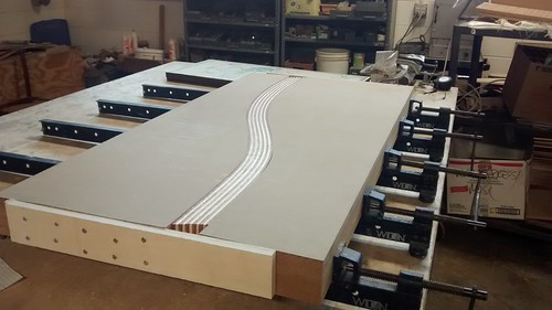

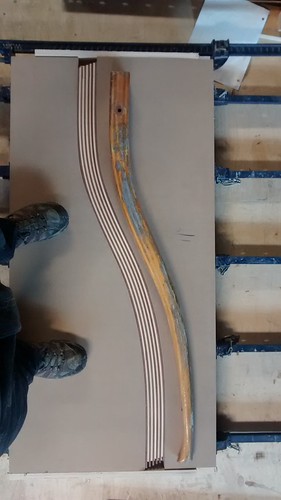

My friend Mark is an excellent woodworking craftsman, he does all sorts of cabinets and custom home projects. I enlisted him to build new custom companionway doors and a new customtiller for the Hunter 23. He also redid all the other brightwork on the boat, so everything is fresh and looks like a million bucks!
Below are some photos from the build process and also spring prep!
It's made out of Jarrah and Cypress

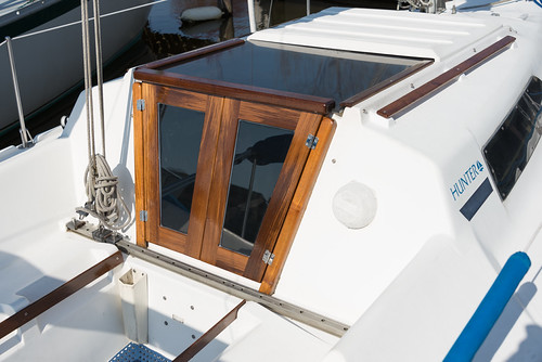

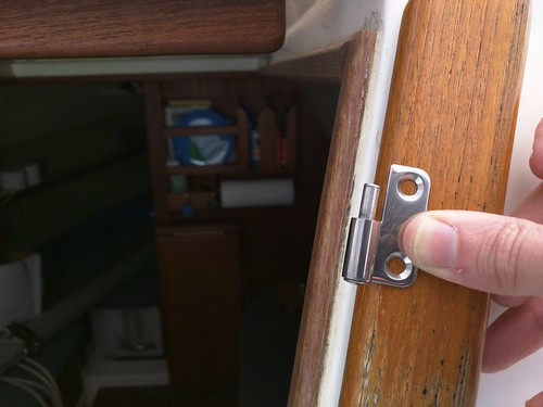

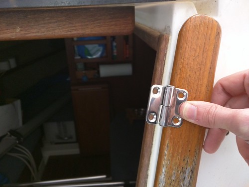

Lifting Hinges for the new companionway doors

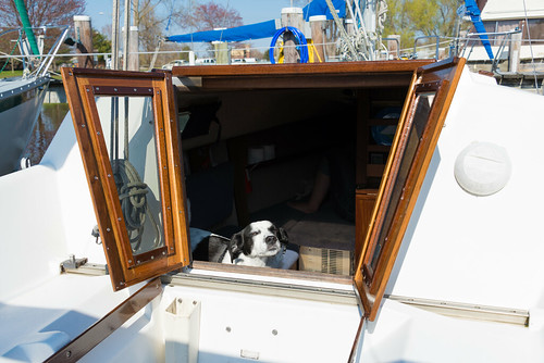

They just slide right off

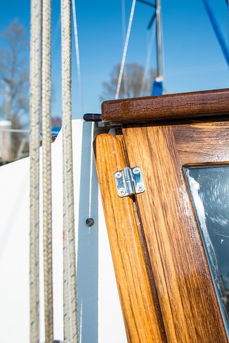

The new doors are made out of teak

The new doors are in place and the deck is finally clean!
Boomer approves of the easy to access cabin!

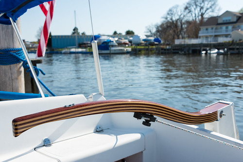

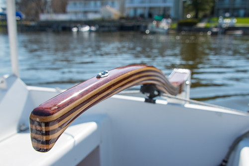

The new tiller looks absolutely fantastic!

Does your buddy have plans drawn up for those doors. I am very interested. Also, are the windows glass or plexiglass? How do they seal to keep water out around the edges and where the doors meet?
Jul 26, 2010
140
Hunter 23 South Haven, MI
I can check with him. I know we made some sketches with measurements along the way, not sure how far he went with exact plans.
The windows are 3/8" smoke gray polycarbonate Lexan.
So, we had many discussions about water ingress. Here's what we did...
  1. He made a new larger wood block "handle" for the top (32"W x 1 3/8" T x 2.5" D). You can see it in the photo, it goes all the way to the edge of the doors now and also sticks out over the doors about 1". He also put a water drip edge under it, but in front of the doors to keep water from running over and into the cabin.
  2. On each side, there is a wood strip that is 3/8" thick attached to the back of each door that overlaps out 1/2" beyond the door so when the door closes, the overlapped strip inserts into the track for the old hatch boards. That keeps any water from coming in between the door and the companionway trim pieces on each side.
  3. The bottom edge is just 3/8" strips on the back of the doors to make it all even. I may add a small rubber strip on the bottom just to help the doors not clank if someone throws them shut.
  4. Between the doors, there's a 3/8" strip attached to the port door that simple sites behind the starboard door when closed to keep water out.

Love your new woodwork. Your friend is a true craftsman and artist. The new tiller handle is great and the tiller tamer mounted below it is interesting. Wish I could duplicate your walk thru doors but as I use my traveler on every tack that would not work for me in this Texas heat with summer nearly here. Wish it would. How much beer did your polish/ buffing job cost? lol and that's the best looking paint crew on the planet!
Aug 11, 2011
1,019
O'day 30 313 Georgetown MD
.....but as I use my traveler on every tack that would not work for me in this Texas heat with summer nearly here.
Seems to me that they would just lift up off the hinges and be stowed safely below. That's how I would perceive the pictures be showing. Is that correct Palladin 27?
