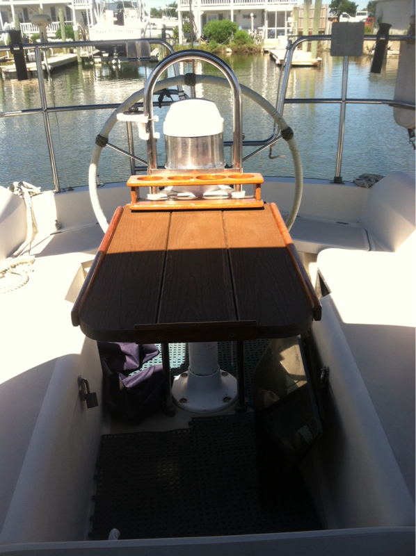

I went to refinish my old table and found it all rotted out. New tables ranged from 300 on up depending on source and features. The starboard ones look bad and the teak ones will require lots of maintenance. So I scouted a few lumber yards and bought a composite deck board with wood grain finish. Then I salvaged some teak from the old table for fiddles and all the metal hinges and support bracket. Voila a new table for 30 bucks or so. A little heavy but a router could take some stock off the bottom to cut weight if so inclined.
