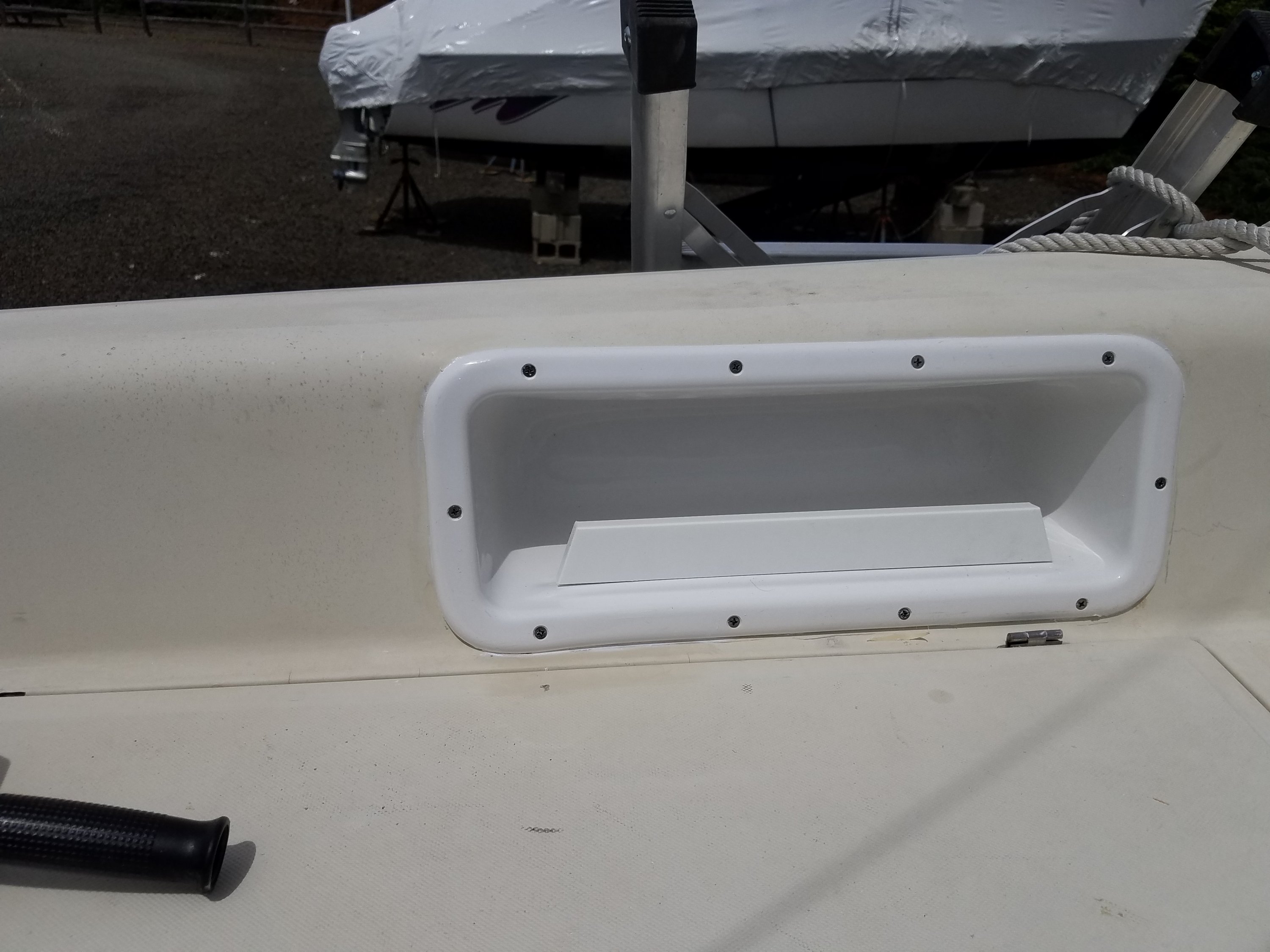

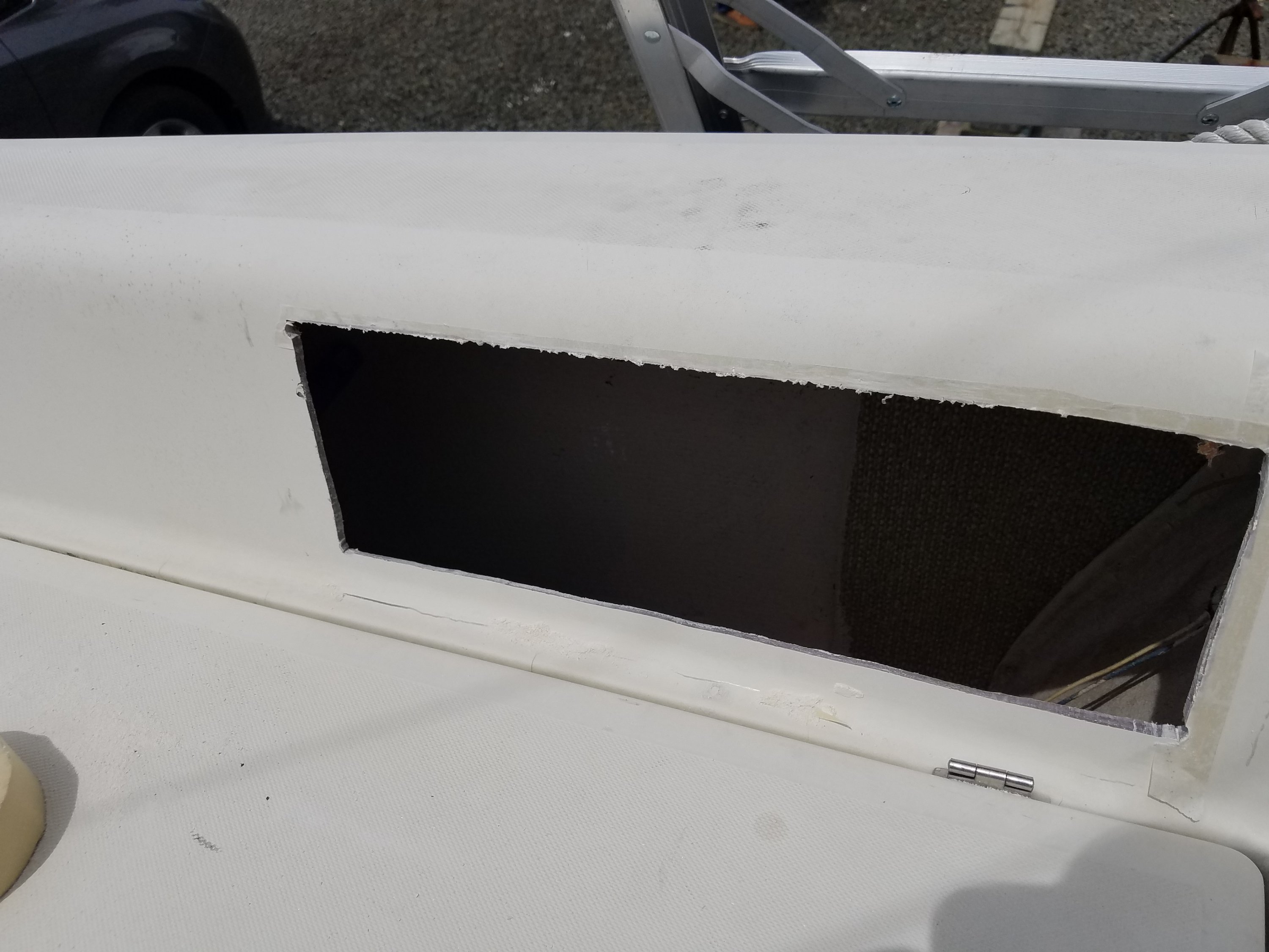

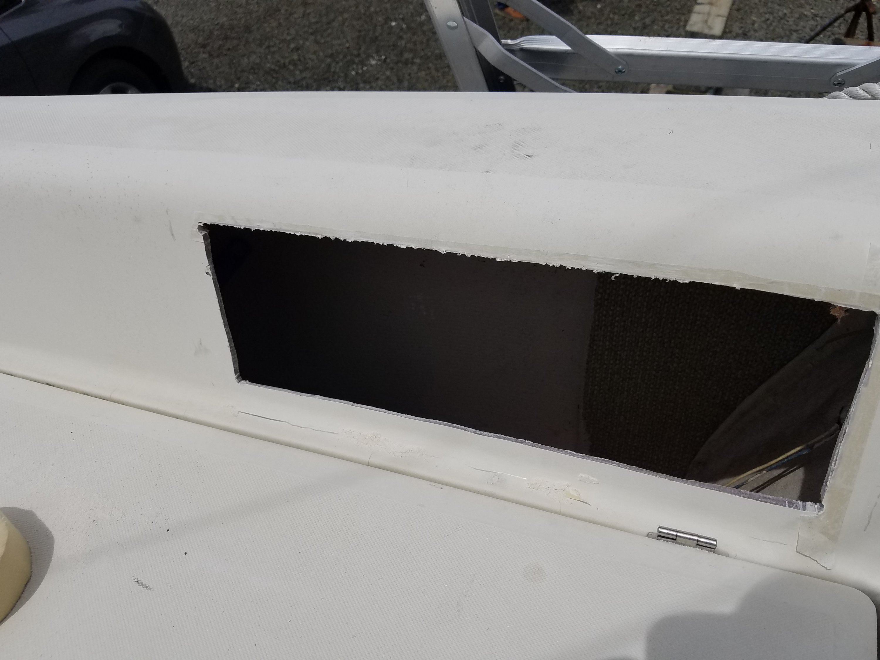

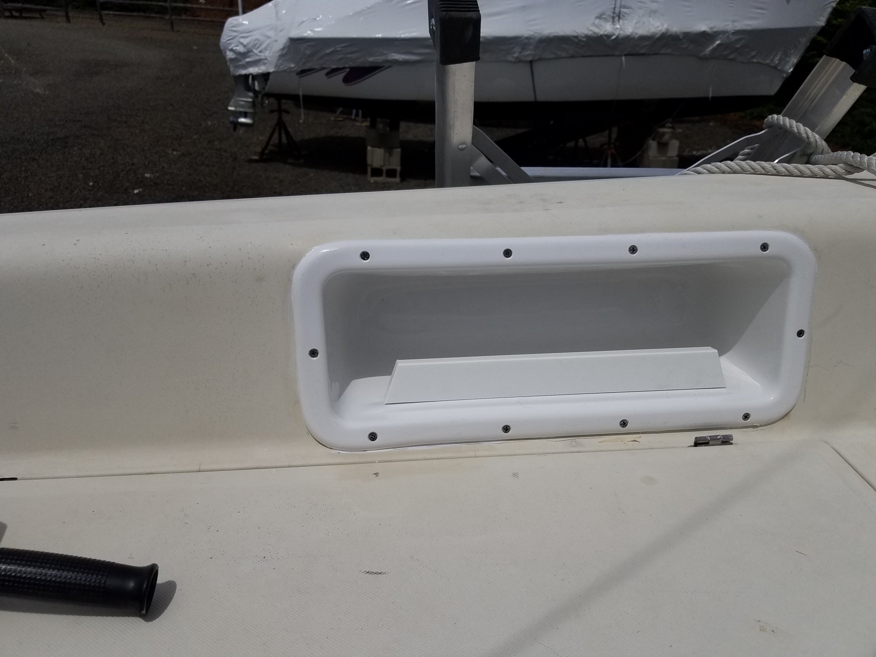

In order to get the blade in, I had to drill large holes at each corner of where the box would go, and fortunately, the jig saw made relatively quick work of the rest. Plenty of power. Below is a picture of the hole, and a picture of the installed coaming box. This first box went so quickly, I was encouraged that the second one would be even easier. Not so much.
I made the mistake of assuming that the area behind the coaming on the starbord side was as empty as it was on the port side. It was not. My first clue was when I drilled the corner holes for jig saw access; it seemed like the glass was thicker than on the port side. This was repeated when I put the jig saw to the coaming. But I really knew things would be different when the cut-out piece of coaming didn't fall into its hole when the cuts were complete: something was clearly in the way. I removed the piece of coaming, only to see an edge of an interior pan in the way. Oday, which never seemed to make neat appearances a high priority, for some reason "finished off" the aft end of the area behind this coaming with a piece of gelcoated glass. This is only visible from the cabin if you stick your head into the space behind the sink; this "bulkhead" is also behind the water tank and is just not accessible. It is also clearly non-structural as it wasn't tabbed to the hull or the coaming, and is only about 1/8" thick. Using the jig saw, but mostly the angle grinder (this time with a grinding wheel, so it turned out to be useful for this job after all), I was able to take away enough material from it to fit in the other coaming box.
All in all, it took about an hour and a half to install both boxes. Their stark white color is quite the contrast to the faded gel coat on my 1979 boat, but I can't wait to try them out!
