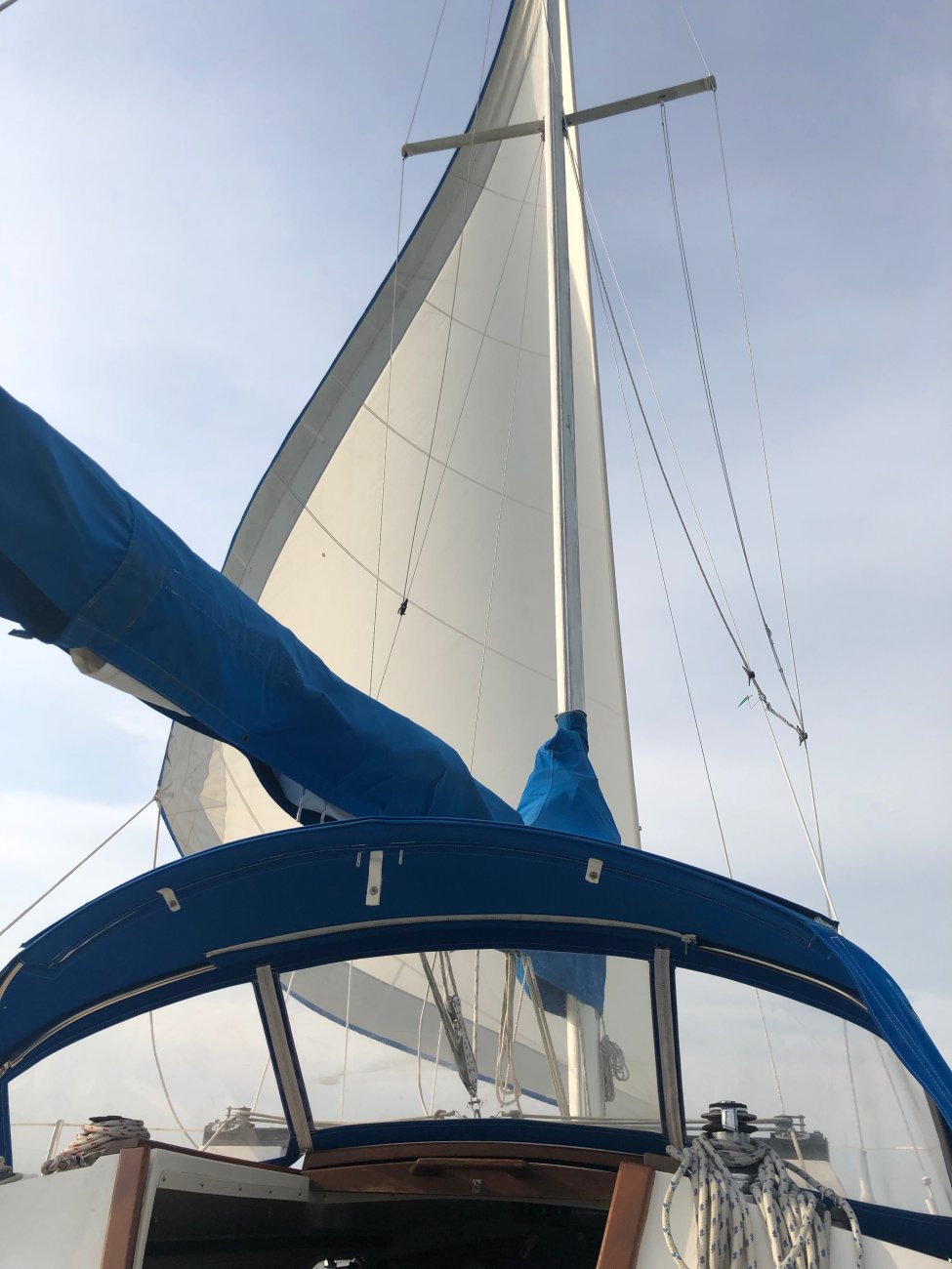

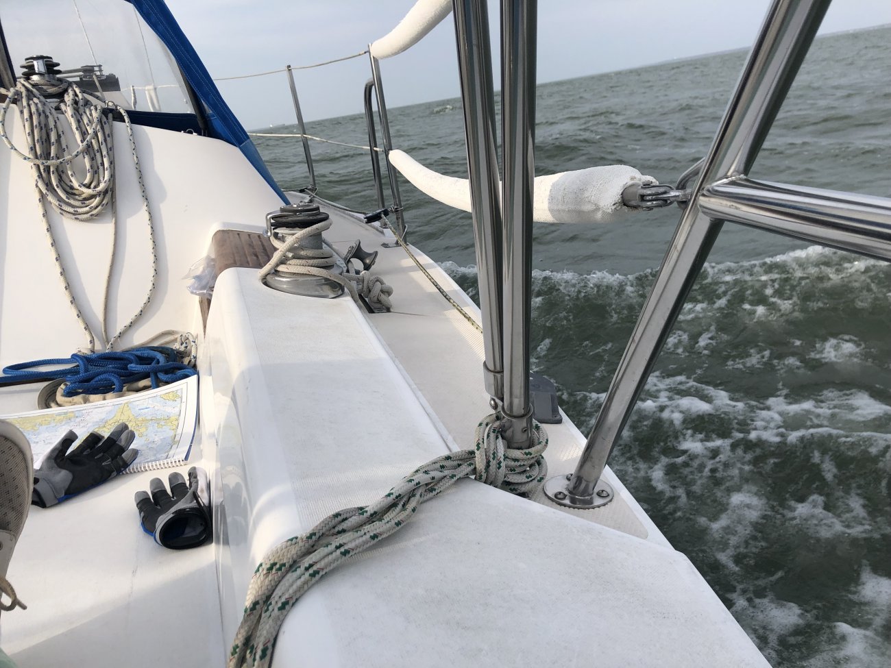

These pictures are from the trip. The submarine was visiting the Naval Academy. Also, noticed the jib picture...it didn't unroll completely and I should have known that there was a problem with the roller. Ugh again.

Great report of your trip. Glad you're getting a good and early start with your C30.
I've found that the big genoa takes a lot of line on the spool when unfurling it. The trick is to keep tension on the furling line so it wraps and lays on the spool neatly. A neat wrap takes less room on the spool. A poor wrap bunches up and will jam the drum.

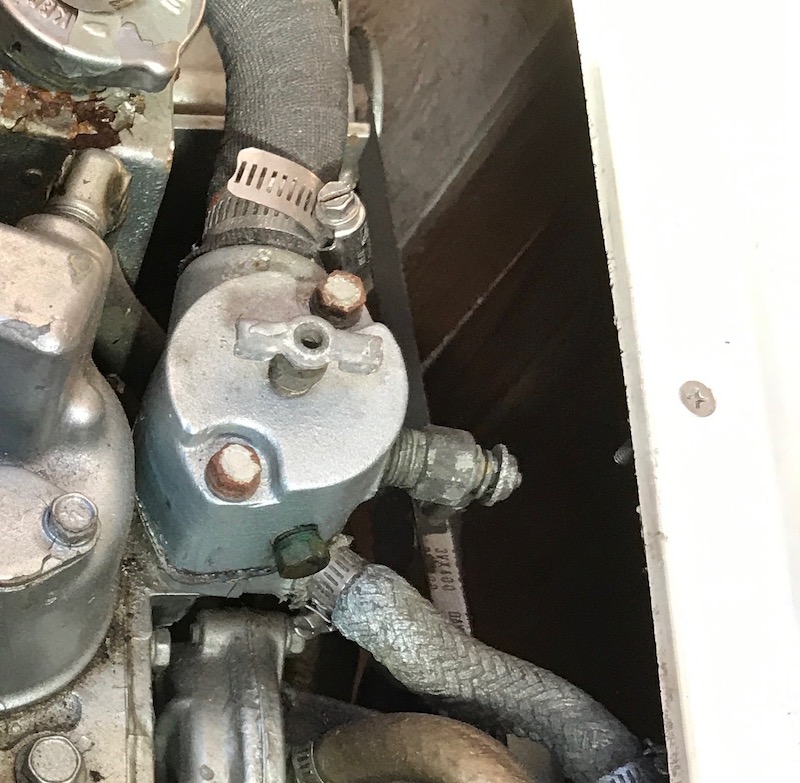

It is a switch in the thermostat housing that senses when the engine temp is too high and closes "to ground". This activates the temp alarm which is behind the engine panel in the cockpit. I believe you can test the alarm by jumping the wire at the switch to ground. That should activate the alarm. Catalinadirect.com has the switches, I'm sure other places have them also.
Here is a photo of the thermostat housing my M25XP. The temp switch is mounted on the right side of the housing just above the silver hose.

Catalina started putting the Temp Alarms in 1990-91 with a kludged up daughter board on the temp gauge. 1992 no alarms on temp. In 1993 they changed to a temp switch
So his being a 1989 it would not have had a temp alarm unless a PO added it. In which case you would have two sensors in the thermostat housing not one.
@Ward H i think that is a temp sensor not a switch (assuming you have a temp gauge).
Your right Les, I do have a gauge. I also have a daughter board behind the panel that must be the oil pressure alarm? I thought it would alarm also for high temp, didn't know the temp sensor and temp switch were two different items. Thanks
