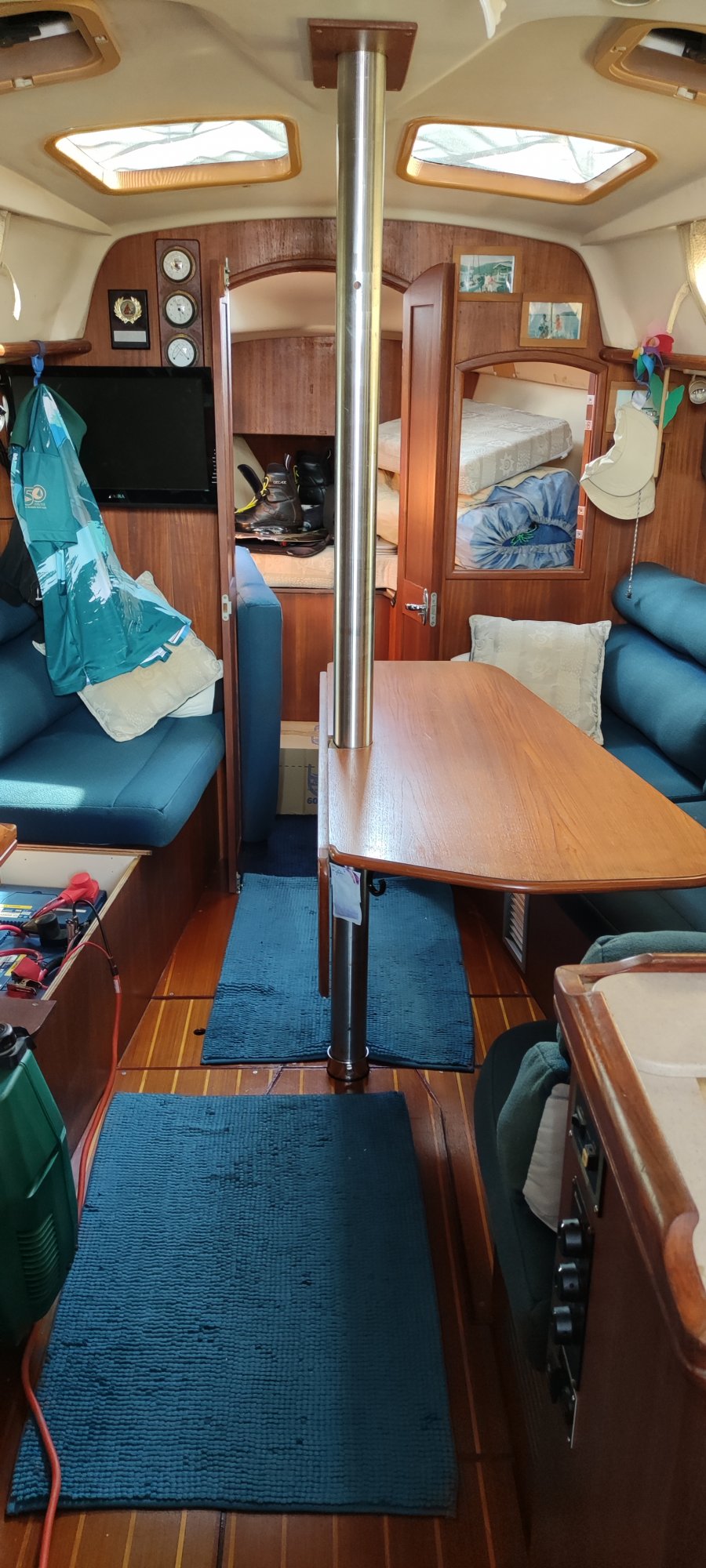

Hi Hunter owners, has anyone replaced their cabin table? Ours broke on our Hunter 326 and the only replacements I can find are expensive custom makes. Any advice? Thanks!

Consider buying an rv table.....OR get out your table saw and fabricate one yourself out of marine plywood and teak veneer. Secure the table to the floor.

The previous owner of my H280 replaced the OEM table with a smaller, oval-shaped one he made himself out of a piece of scrap teak he got from a boat yard in Anacortes....the smaller size makes it much easier to negotiate the interior of a 28 ft boat.

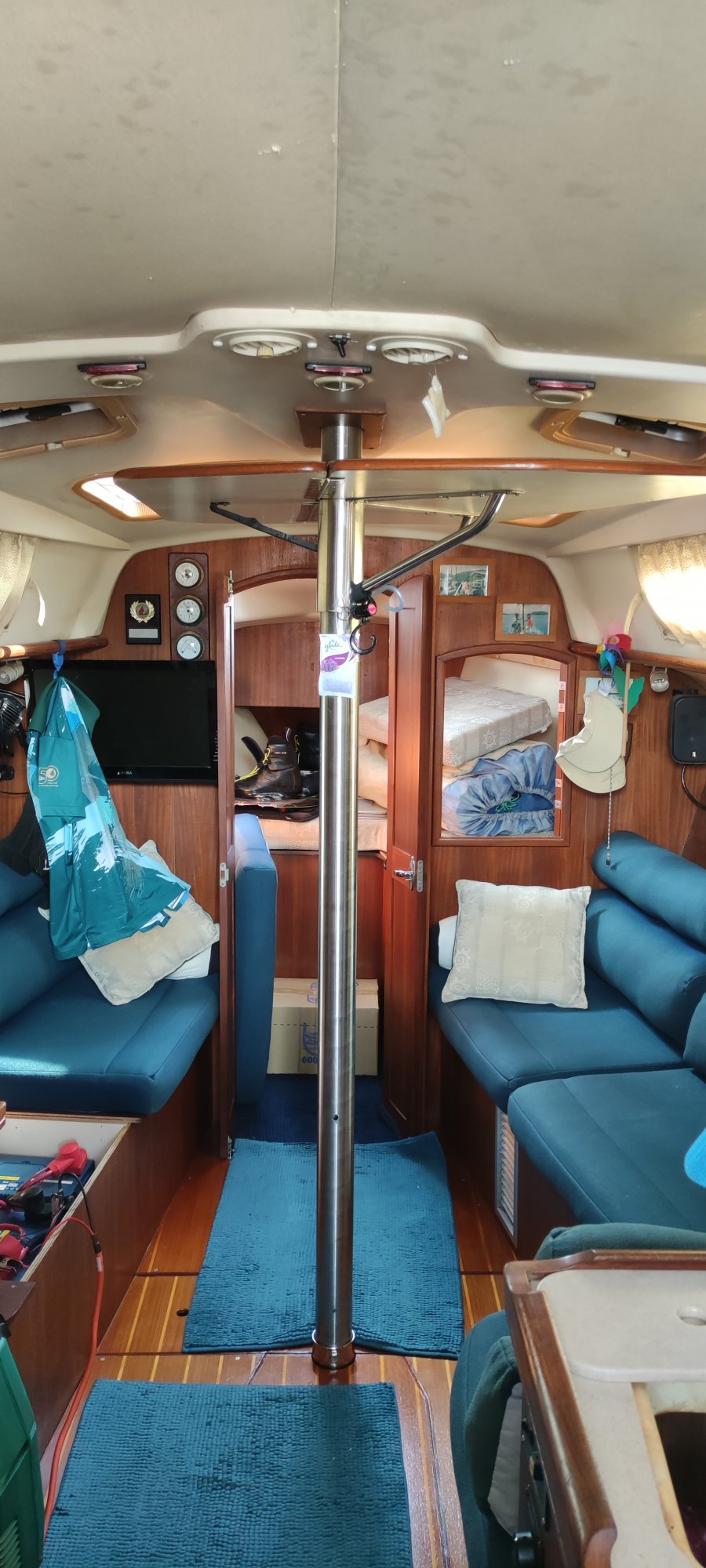

H326 table is mounted on and can slide down the compression post to make a bed with the starboard settee. After getting a replacement table made (2 pieces), suggest you also drill a set of holes on the compression post above 5+ft height so that you could slide the table up and out of the way to make space in the salon area. The holes should be bigger enough for the keeper pin.
