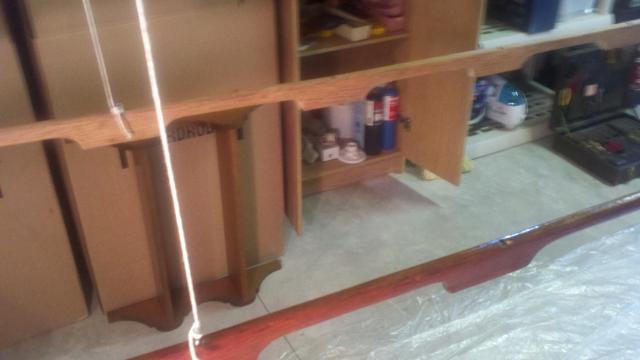

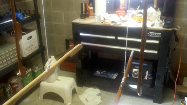

Pictures forthcoming. Here are two showing my decision to stay with the teak handrails. Took a lot of stripper and sanding and I still have a lot of black in there. But I just don't have time for bleaching. One short rail hanging vertically on right has four coats and is finished. Just one coat on one long rail and the other short rail. So I will have the eyebrow mahogany on Tuesday to try to match color to these.
I will keep the screws exposed for the eyebrow just like I do for the handrails. So nice to take it all home and work in the basement.
I know Maine doesn't like silicone Bill. And I forget why. It works so well for me. Anywhere I use it, around the mast and the chainplates for example, there has never been a leak. It sticks well and never hardens. But if you have to scrape it off then you can. Plus it is hard to make a mess with the Clear.

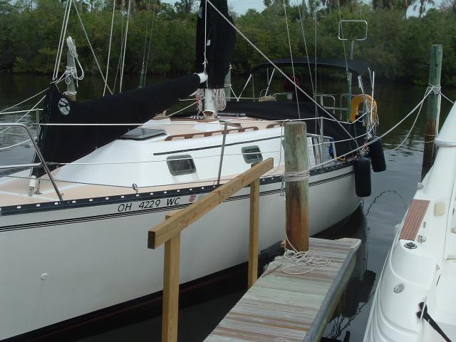

By the time you fill the old holes and install the new eyebrows, you could easily have faired the whole thing out well and applied a strip of paint one inch wide or stuck on some of that plastic striping they sell for the automotive business, same as we have below the gunwales.
Jun 2, 2004
5,802
You mean like this Bill? That's what I did years ago and it is coming off.
