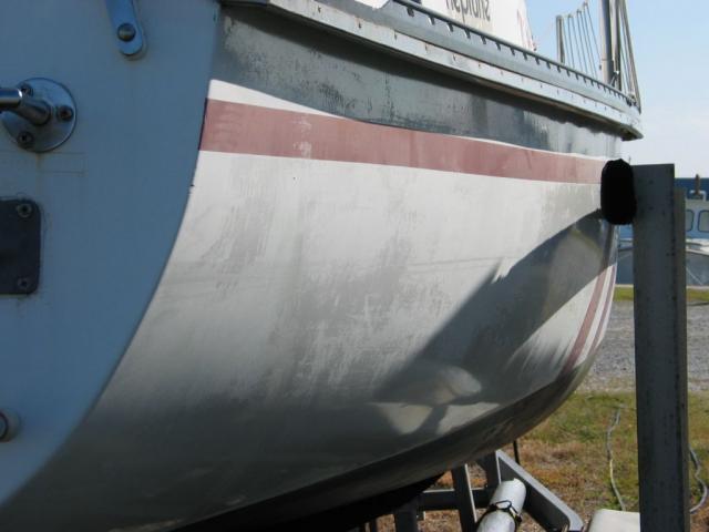

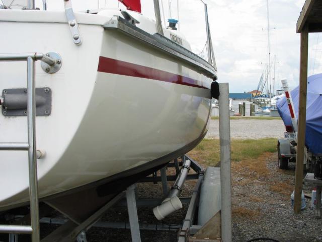

Polishing Imron(current boat):
Poliglow(previous boat):
Poliglow is definitely the faster, less work intensive way to shine a boat. I am a big fan. It does not hold up well to fenders and rough weather. You also need to do a lot of cleaning because it just seals in what is already there. The owner of my previous boat continues to use it(from my directions) and she still looks great.
I have been polishing all the places on my current boat above the gunwale. It is a lot of hard work but very much worth the result. Poliglow can be difficult to use anywhere but the topsides.
