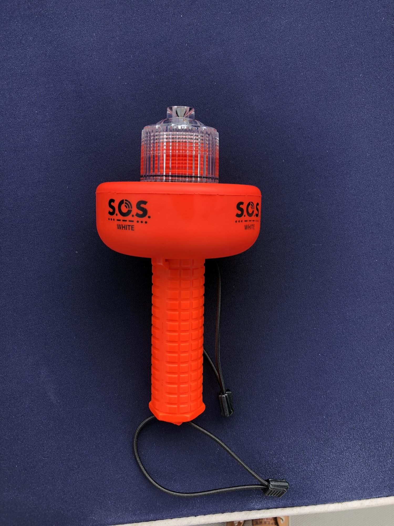

Note that these flares transmit a horizontal beam of light, like and anchor light, and thus must be rigged dead level. The light hangs at about a 30 degree tilt with the supplied rigging. Also, bungees are all wrong, since it will snap back and forth if there is any sway. They also light for more than 8 hours; that's a long time to hand-hold! 5 minutes is a long tome to hold something steady overhead. I have not seen a single image on-line showing it rigged correctly.
All wrong. Only visible in two narrow sectors. Bad marketing materials. And there is nothing about this in the instructions.
The Orion version comes with a hanging bridle. You can rig a hanging bridle on C-1003 if you slide the float down to access two eyes. The C1002 has no means of rigging a bridle. Go figure.
Think about it. If some one handed this to you in an emergency you would ask two questions:
  1. How do I turn it on (they all have obvious switches or are twisted)?
  2. Where do I hang it? But they are not rigged for hanging.

I have one.
I wonder why they FLOAT, the STROBE sends SOS in Morse, and are USCG approved?
Jim...
I don't understand. As a well-educated boater you could already know the answers to these questions... but many of the state end federal boating safety sites have not yet been updated to include any or full information about eVDSD . And it has been several years, so the education process is clearly lagging.
  • Perhaps you are implying you could float it in the water, but the range would obviously then be greatly limited. The value of floating would be in life raft situations. You could, in principle, also attach one to a danbouy or other throwable for MOB location.
  • They are not strobes. That is a different flash type, with short on bursts. These lights are on more than they are off. But you would figure this out when you turned it on.
  • I kinna doubt you would ask, in an emergency, if they are USCG approved. But you might. Of course, that is inscribed on them and the answer would be yes. Transport Canada approves The Serius C-1002.
Mar 26, 2011
3,947
Corsair F-24 MK I Deale, MD
why?
Do you want to STROBE the stars and sea surface?
Think MOB or Abandon Ship
a. Not a strobe.
b. Yes, exactly. The beam is horizontal, like an anchor light. You rig it dead vertical.
