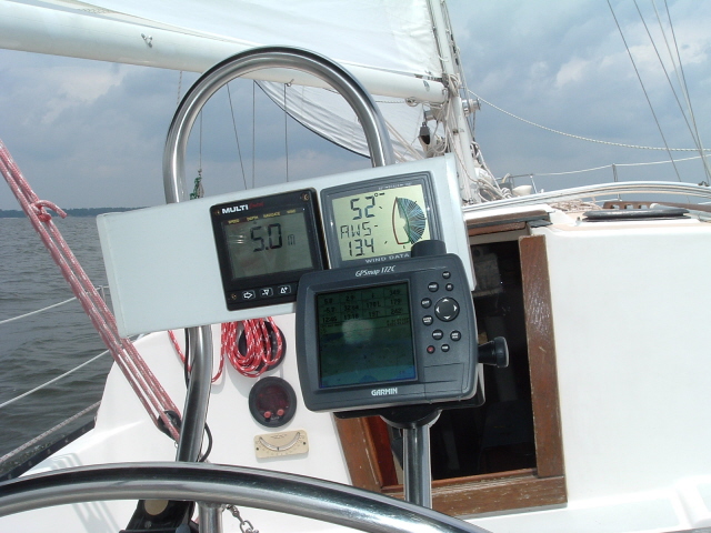

In my case, though, I've only 'attached' the radar to it. If the unit goes South on me it really won't affect my cruising since I still have the depth, speed, and wind on a separate navpod.

There is at least one piece of data that should always have backup - Depth! I use a multi-display with log and depth both displayed all of the time. All the other data is there with a touch of a button: wind, temp, etc. But since I cannot see my windex I installed a separate wind display which is also capable of displaying the other data. Coupled with this my original bulkhead displays(Signet) still work after thirty years. There were times in the ICW recently when I was glad for confirmation.
