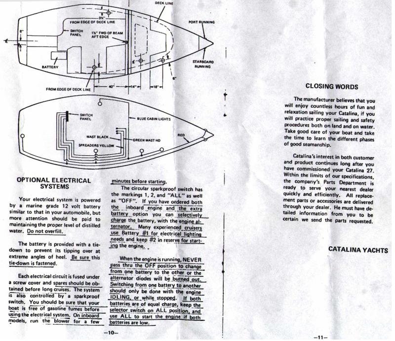

Anyway, is there a Cat 27 lay out somewhere that shows what trough hulls are located where and what they go to... like a "guide to your boat" kind of thing?

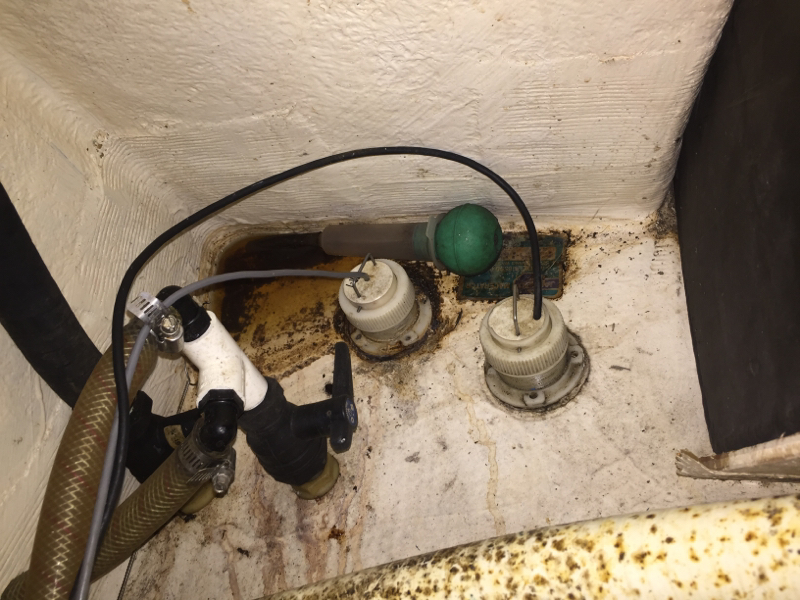

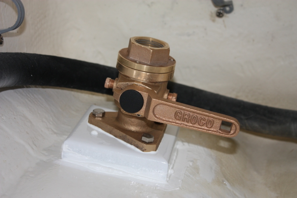

If the boat is really old and the plumbing is original, (and I have to believe it is) the thru-hulls are probably 'glassed-in nipples. Not very proper, not safe, and prone to catastrophic failure.
Look in the locations I provided in the factory print and verify you have these thru-hulls. Then take a look closely at each thru hull. Take a picture and post here if you can. We want to take a look and see if the thru-hulls have been replaced with properly installed updated components or if you still have the old original bronze nipples. If you have access to haul-out facilities, replacing the stock stuff with new proper flange-mounted thru-hulls and seacocks will probably be your absolute number one priority.
If your thru-hulls look like this, there are two things bad going on. Glassed in nipple is one. The gate valve is the other. Both need remedied
Here is an example of a properly installed thru-hull, with a proper quarter-turn flanged seacock. Note the built-up area, providing a thicker area for the seacock to be installed on/in

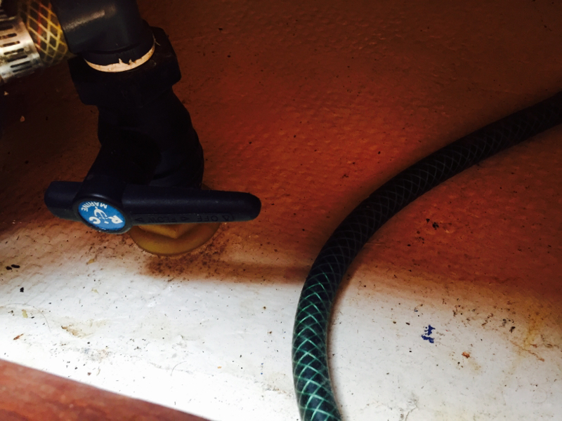

1986 is the year. The through hulls are black R C (?) marine if that helps. I don't think they are original. But not sure. Thanks for all the info!!
I wish I had the 85 and newer boat. One HUGE thing you have going for you is the frameless acrylic windows. I am jealous! :)
Older models are virtually guaranteed to leak...

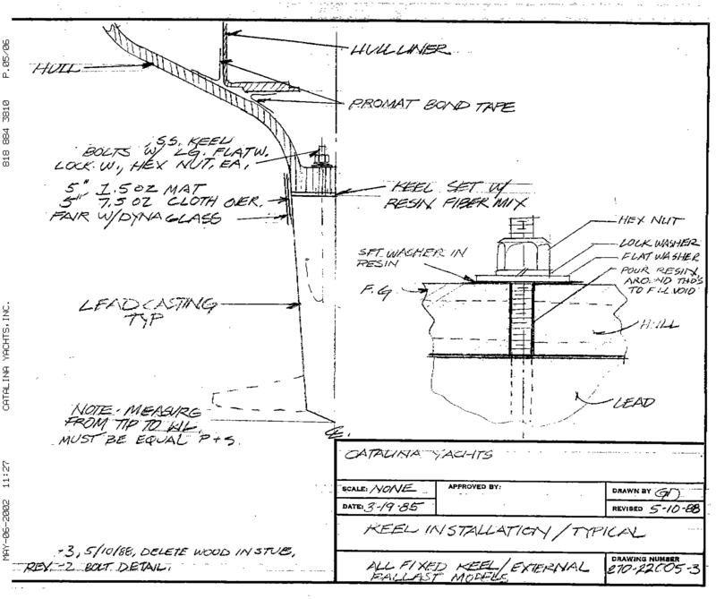

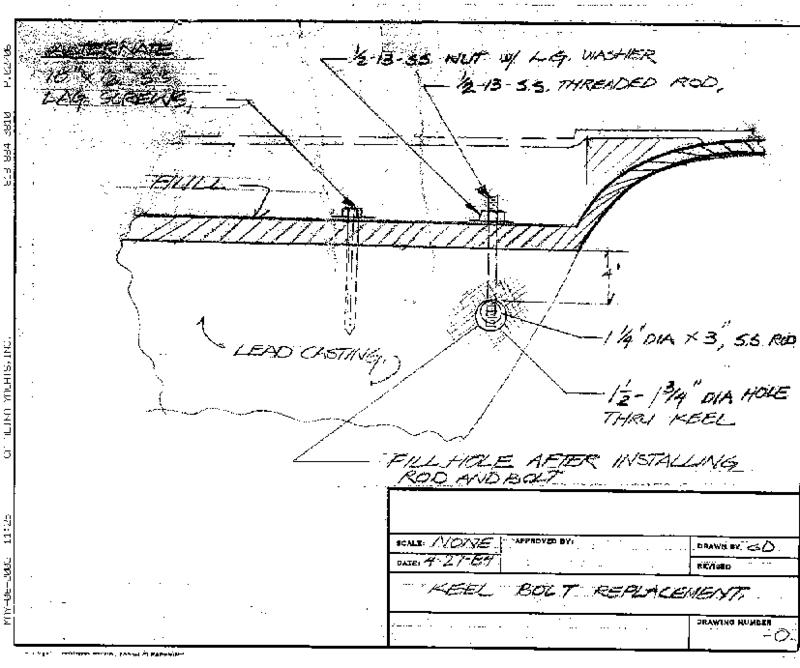

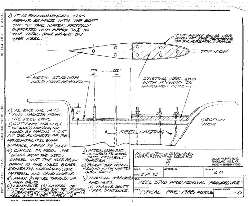

Anyone know why these keel bolts are in pvc pipe? They are about 3 inches high.
Thoughts about water heater. I know that gate valve isn't the best idea...

I suspect the tubes around the keel bolts were an attempt to keep them dry and hence corrosion free, but it's clearly not working !
On the subject of keel bolts, I've seen several torque values listed, and asked Catalina for the correct torque twice, with no reply. Anyone know the correct figure ? If it matters, my Cat 27 is an '84..
Thx..
Joe

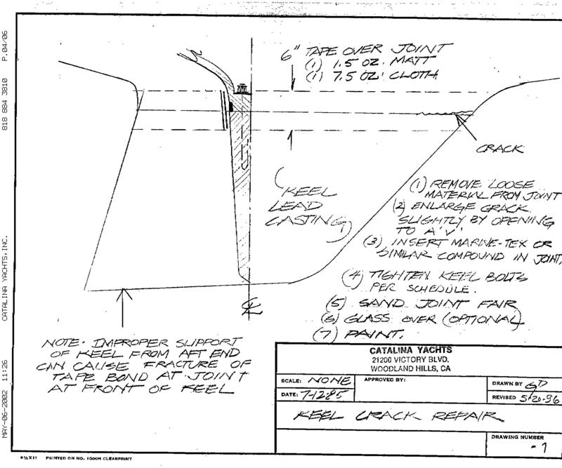

When I purchase my 77 C27 16 years ago I called Catalina Yachts customers service and they sent me a packet containing an owner's manual, parts list, etc. The also included a document that lists the most common upgrades and retrofits that owners had deemed necessary over the years.
Besides replacing the gate valve through hulls with properly seated bronze or marelon ball valve seacocks, there were a number of other items you should know about... Some of which are: retro fitting lower shroud deck connection with large backing plates (a kit is available thru Catalina Direct) to prevent distortion of deck. The original spreader bracket was aluminum and prone to cracking.... a stainless steel replacement is available from the factory parts dept. or Cat Direct.
There are other items... look for the list in the owner site or call factory customer service for a copy. Maybe you'll get lucky and someone will post it here... My stuff is at the boat....
Thx..
Try here. I might have something when I get home and find it. I thought I had it and the specs for the standing rigging
Jun 1, 2015
6
Catalina 27 Bradenton
Let me look when I get home, I swear I have it.

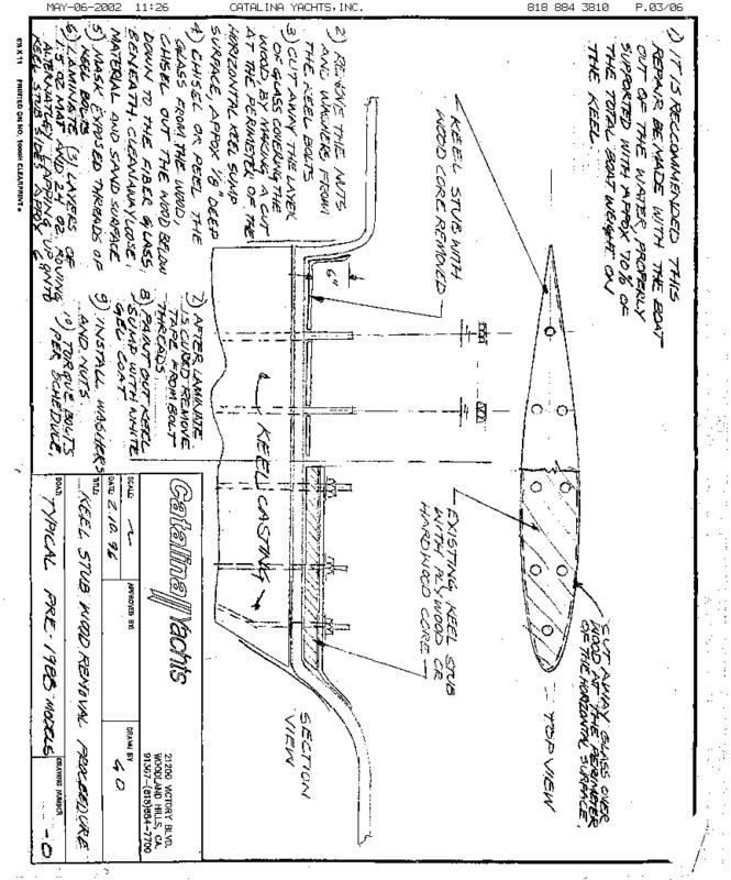

I can't find it. It was 50-60 lbs, I believe the stainless ones are 50lbs. On the older keels pre? 88 has the wood core stub plate so if you had water intrusion you may not be able to hold the torque or compress the damaged plate and move the keel around so be careful.
