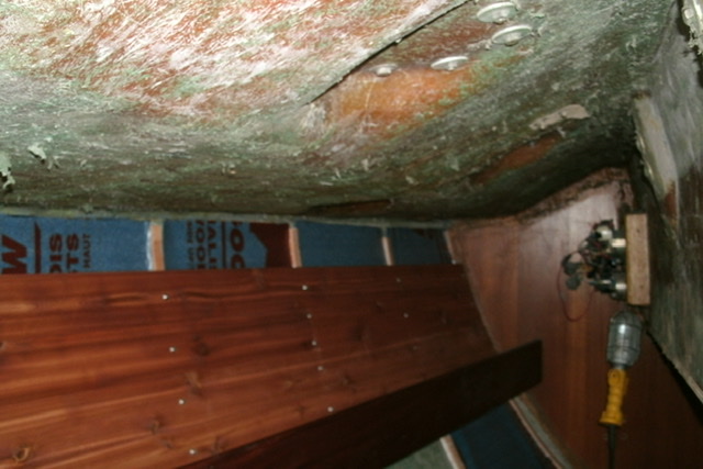

B8378B7D-5EFD-4926-9658-685F94C95DE1.jpeg Under construction in our First38s5. I used 1/4 in cedar t+g on 1/2 x3/4 in. battens.

That is pretty much exactly what I am thinking. Are you using epoxy to adhere the battens to the walls and ceiling or??? Looks like some type of rigid insulation behind the cedar?

Jesse , I used 5200 to glue the battens on.I put kerfs in but next time I think I will cut them into 1 or2 in. Length to glue on. Even with kerfs they had to be braced until the glue set. The insulation I used was a double layer of laminate floor underlay. Seems to work OK.

I figured they might have to be braced until the glue set. I am wondering if trying to scribe the battens to follow the boat contour might work. Maybe use 1x2's or something...

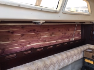

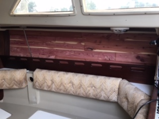

Tongue and groove 3/8 closet lining. I removed the old crappy panels. I used contact cement to adhere PVC 1"x 1/2" strips every 12 inches. I then used stainless steel staples to attach it to the strips. The cedar is good for its smell and its bug deterrent properties. When it stops smelling, I take some fine sand paper and give it a quick once over and it releases that beautiful cedar smell.
True, but 1x2 May cut a lot of interior space. Does give you a flat wall however. I’m not sure how curved your hull is and how much space you would lose doing that.
Looks nice Robert!!!
