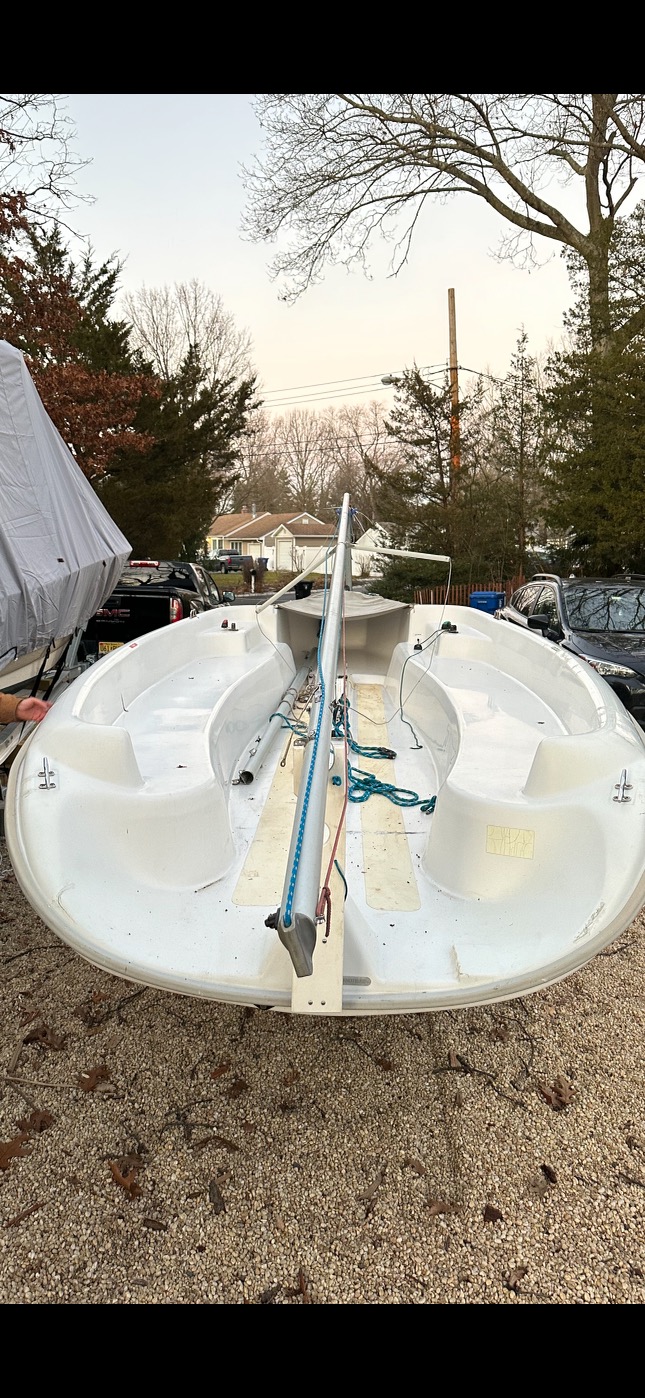

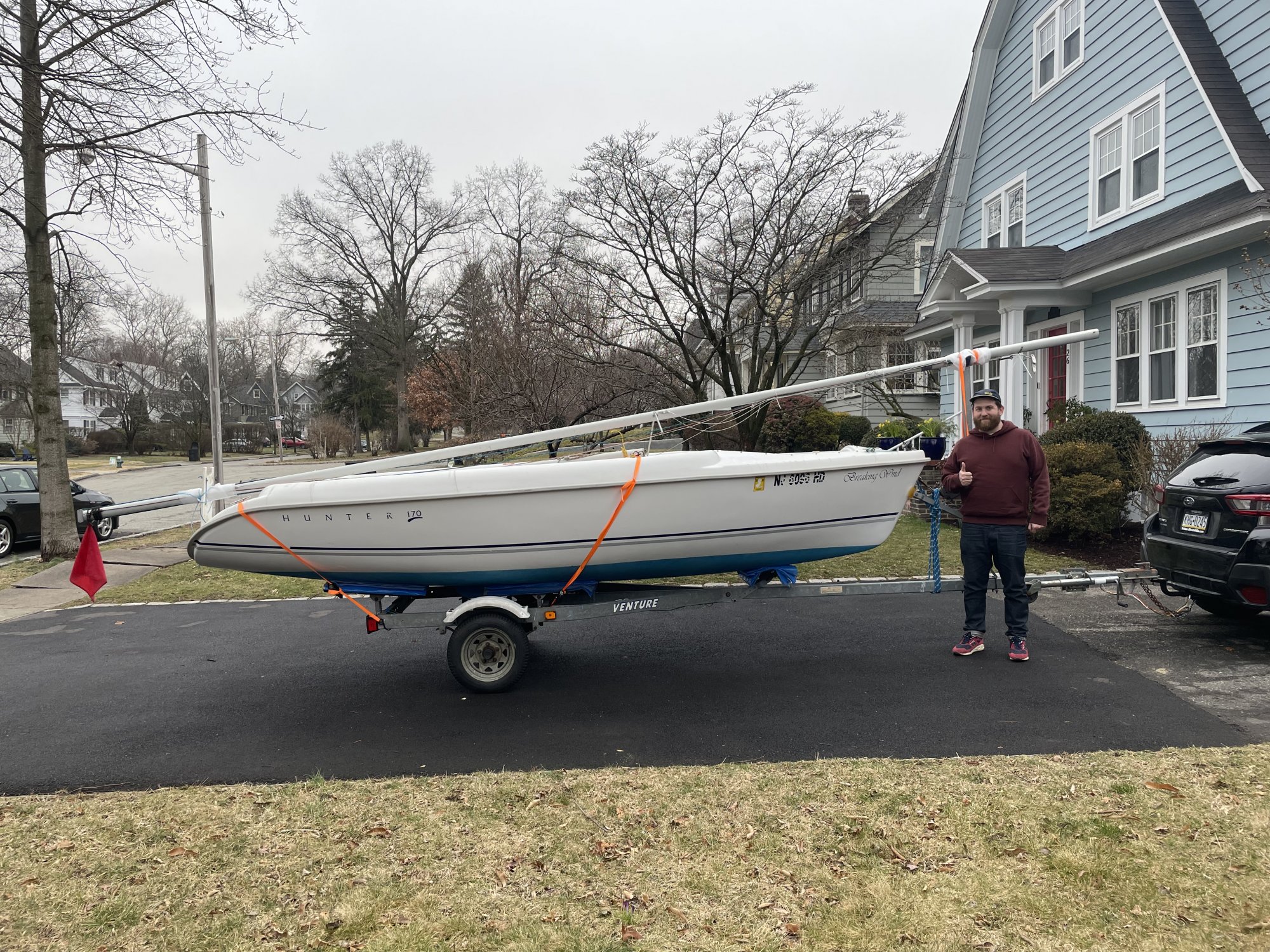

I just bought a 2005 170. I used to sail sunfish as a kid and was pretty good at it, but I'm a little overwhelmed at the thought of figuring out how to rig this boat for the first time lol. I downloaded the pdf with the manual and I've looked around on youtube, but I have yet to find a diagram or video that makes sense to me. I also grabbed US Sailing's "Learn Sailing Right", which I'm in the process of reading.
I have the boat trailered at a storage compound about 15 minutes from the lake, but I'm on the waitlist, hoping to get a dry dock spot at the lake itself, where I can keep the boat trailered with the mast up and sails attached.
Anyone have any recommendations on info/getting started?

I used to own a 170 and loved that little boat. We decided to get something less "tippy" for the grandkids.
I did several videos, one of which details the stepping of the mast.
Mast-stepping video
Other videos
I can't tell from the picture, but something I took for granted was these quick-release shroud levers. They allow you to get the mast upright, then apply tension to the shrouds. Another 170 owner on this forum was having a heck of a time getting his mast stepped, and when I realized his boat was not equipped with them, I knew they would be the solution to his problem.
You mention that you plan to keep it in dry storage eventually, in which case the quick-release levers will not be used much, but until then I think you will find the $150 price tag well worth it.
Feel free to PM me if you have any questions, and enjoy!

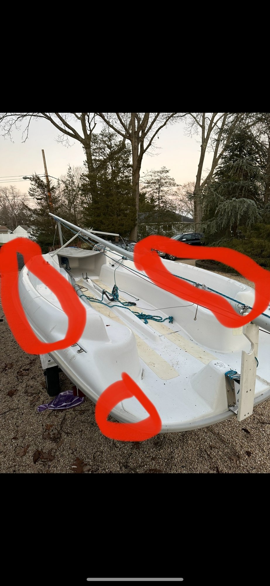

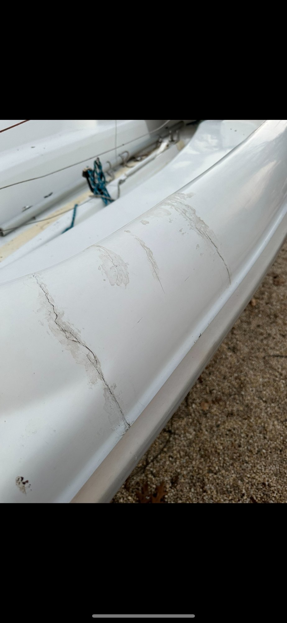

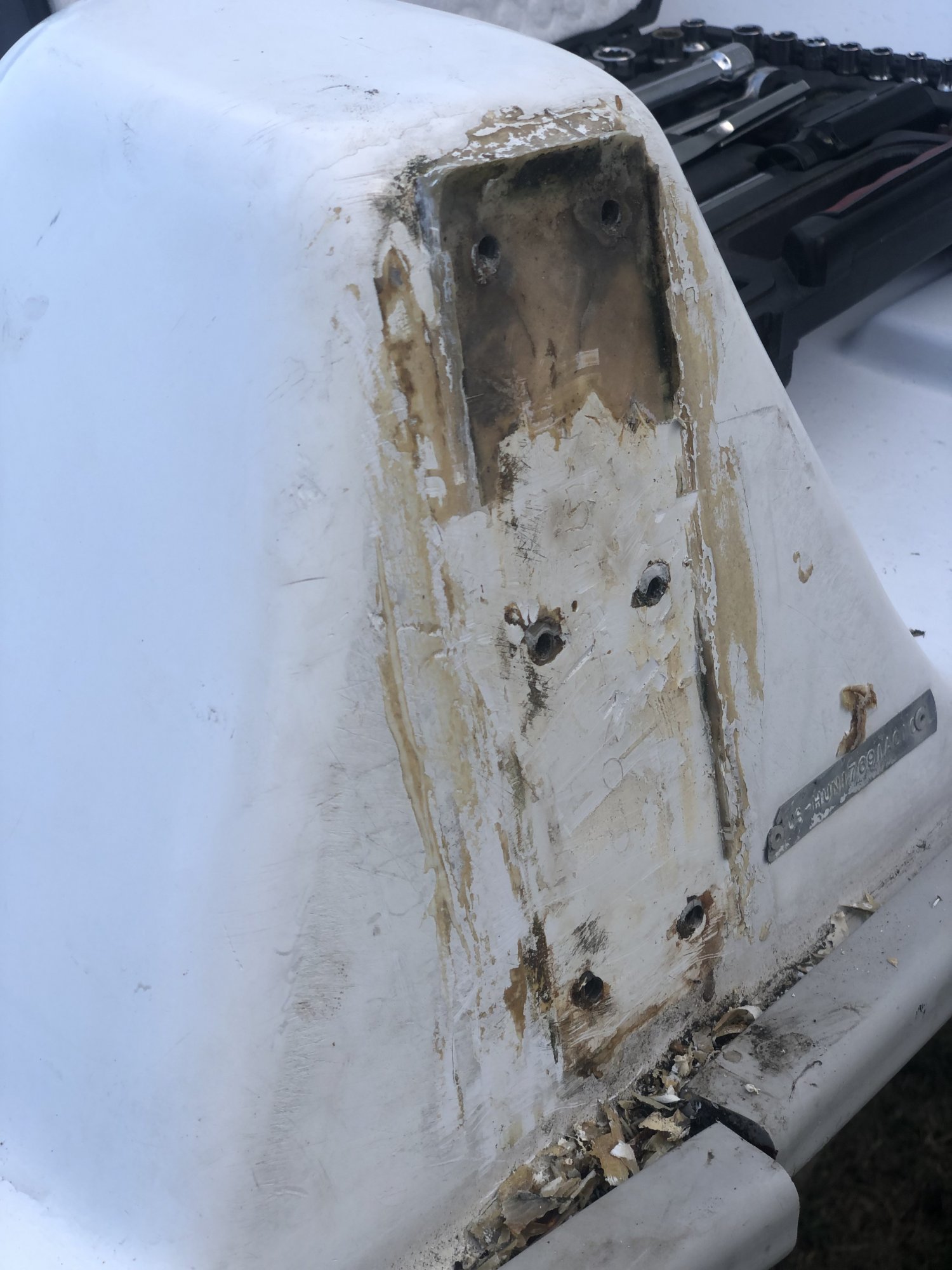

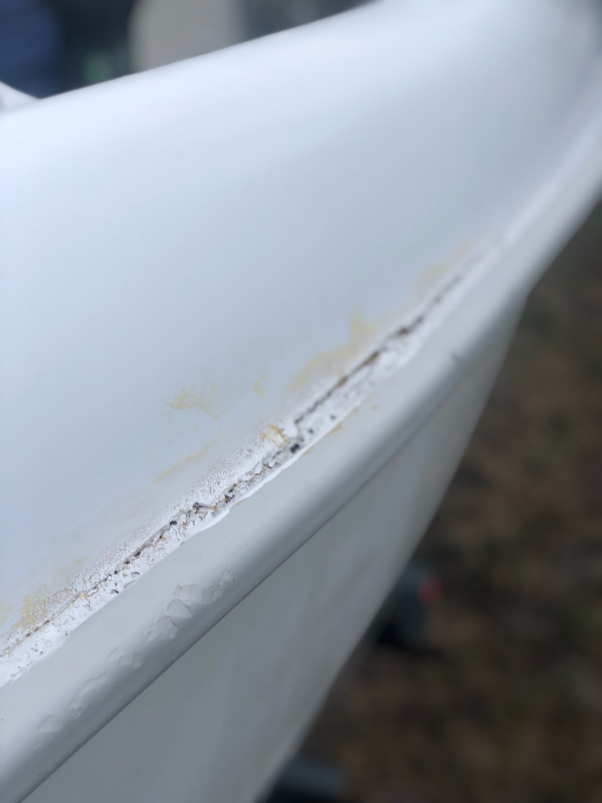

There is definitely some cracking on the boat, which I plan to address eventually, but it doesn't seem to be critical right away. I'm attaching some pics of the problem areas.

Typical of H170's of this vintage. The hull is Luran plastic and does not bond with fiberglass, epoxy, or other such adhesives. A Google search for "hunter 170 cracks luran" will reveal a deluge of discussion on this topic. Bottom line: It's fixable with Plexus adhesive, properly applied.

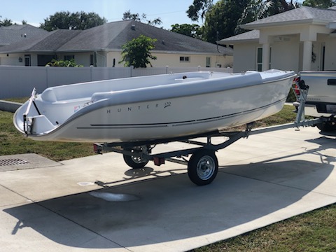

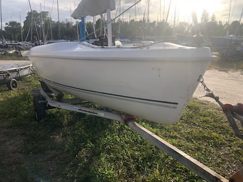

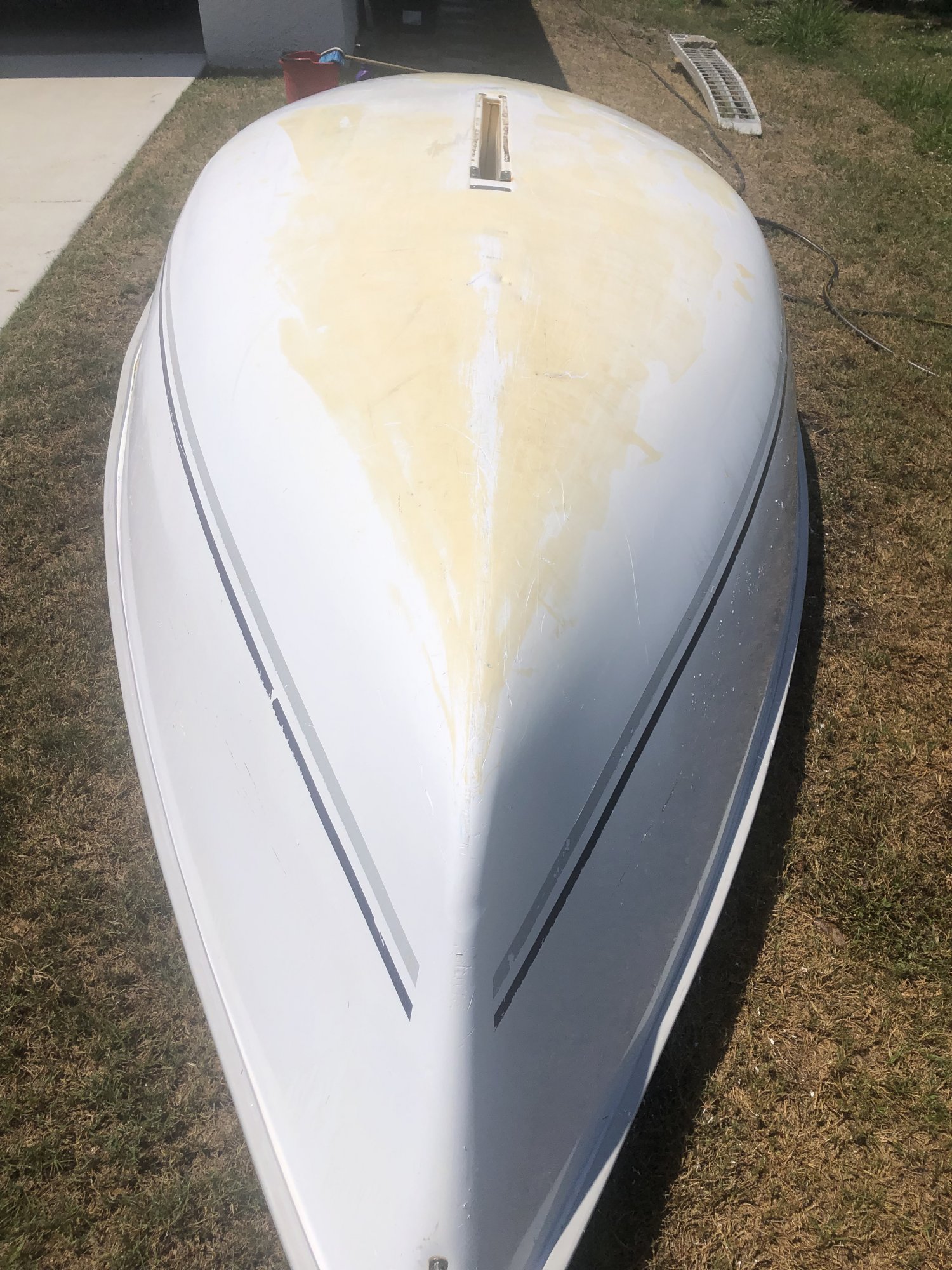

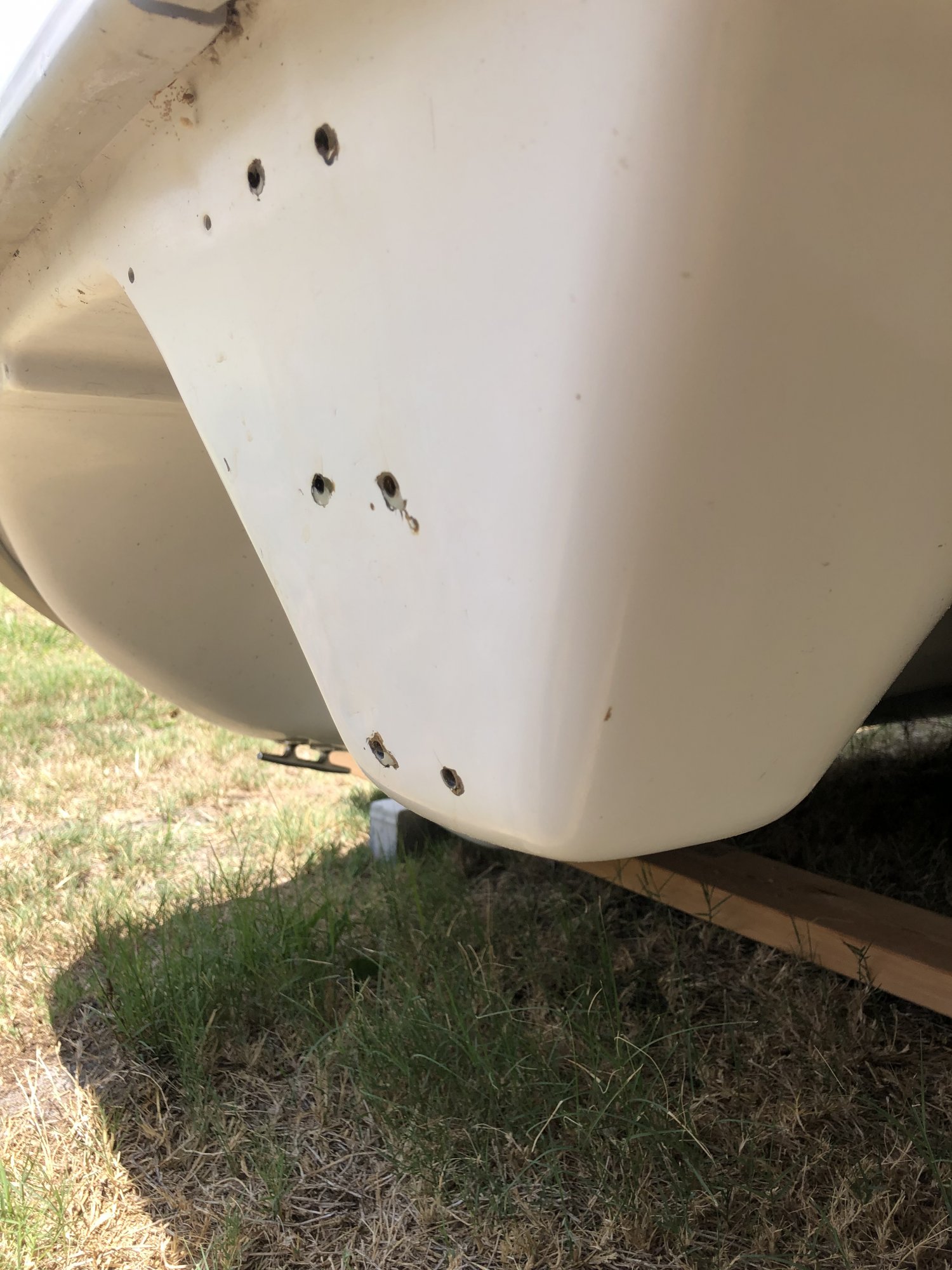

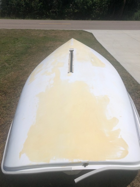

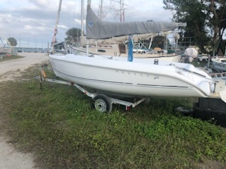

Welcome @rsmithfh, purchased my H170 back in November 2022. Currently in a rehab state.

SKOTBRO,

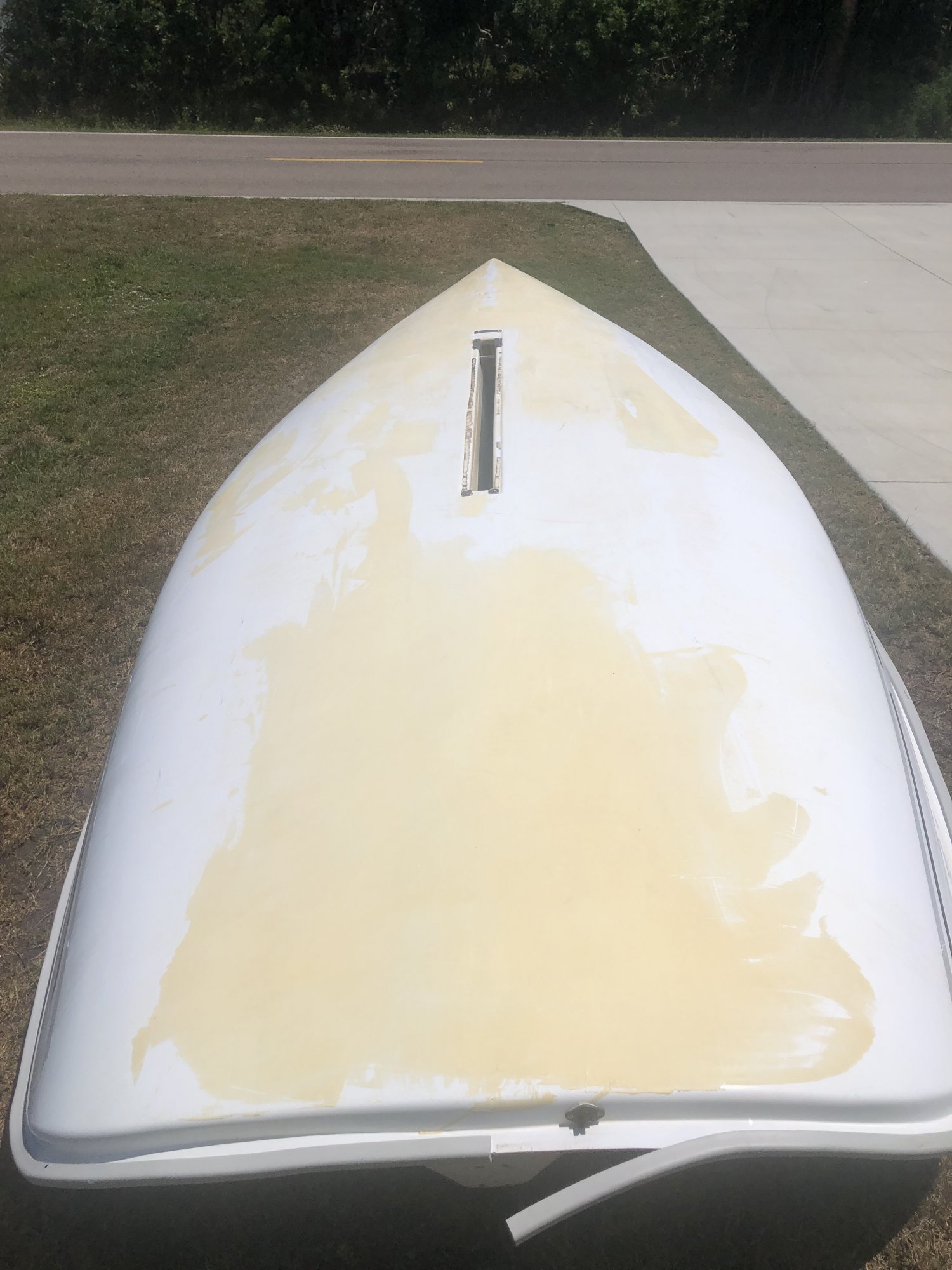

It's apparent from the photos of the bottom that this boat has been beached a lot, which is really no problem in itself. If you feel inclined to paint the bottom, be sure to select a paint that adheres to plastic (i.e. Krylon spray paint). I did this with my boat after filling some scratches in the bottom. I can't say I would do it again, as it was difficult to get it as smooth as I wanted due to the tendency of the overspray to dry a bit on the rough side. Perhaps results would have been better if applied in a sheltered area?

It's not as bad as it looks, not sure what the previous owner did here, I'm thinking it was still on the trailer when applied as it's not thick and sands off easily in most places. I have read all the forums and watched your videos over and over so I have built up the confidence needed to tackle this project, LOL. I have also practiced sanding and buffing the surfaces down to a smooth finish and plan to practice and experiment using all the advice gathered from these forms and youtube videos... Thank you all for that.

Oh, I see. I was assuming that the outer finish had worn off exposing the underlying layer.
If you do decide to paint, my advice would be to stop at the boot stripe if the finish above the waterline is still good. Ultimately I was successful, but had to resort to applying clear coat.

so the clear coat adhered fine to the plastic paint with no issues? Were you able to buff it smooth after?
Apr 11, 2020
792
MacGregor 26s Scott's Landing, Grapevine TX
For the product I used (which I can't recall the name of, sorry) there were less issues with the clearcoat
overspray drying rough than with the paint.
I applied 2 coats of white paint, wet sanded, and applied the clearcoat. Even with the "does not yellow" promise, I noticed slight inconsistencies in the evenness of the final application.
Honestly, if I had it to do over, I would have just filled the scratches and left it at that.

As a former 170 owner I agree with adding the masthead float. You can find one made for Hobie cats. IMHO it is an unstable boat, due to its round chines and top-heavy design. Without masthead flotation it will turn turtle if it goes over and is not righted immediately. Do not leave it on a mooring in a storm (done that, got the medal).
Also, I would fill those cracks before taking it sailing, as it’s not good to waterlog the inside of hull.

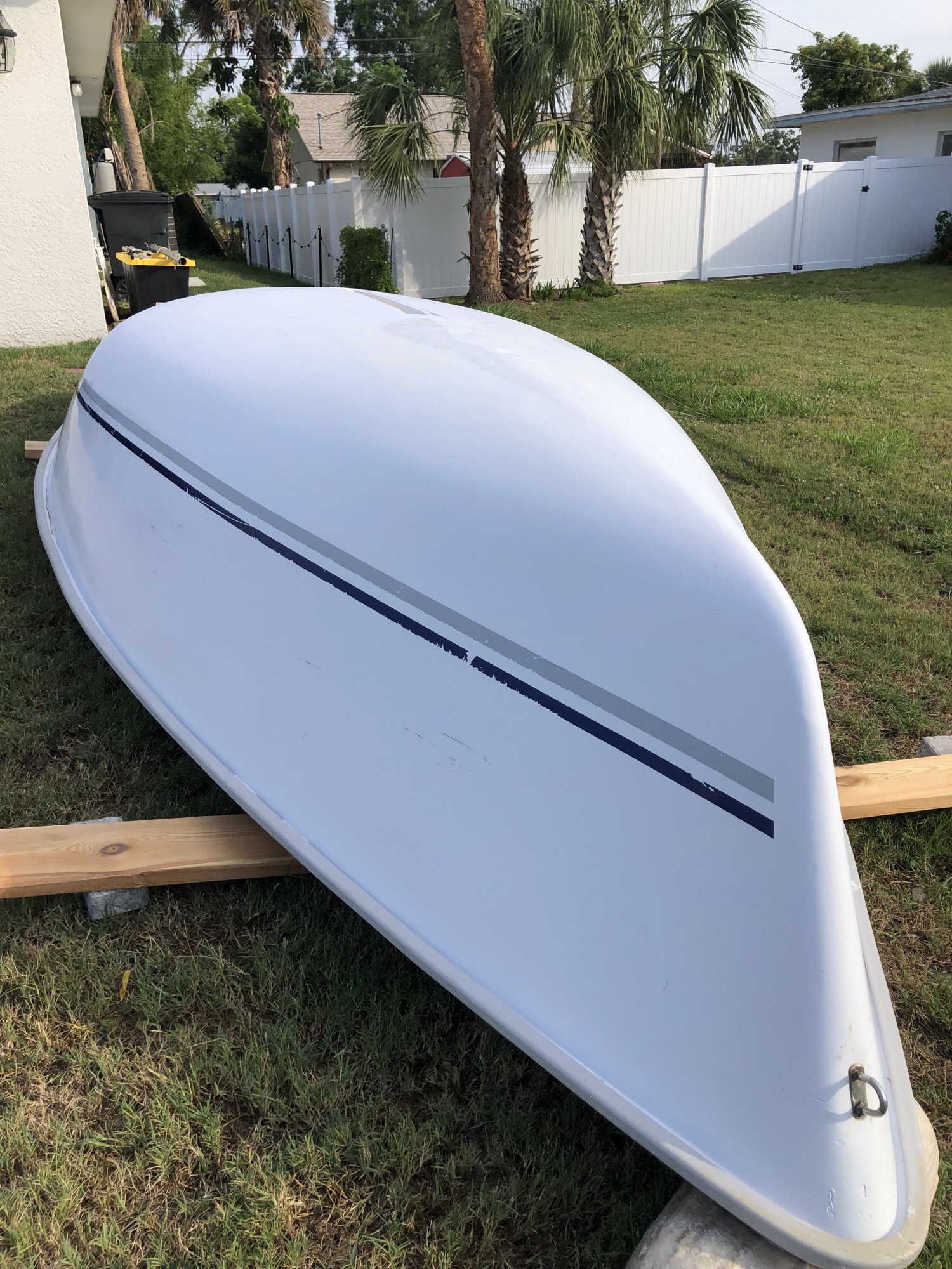

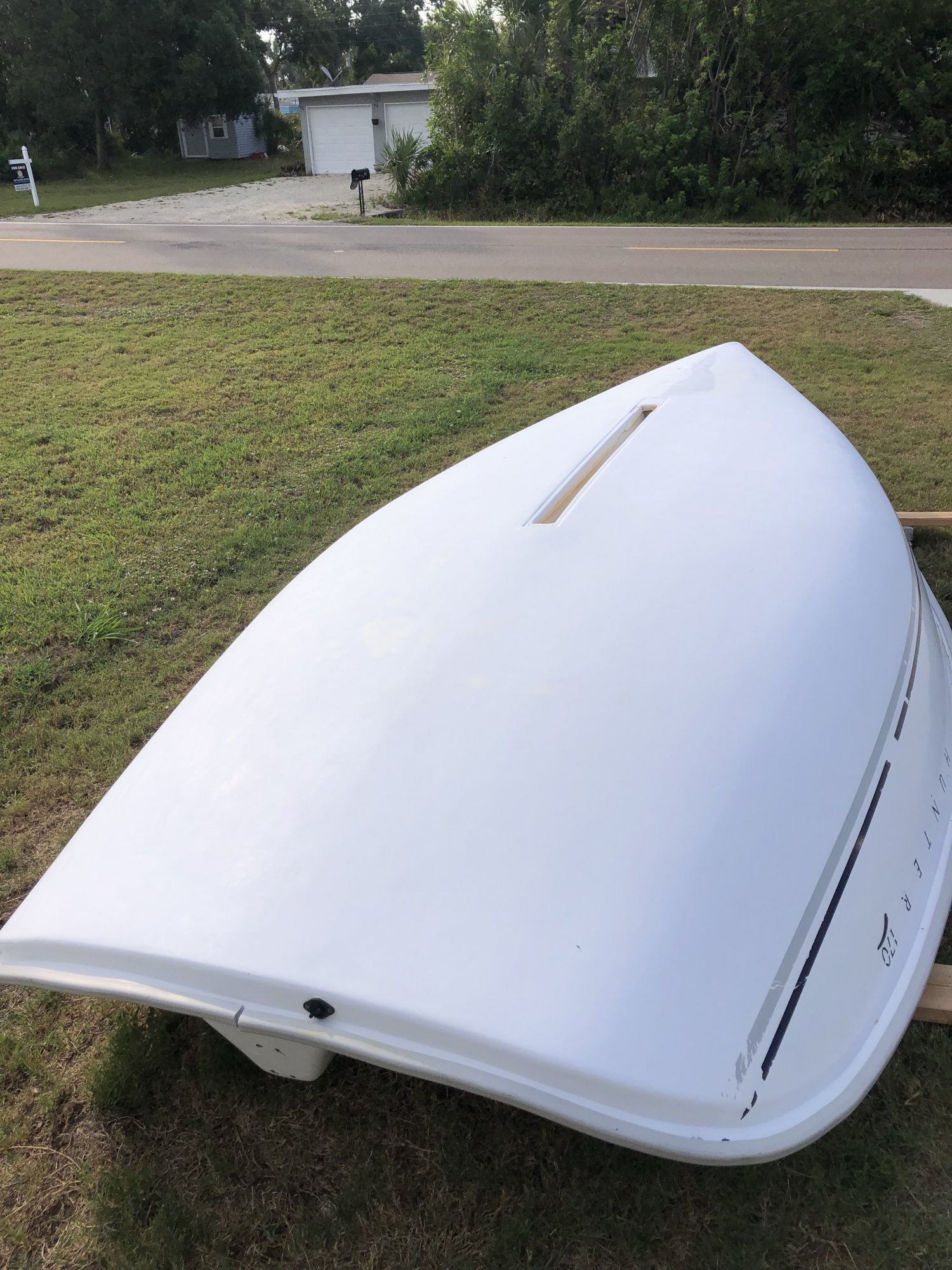

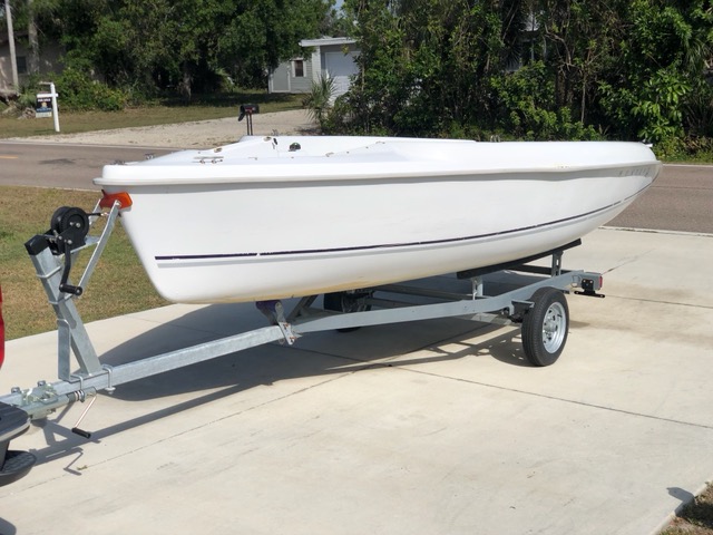

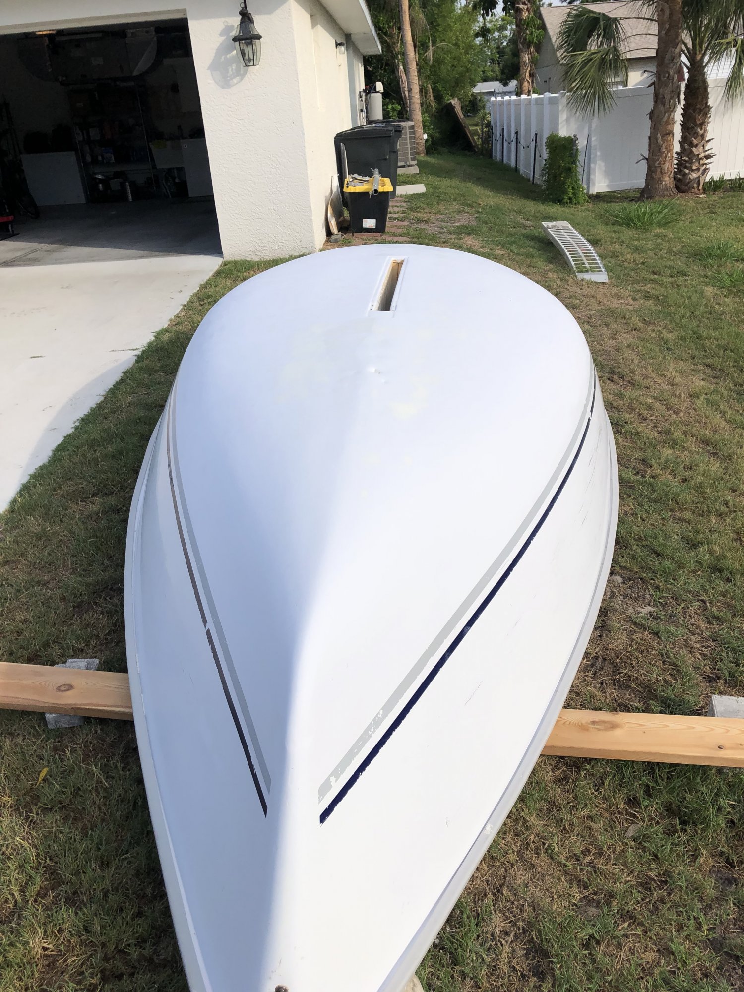

I was able to do some sanding the last couple of weeks, turned out great so far. I was able to remove the thick layer of random epoxy/plexus or whatever it was. The pictures are after 320 wet and dry sand. will take it up to 4000 and then a dry wool pad on a speed wheel. I did the same on the transom for a smooth polished finish with no painting.
Does anyone know where I can get an Identical match for a new HIN Tag?

Looking much better, good work.
Definitely put in the extra work necessary to get the hull just as smooth as possible.
I don't think you will have much luck replacing the HIN tag.
