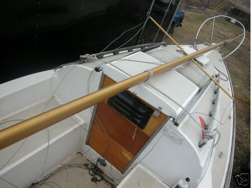

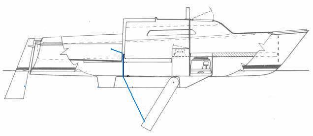

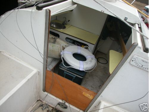

I found a picture of a 1974 (but might be '75?) 20 showing the location of the CB control line. It is possible that the CB trunk is clogged up with dirt and/or slime/scum/icky stuff and that is stopping the CB from dropping easily. Running a thin strip of metal back and forth between the CB and the inside of the trunk (housing) may free it. You could also CAREFULLY aim a stream of high pressure water up in there, but be careful not to use too much pressure (and obviously, watch out while doing any of this as the CB may suddenly drop).

I do have another question about the keel. Looking at the drawing I don't see any type of locking mechanism. Is there one or is it just held in place by its own weight?

The CENTERBOARD is free to pivot up if you hit bottom, as mentioned above the line is used to pull it up as well as hold it from dropping more than you need. This boat is a Keel/Centerboard boat and does not depend on the CB for stability (that is preventing heeling / tipping) but only for leeway prevention and to improve steering control. All of the ballast is inside the shallow, fixed-keel. Adjusting the CB up and down also helps to adjust the balance of the effects of the sails on directional control, lowering CB will reduce Lee-Helm (tendancy of boat to turn the bow away from the wind) and raising hte CB will reduce Weather-Helm (tendency of boat to turn the bow into the wind). There are, of course limits to those adjustments, and normally you want to have just a bit of weather-helm for safety. If you sail in higher winds using just the Mainsail, raise the CB partway to move the balance of the helm aft to reduce the increased weather helm, experiment with these settings as you sail to "dial in" the best feel.
