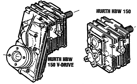

For Yanmar transmissions, they recommend pretty strongly that when sailing you leave your transmission in reverse. This is because when the engine is not running there is no lubrication going to the thrust bearing. The Universal Mx-25 XPB uses a Hurst HBW 150 transmission that has lubrication at the thrust bearing all the time. Here is a section out of the Hurst HBW 150 manual that speaks specifically to this issue.
[FONT=&quot][/FONT]When under Sail or Being Towed
Rotation of the propeller without load such as when the boat is being sailed, being towed, or anchored in a river, as well as operation of the engine with the propeller stopped (for charging the battery), will have no detrimental effects on the transmission.
That being said, most of the time I leave mine in reverse when sailing as it is just a little quieter. Occasionally, if I am racing I will leave the transmission in reverse, but there was a lonnnngggg thread in the Ask All Sailors forum about the benefits, and I believe it was determined that it caused more drag to have the prop spin, especially if you have a 3 bladed prop like I do.

I'm not sure what you're trying to say, Witzend. The clutch is the assembly (in the transmission) that engages and disengages the prop shaft from rotating whenever we operate the shift lever. Our props are not direct drive...the transmission gets in the way of that. In fact, if I remember right they're even geared down 2:1.
"If it doesn't turn it won't wear" is exactly my point and thus one good reason to keep the transmission engaged while sailing- less drag is another good reason.

So you're saying that the lever to engage the transmission operates a clutch and engages it in gear as well. Don't know why there would be a need for a clutch, just synchronizers to get it gear, were not driving a wheel on a stationary surface. Do you have an exploded view of the Hurst HBW 150?
I improperly used to term "Direct Drive". When I indicated direct drive I did not mean there was not a gear set involved.
My point here is common sense tell me that forward or reverse it will not turn the prop @ 6 knots.

I'm talking about a clutch in it's most generic term. Not necessarily one that works by way of friction as you would find in a manual automobile tranny.
Here is a link to a view that is difficult to read:
http://www.marinedieseldirect.com/c...&title=BELL HOUSING AND TRANSMISSION&size=800
I agree completely that there is no way that 6 knots through the water will turn over the engine. I didn't realize that anyone thought it would. But many transmissions state specifically to use reverse and not forward. And I'm assuming the reason is to keep the load on all the parts going in the same direction as if the engine was driving the movement.

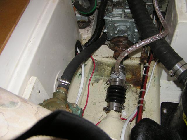

After doing some reading on the HBW-50 if I was to do something, I would put in a flex coupler like Ray did.
How long do you think the HBW-50 transmission should last of course taking resonable care.........

Where are all the wires and hoses? On my C310 to even see the coupling you have to be a contortionist. So, we have the HB-50 not 150? Not sure life expectancy. Great link for tech tips, thanks.
